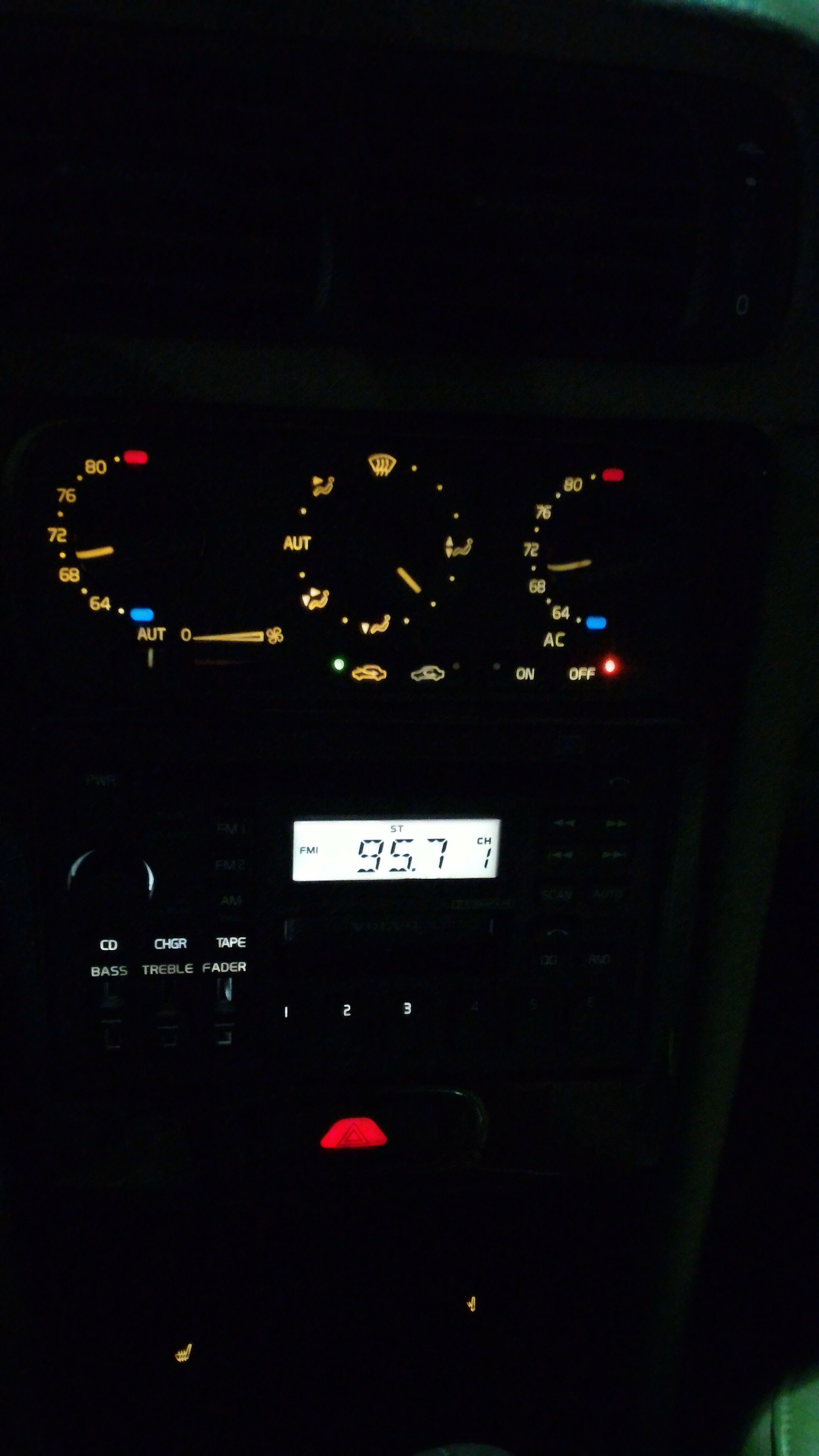

So quick story, I was driving the other day hauling skis. I had to slam on the breaks, resulting in the skis flying forward and slamming into the stereo. Everything seemed good. Last night I went out for a drive, turned my lights on, and noticed the entire right side of the stereo and climate control illumination was out. Hit it in a few places and got the climate control to light back up, but most of the stereo is still out (pic).
I believe the lighting went out once before, hit a bump and it came back on. So I'm assuming there is a loose connection somewhere. Tried to do a search for this, but all I turned up was replacing bulbs. I don't think I killed the bulbs in the incident, but maybe. I find it curios that power on the left and right sides would be separate. I have not pulled the stereo yet, as I was unsure of how temperamental the anti-theft system was. Any tips on where to hit it
or what to look for?

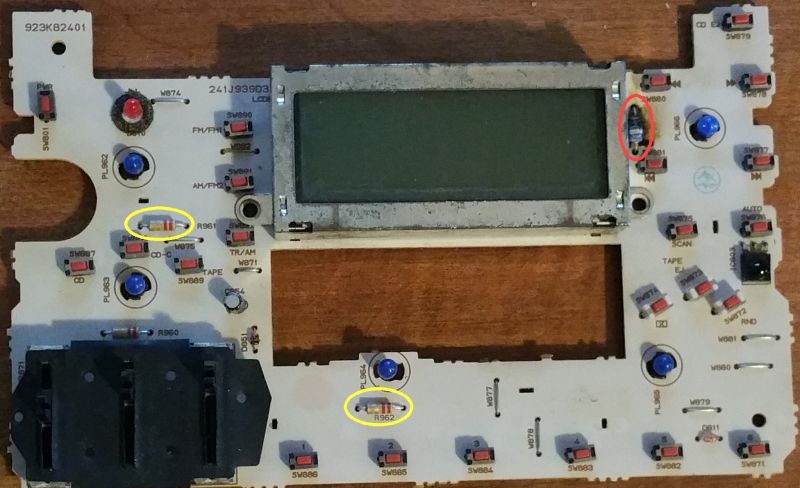

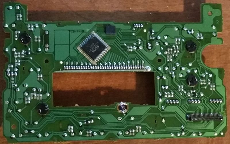

You might have cracked the circuit board, or broken a couple of bulbs. There are 3 - 2.2Ohm resistors that supply power to 1 or 2 bulbs each. The resistor on the upper right got burnt up. Best to check the bulbs with a multimeter, should be under 20 ohms each.
You'll have to check the back of the PCB to see if you have a cracked circuit board. It can be fixed, but it isn't that easy.

It's a very easy repair unless the board cracked. If it did, I would suggest running jumper wires to allow for flex in that area again...
