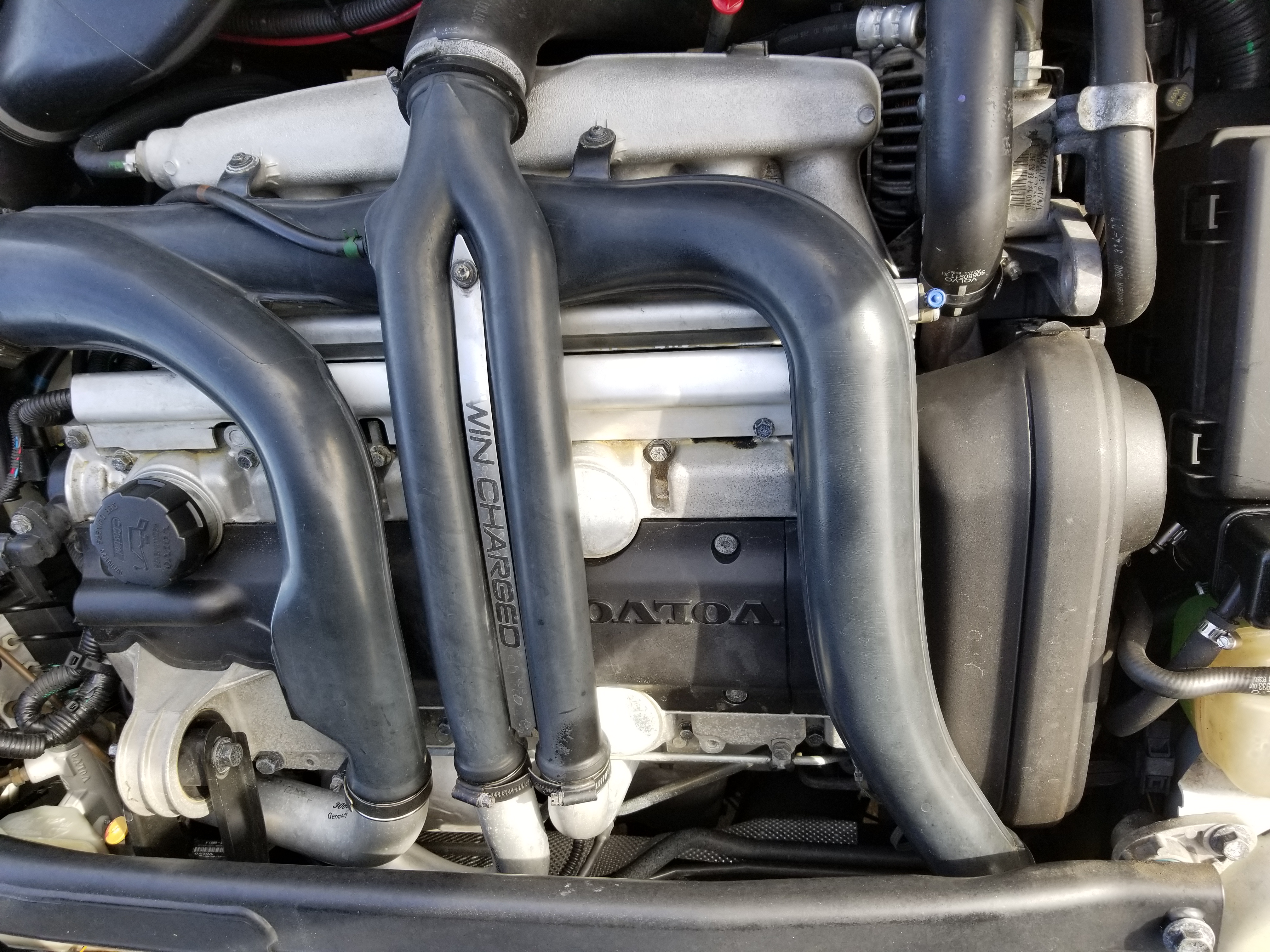

The T6 also has both plugged with the cap towards the rear of the engine. Maybe that moved the oil cap because the twin turbochargers have piping covering those plugged holes partially. Here is my T6 which is a 2004. Junebmdubya1198 wrote: 30 Jan 2018, 14:59Now that I look at a B6304 (960/S/V90) again, the oil cap is actually mounted in the same fashion as the B52XXX. Now I really don't know why it's there...RickHaleParker wrote: 30 Jan 2018, 00:38 Question 1 : Not in use on any Volvo whether LHD or RHD. The only difference in the engine bay b/w LHD and RHD in a 2000 model is the location of braking and clutch systems.

Interesting they did it like that on the T6 too. The reason they placed the cap there on the T6 is pretty obvious though (or is it?), like you said with the intercooler piping.
That is one ugly intake manifold though... I've never liked it.
