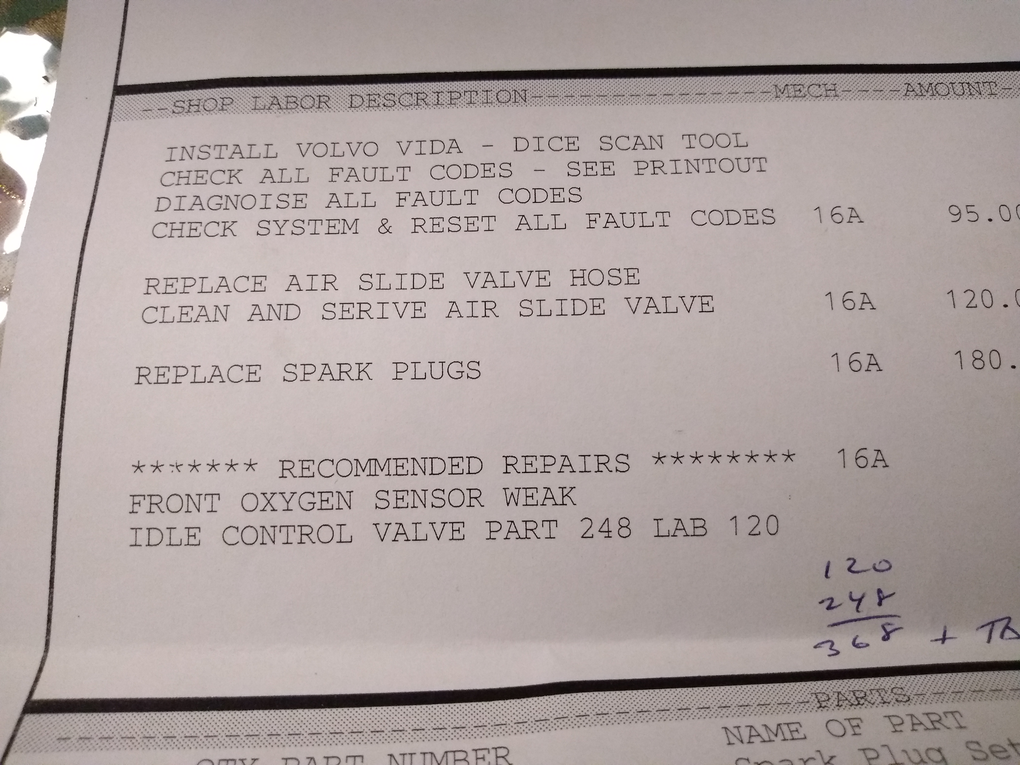

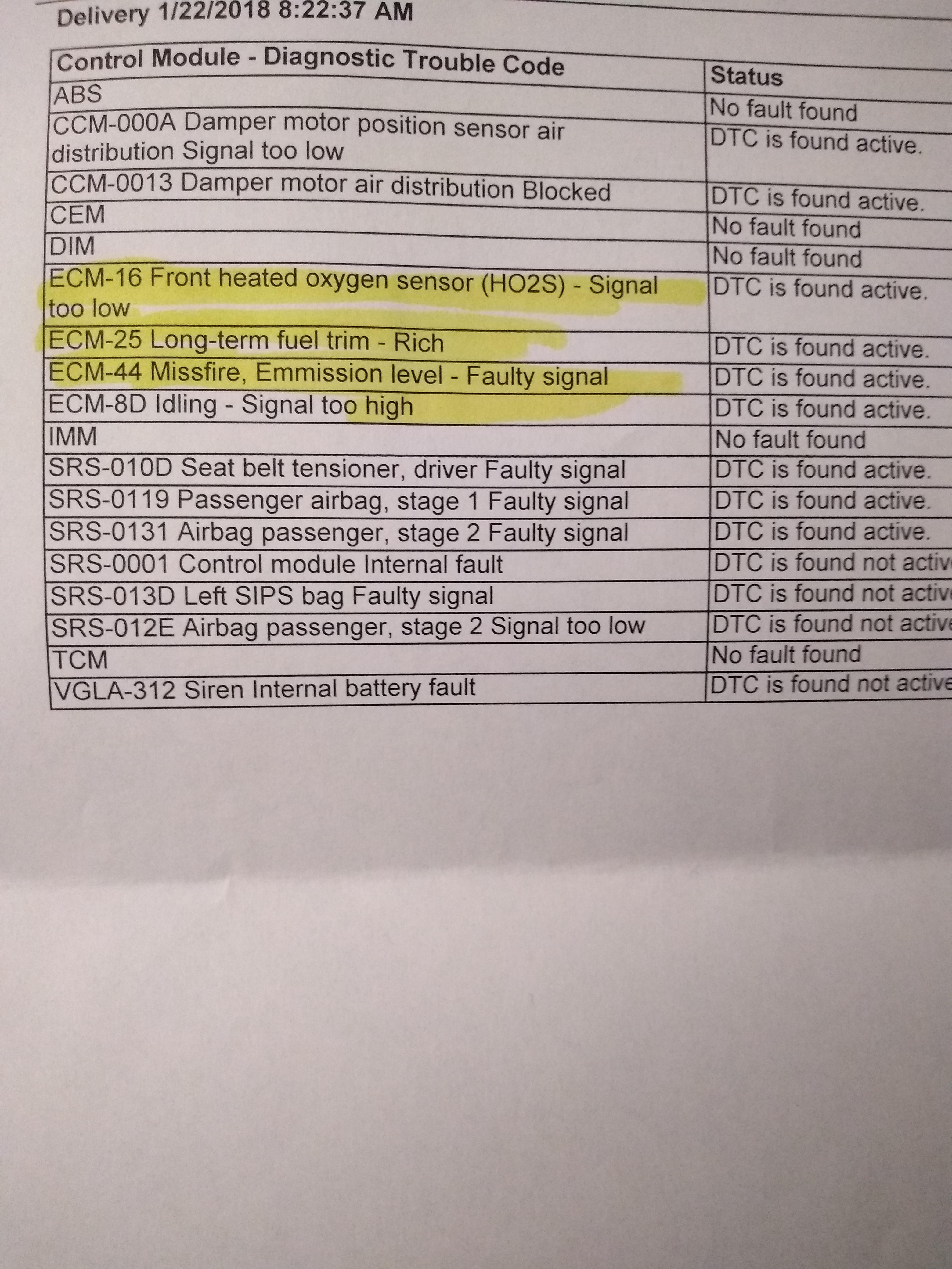

He gave me a paper with codes because he diagnosed it too.
Post the codes off that paper, or did you mean he showed you the paper?
Ivano2937
Posts: 7
Joined: 30 January 2018
Year and Model: 2004
Location: Los angeles
Has thanked: 2 times
Post by Ivano2937 »
RickHaleParker wrote: 31 Jan 2018, 15:53 He gave me a paper with codes because he diagnosed it too.
This is what he gave me.
Hope this makes more sense.
Thank you for helping me out.
