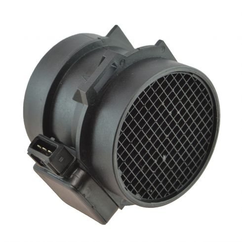

I took my car to get a tune up recently and the mechanic said it needs the O2 sensor and maf replaced.
The MAF sensor alone could make quite a difference and it is easy to change out.
Try disconnecting the MAF wiring harness and see if the enigine starts better.
2004 Volvo V40 Mass Air Flow Sensor with Housing (MAF)
