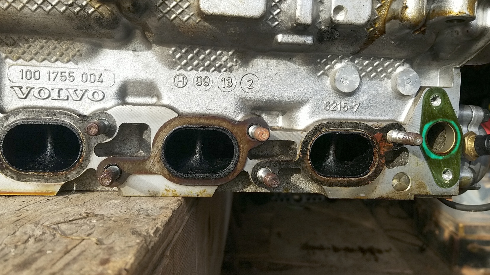

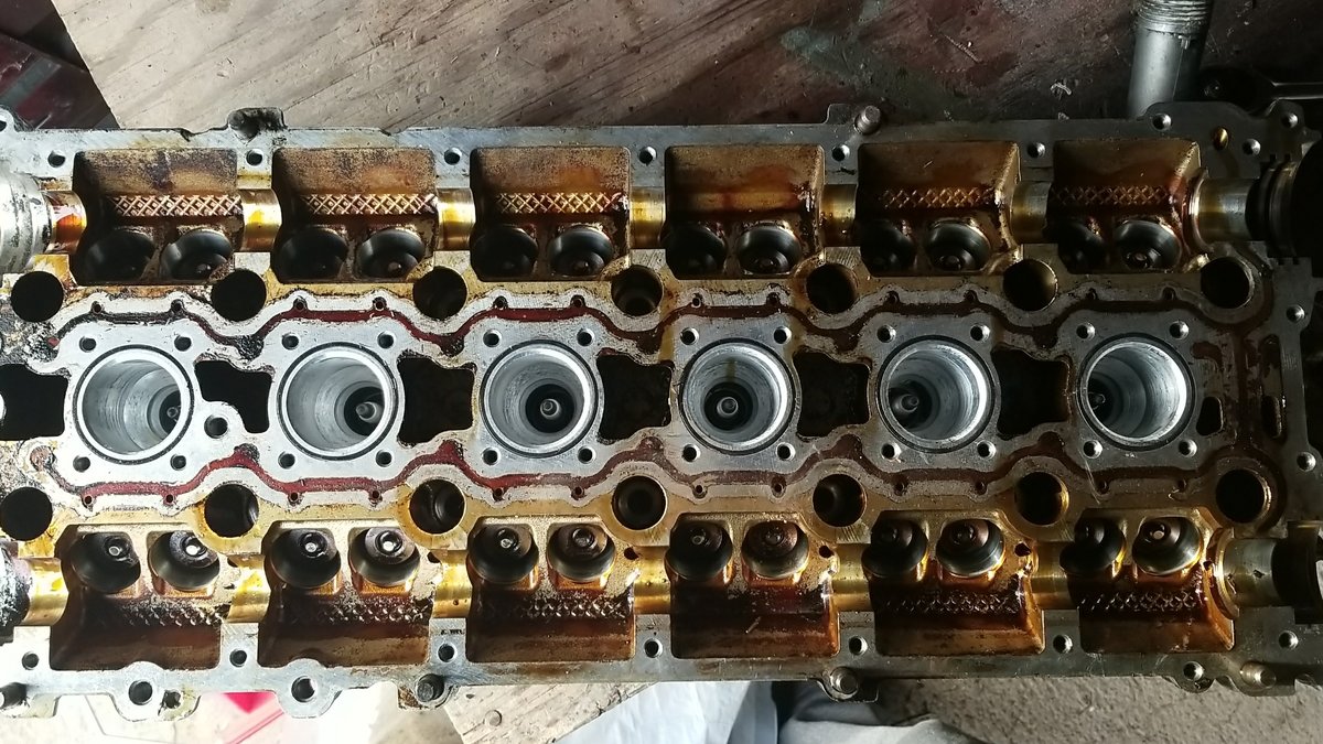

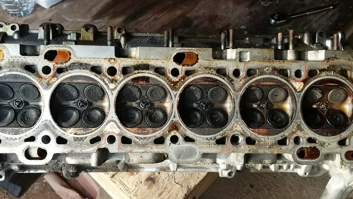

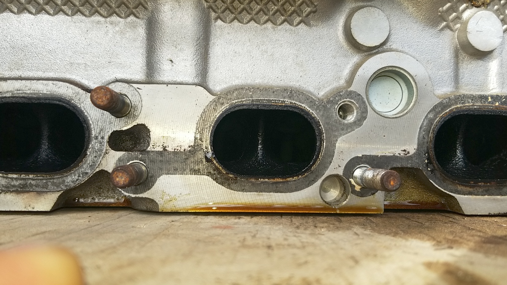

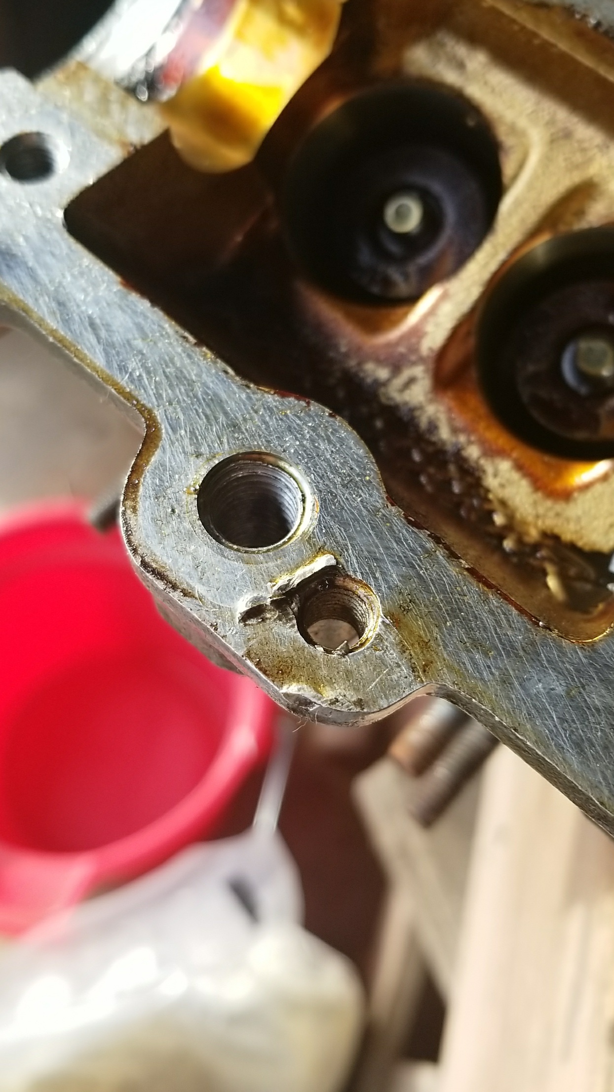

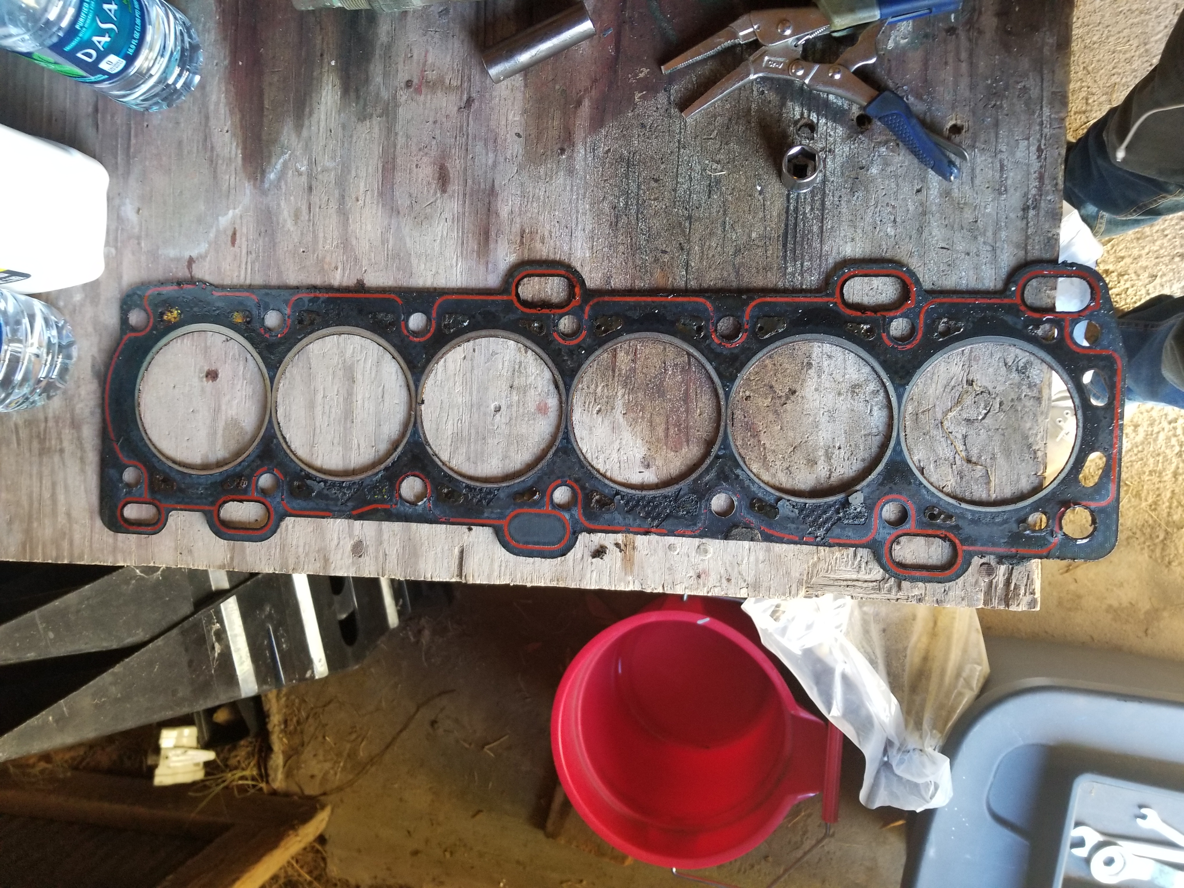

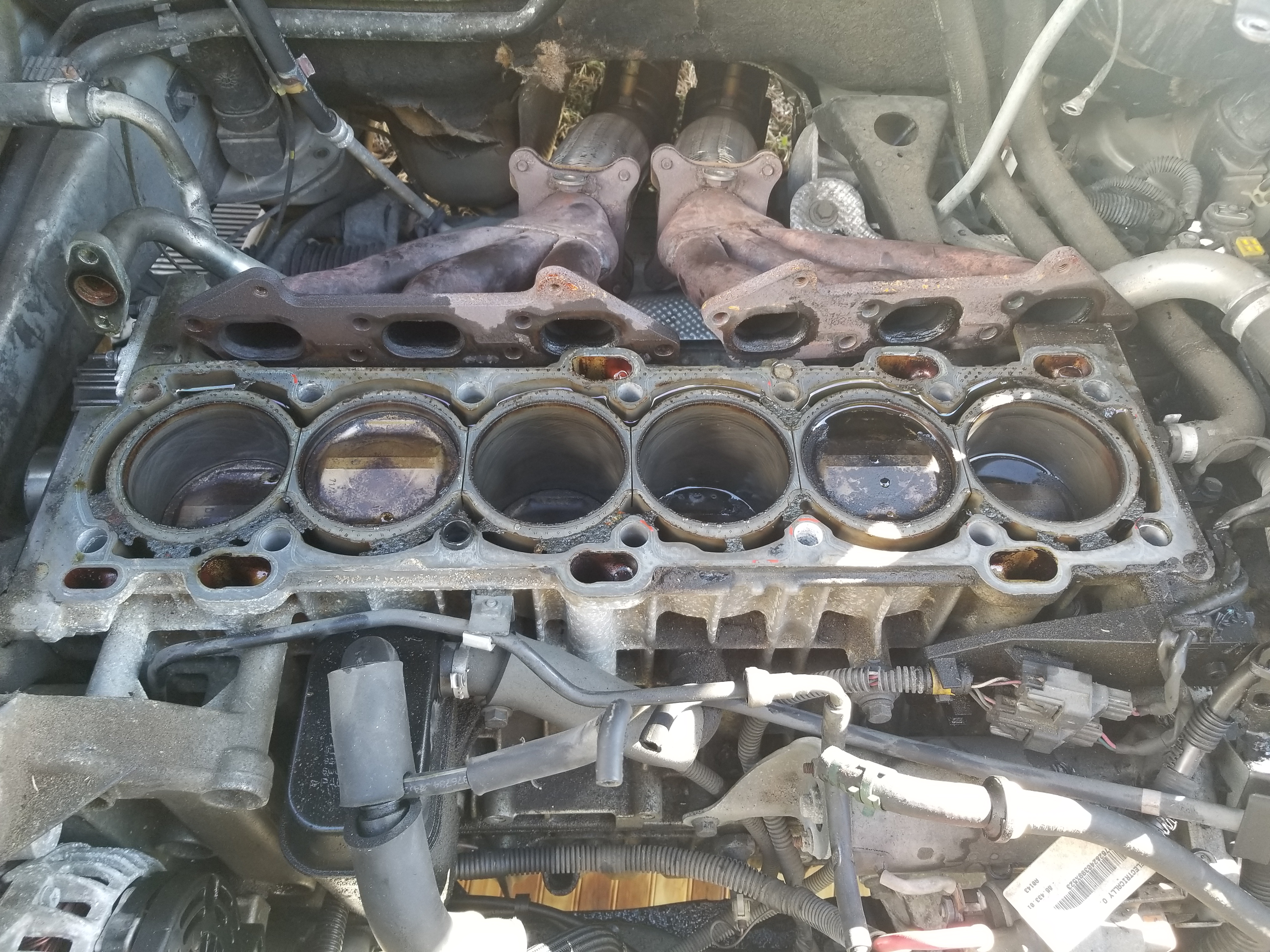

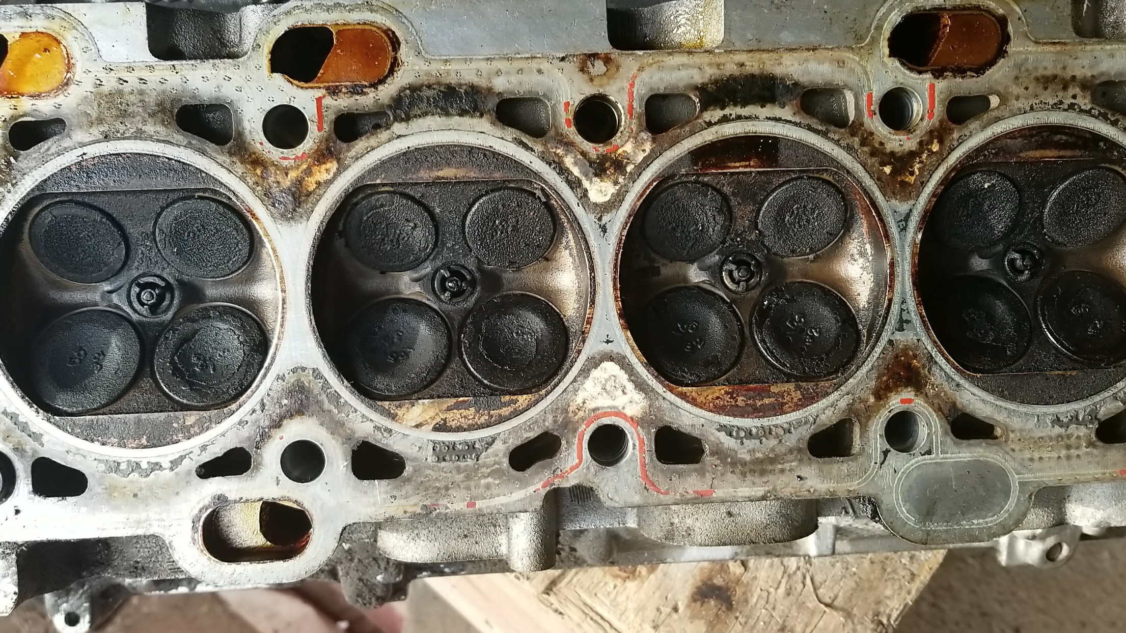

Fast forward a bit, I've torn the engine down to the cylinders expecting to see a blown head gasket and if it wasn't it needed to be takin apart anyways since the engine was burning something it wasn't supposed to. Unfortunately, as far as I can tell, there isn't a blown head gasket (though I am somewhat of a novice in the field of auto repair/machinery so I wouldn't trust my opinion which is why I'm here). I have a few photos I'll post below that might help with diagnosing this issue and I have a high-end camera if anyone needs me to take any more of ANYTHING else. I did notice that there is some weird gunk that is sitting on the very top of the coolant passages which I did find odd, but not to sure what it was or if it was normal or not.

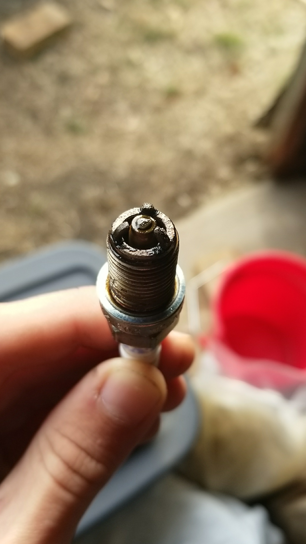

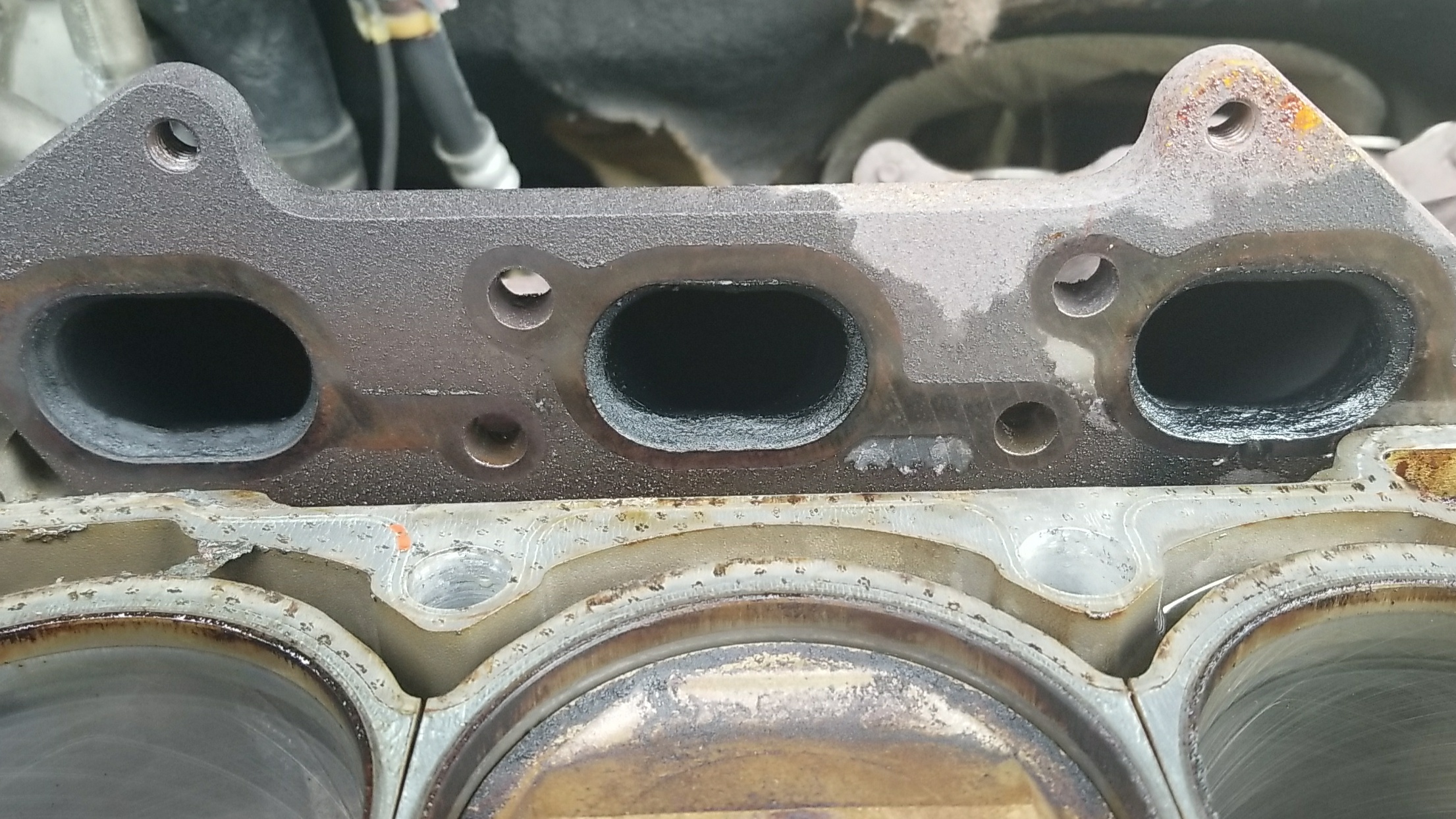

Lets see the other side of the head gasket, top, bottom and exhaust ports of head, plugs.

You missed the back side of the head gasket. However I'm not seeing any evidence of blown head gasket. I think you jumped the gun by pulling the head off. You did missed the opportunity to gather some diagnostic information.
Looks like you wedged the cam cover off by wedging at one point only. If you ever do this again, a little bit at a time, at points the length of the cover.

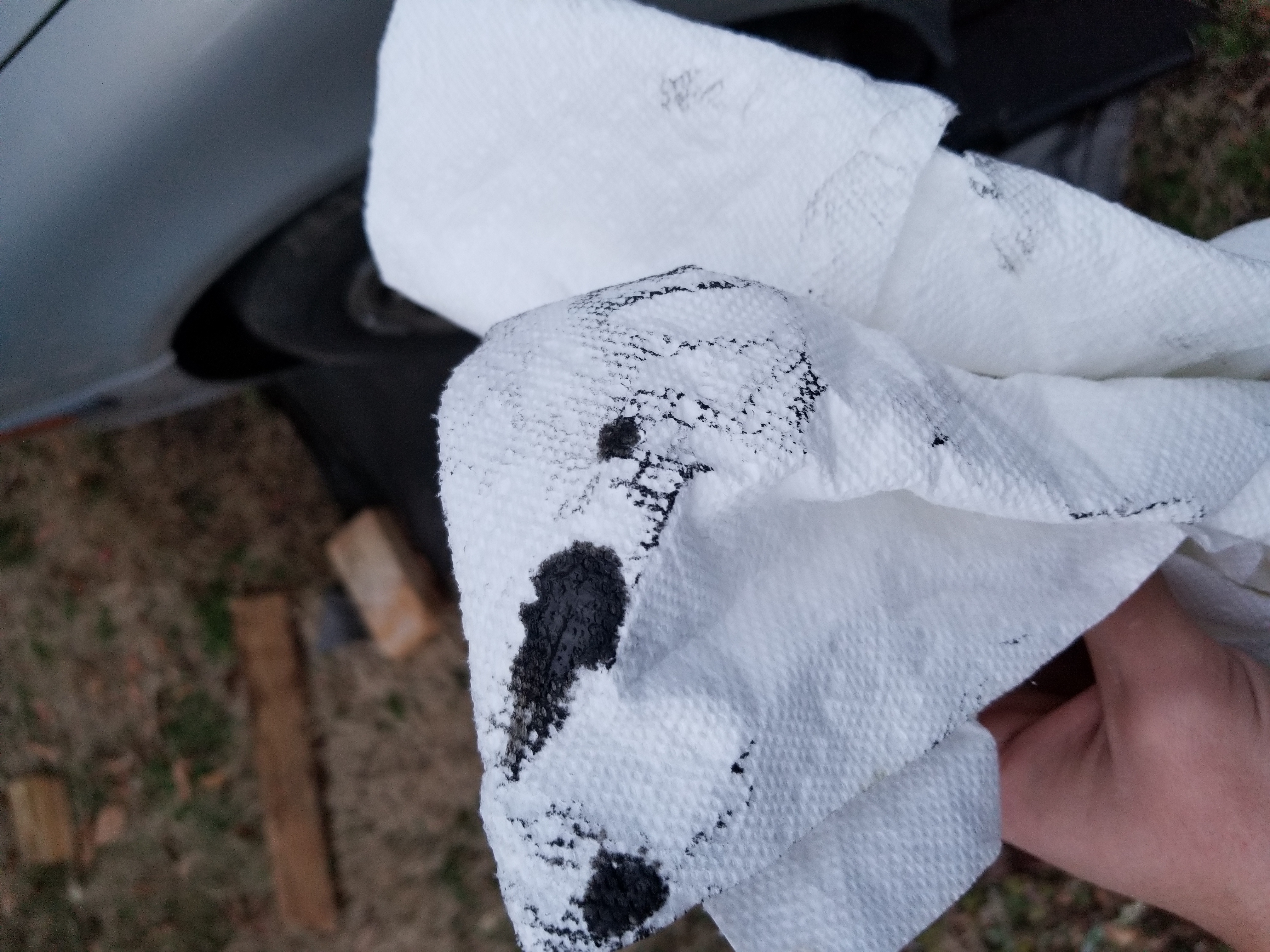

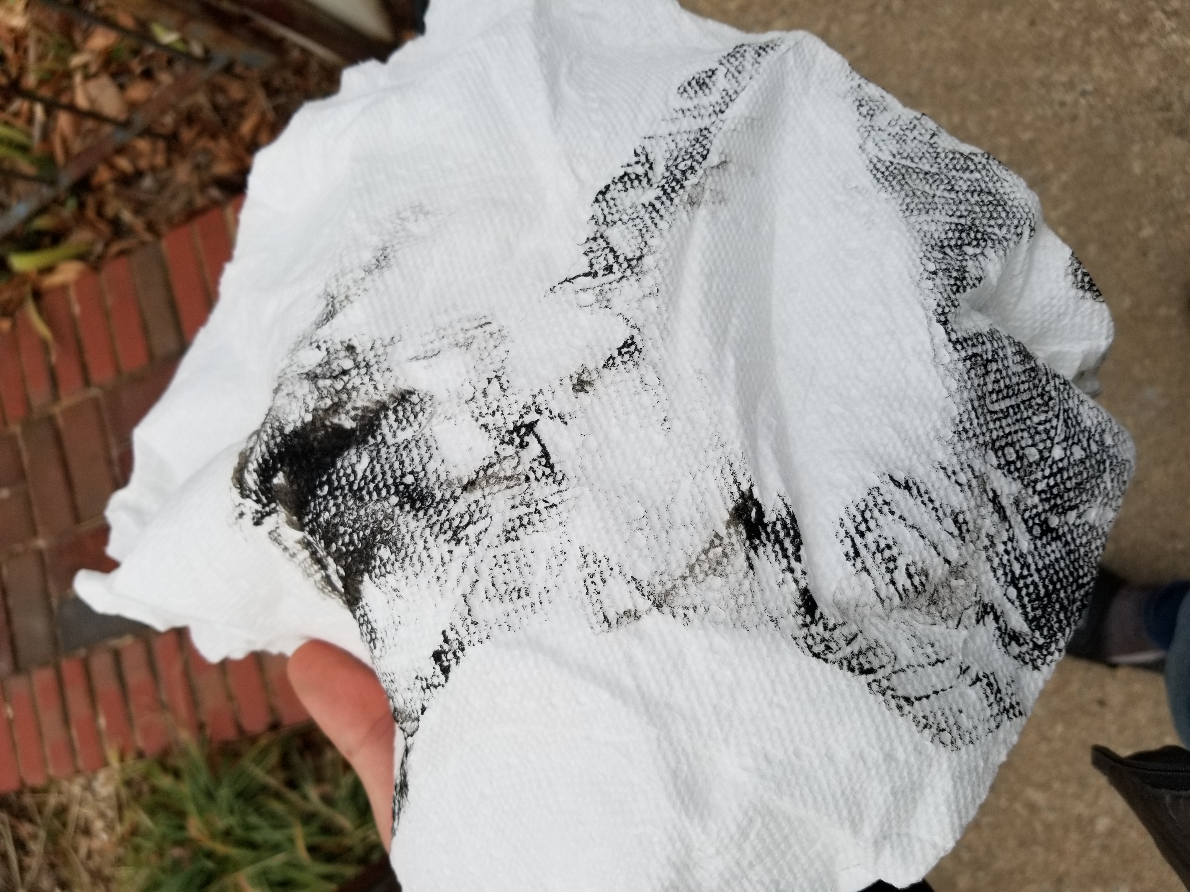

So I stuck some paper towels up the tailpipe and did pick up some oil. Not sure how much you were looking for but it wasn't all that much, though I couldn't get the paper towels that far back into the pipe.

Use more of your senses then your eyes, feel and smell the paper towel. To determine if it is (soot and water) or oil. The stuff in the second picture looks like soot. In the first picture I cannot tell by looking if the heavy spot is oil or a mixture of soot and water.

Agree you should have done some testing, but you are where you are at. I would have liked a compression/leak down test to determine the condition of the rings. Based on the pictures provided your engine shows clear signs of excess oil in the combustion chambers. This can be from PCV, bad block (rings) or leaking valve stem seals.
Some questions: 1) is that the original head gasket? I don't recall the original color - yours have a red seal. Does the part say Volvo? Anyone chime in on what the original of that year looks like?
2) Related - and assuming head gasket was replaced. Is your block deck flat? Your oil leak if it was gasket related is very unlikely through the spark plug.
3) What is the condition of the cylinder walls? Are they messed up or do they look good and still show original hash marks?
4) You need to look at your PCV system - hopefully it is clogged up and that was your problem - meaning your block is good.
You can redo the head if it is flat or send it to a machine shop, replace your valve stem seals and clean up all your valves. Put it back together and be good for many miles. Hopefully your rear main seal did not suffer any damage.
The biggest concern is that the oil issue is ring related, but looking at the head all but one cylinder shows signs of being "normal". Unless the car overheated really bad and the rings were ruined you may be okay with the current block. But the prior owner may have had a really bad overheat and replaced the head gasket and related only to have the oil issue. That is what you need to determine. The easiest way is to ask, then to inspect every part to see if it has been changed.
If you click on the photo to view, then click again to expand you will see the hash marks, the cylinder walls look good. However stuck rings are still a possibility. Soaking in Sea Foam while he has the head off should take care of that.
