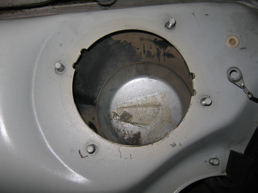

Looks like my tank should be PUSHED towards the front. I can't remove the metal can to access the sender. Anyone else have this problem? How do I rectify this? Both FP and sender are original and now 20yrs old...and so are their tank seal gaskets. I thought replacing both gaskets might slay P0455 GROSS MONSTER.

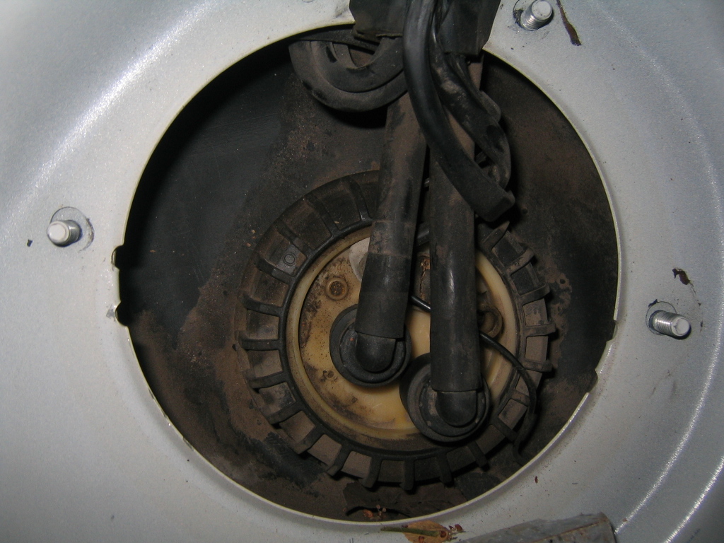

The fuel pump access looks OK:
Update: I carefully backed out both rear tank strap bolts (12mm?) as I wasn't sure just how long they were. About 1/2", maybe 5/8". This did give me a bit more room. I'm now able to rotate the metal cover and tilt it. However, no joy in removing it.
I'm thinking about replacing both bolts (one at a time) with longer ones (1", maybe 1-1/2") so I can drop the tank further allowing me to remove the metal cover.
I also noticed it appears my tank should be moved down, then forward. With a flashlight, I can see the cut-outs in both tank & unibody where they can snug up close. I see a gap of maybe 1 to 2" instead.

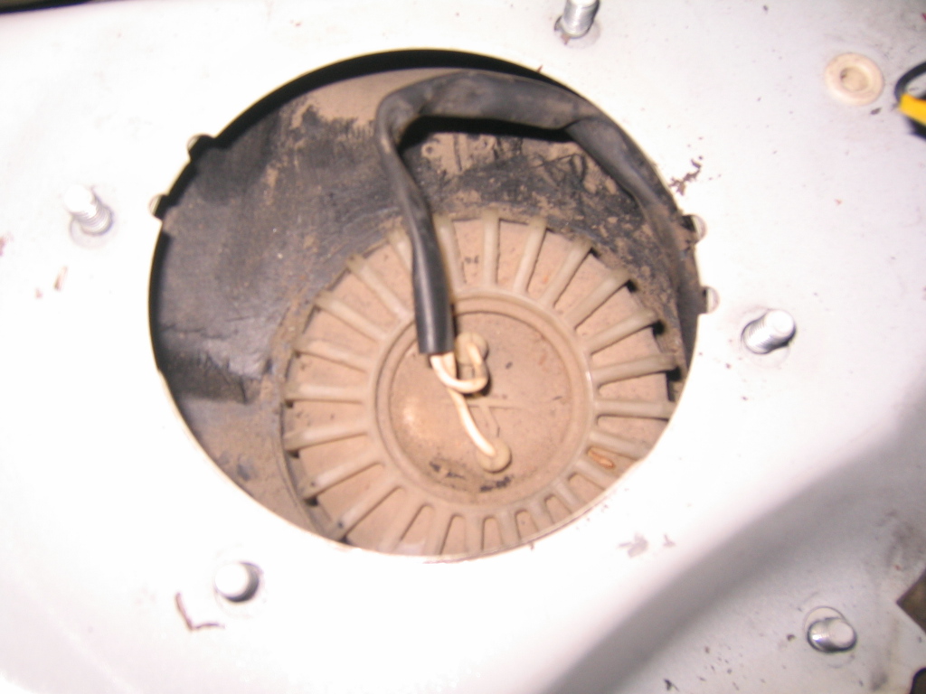

I was able to drop the tank far enough to FINALLY pull the metal 'hat' off the level sender. There's a small victory. I then realized that the factory had arranged this cable to cause it to be pinched hard under the cap against the blonde screw-down collar. So I rearranged the harness to avoid this. Another small victory.
