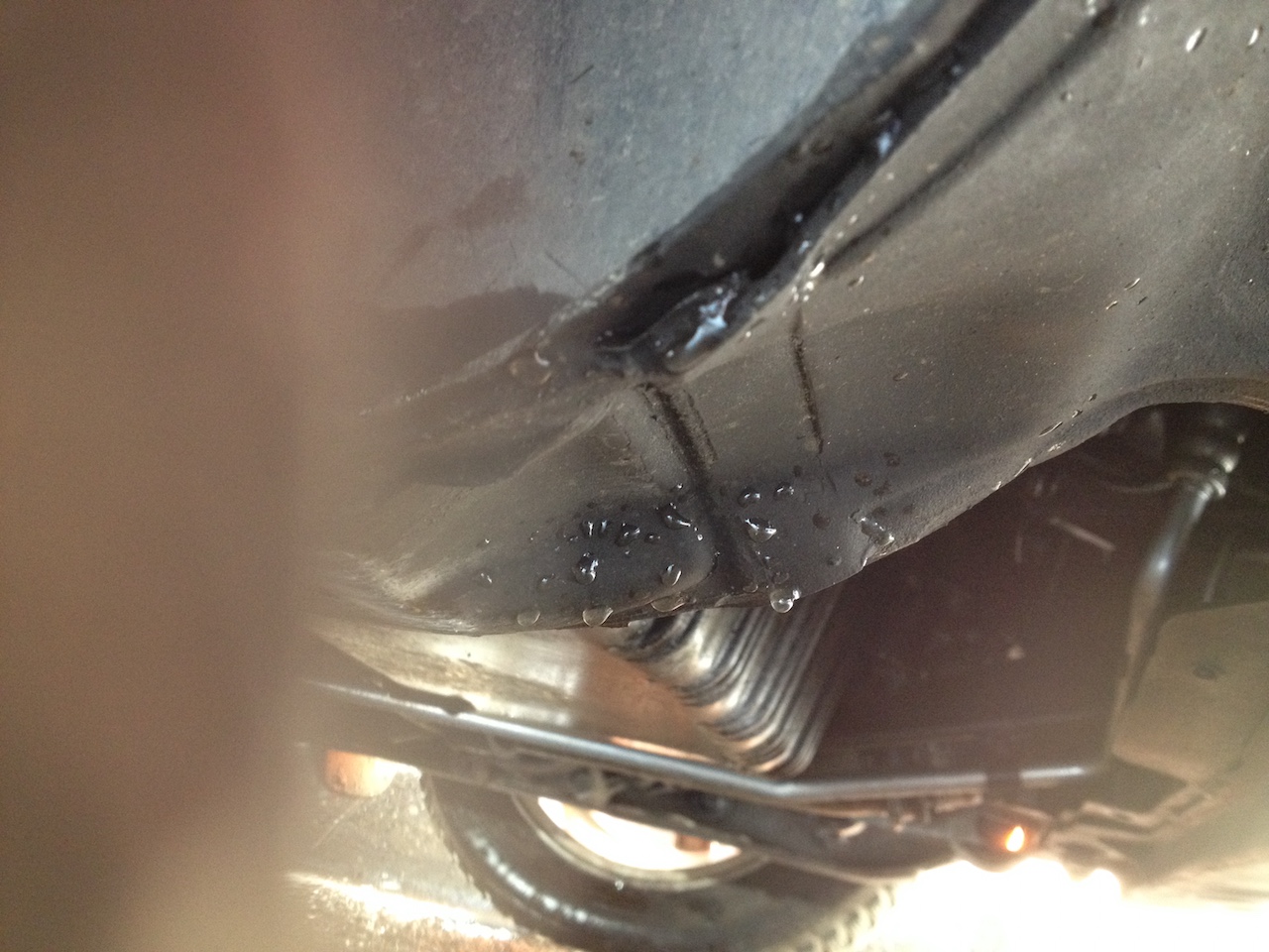

I open this new topic for a new job. I would like to know if someone has already replace an axle carrier on his volvo v 70 ?
I drove in a hole recently, a little deep one : I' lost some air and the axle carrier hit the side of the hole. With the new French technical control, my car will be refused in that state.

- This is the subframe dent.
- If the car drives well, this little dent should not affect the ride or safety. Or maybe the inspector will not notice it.
- For subframe replacement, you need to support the engine first. There are some photos in forum.
