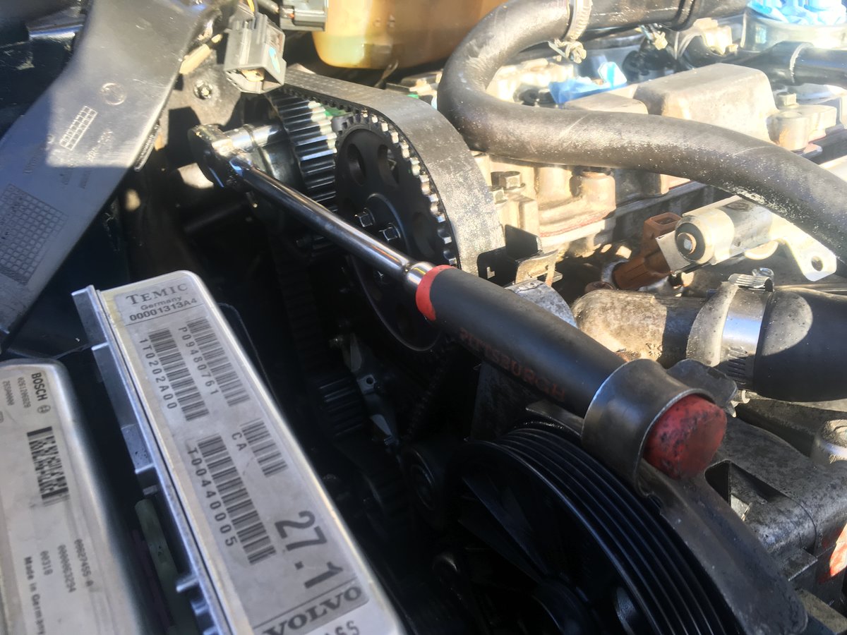

I don’t know if other folks have done this, but I’m going to let myself think I invented this method for holding the exhaust vvt hub in place while installing the timing belt.
It appears that the technique would also work if you had an intake vvt hub, just use a shorter handled ratchet.
2001 V70 2.4T Tip for holding exhaust vvt hub
