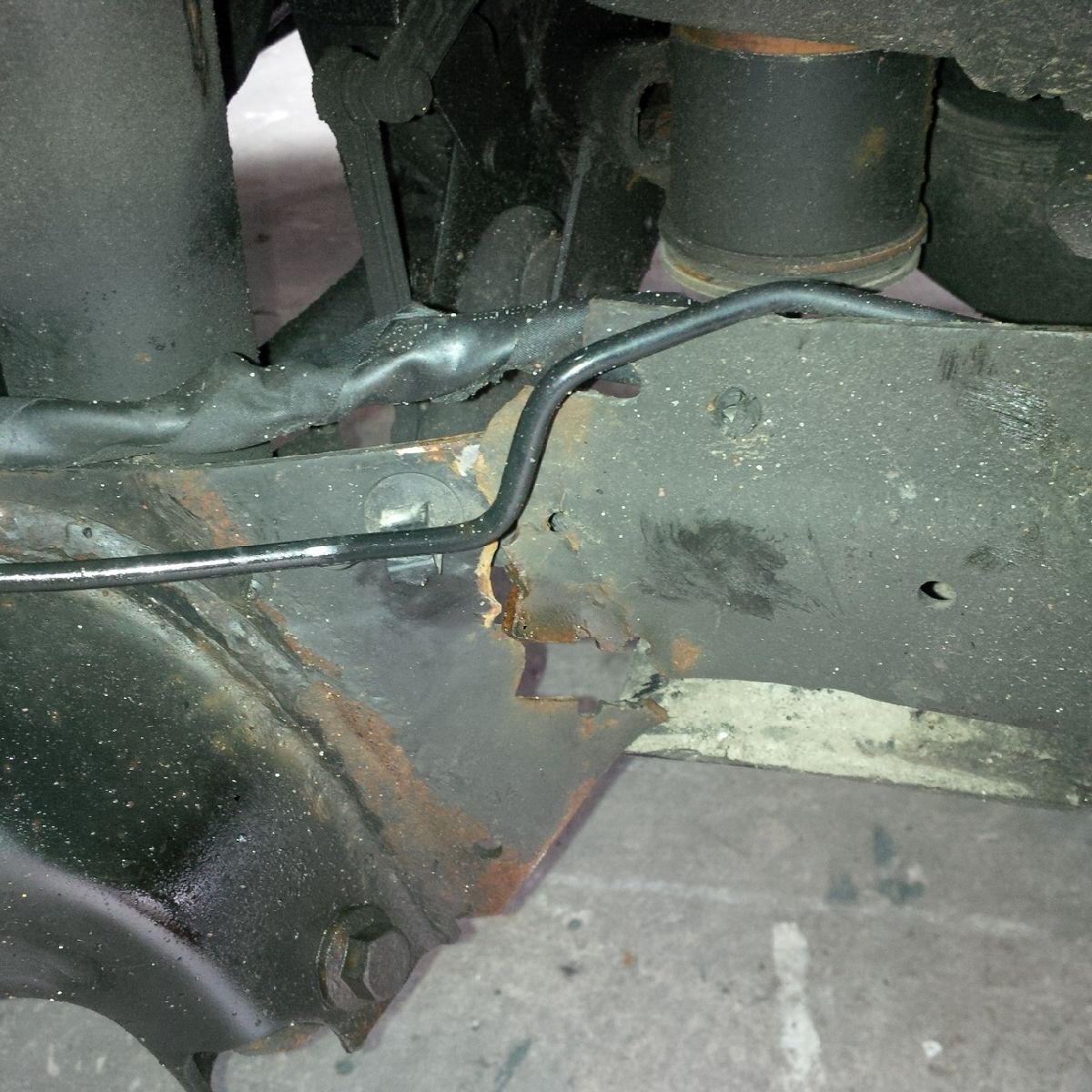

Well here's an update . . . I made some assumptions about what I might be dealing with based on the age of the car and the location of the brake fluid leak. I got ready with flex lines, rear stay and trailing arm bushings for both sides of the car. The passenger side where I had the brake fluid leak was behaving oddly during jacking and wheel removal. This is what I found.
Speechless. . . turns out it was not the flex line leaking but the solid brake line shown up against the trailing arm.
Best I can find is original Volvo on FCP Euro. I guess there are no heavy duty aftermarket options like those available pre-2007.
Any ideas would be appreciated. Otherwise I will just go ahead and do both trailing arms for peace of mind. Very bizarre, the part was a bit rusty but not rusted out by any stretch, and the break was there for a while because there was some light corrosion on the fracture surfaces.

Very strange. First time I see this. I'd show this to Volvo, it looks like a severe defect on the arm, could it be an aftermarket piece?
What is the Carfax of the car, any accidents?
Just the 'saw' fracture pattern is not normal, if a weld would give up or if there was a crack, it would have been a single long tear in the metal.
I'd certainly replace both sides even with used ones - hopefully original Volvo ones.

I agree it's strange. I'm not finding aftermarket, just Volvo ones - pre 2007 there are lots of options but not after that year. Yes I was going to bring it to the dealer but would be surprised if they do anything for me. No record of an accident in the used vehicle information package when I bought the car. The crack seemed to jump between holes in the stamped metal and if it was from an accident I would expect it to be bent as well as other things bent. I think I will email that photo to Volvo Canada and see what they say about it. Pothole? I will post if they come back with an answer.
If anyone knows a good on-line supplier that has aftermarket stuff for the 08's please let me know.

It also looks the kind of area where a good weld could do some decent patch. At least, until sourced a replacement part.
The best i really a junkyard, pick and pull type, there are a few near your location, may just go on local.google.com and type something like auto recycling. With a little luck the 2008 may have the same part as the earlier years

I opted to go to the dealer and pay up - 2007 onward have different parts and that is the point where the availability of aftermarket declines. You're probably right that there are some decent second hand sources but at the moment i wanted to be sure to have a 100% good part. I've been picking at this for a while in spare time and all the suspension work is done. The back wheel is in the centre of the wheel well again. Now I just have to splice in a new connector to the brake line upstream of the trailing arm and connect up the new rear section of brake line. Such a shame because we have forecast up to 30cm of snow tonight. It is falling now and I won't quite be ready to drive in it . . . trying to drift our minivan is just pathetic. My wife tells me she heard my car crying in the driveway as the snow started.

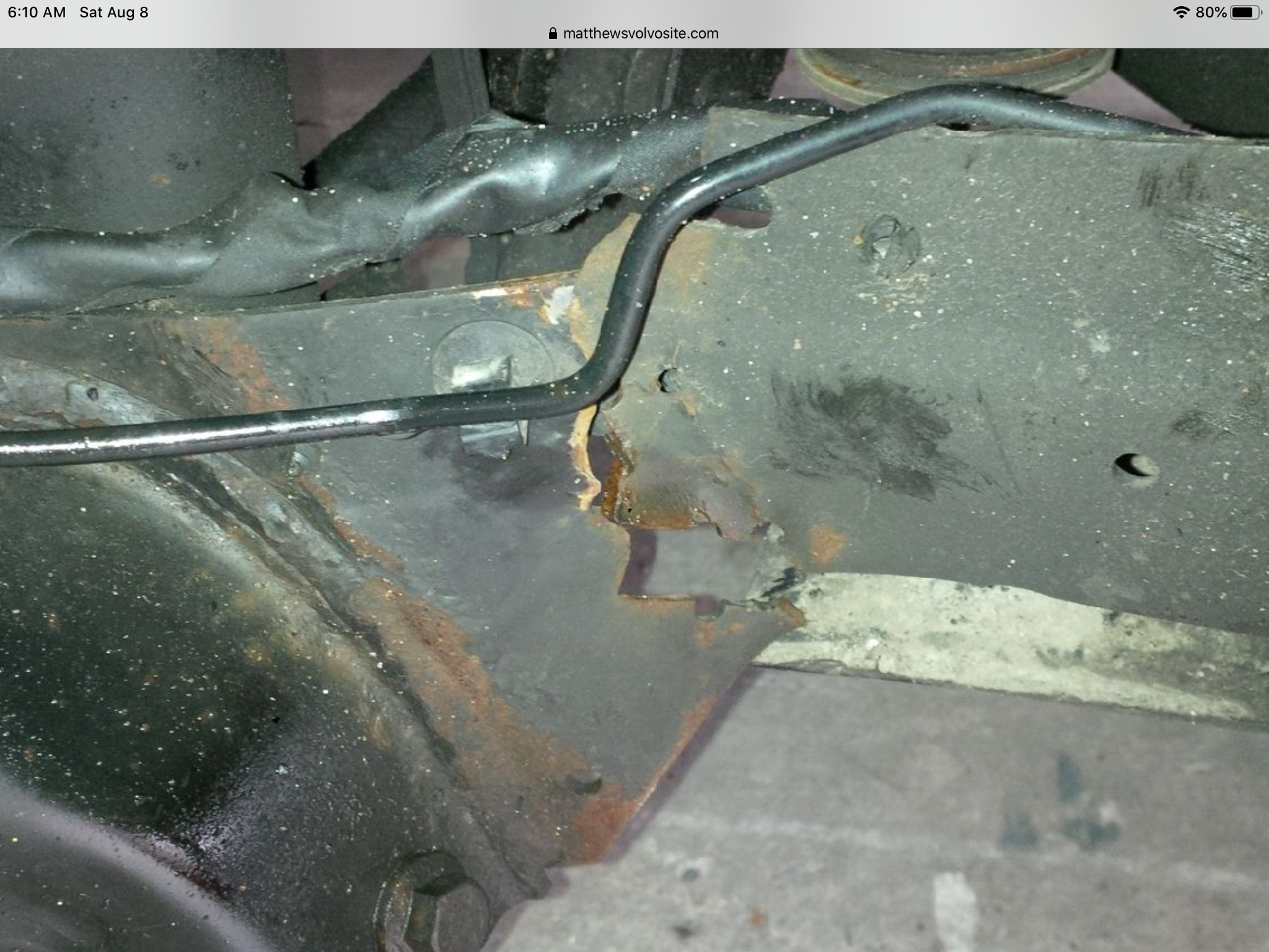

Stumbled into this thread this morningbratwurstnrice wrote: 24 Feb 2018, 11:00 Well here's an update . . . I made some assumptions about what I might be dealing with based on the age of the car and the location of the brake fluid leak. I got ready with flex lines, rear stay and trailing arm bushings for both sides of the car. The passenger side where I had the brake fluid leak was behaving oddly during jacking and wheel removal. This is what I found.
Thanks.
Holy crap.
