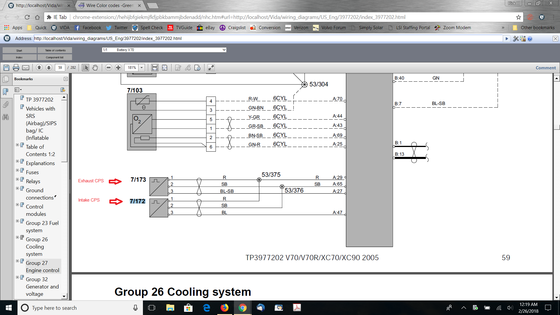

Hi all first post and hoping someone can help. Car is a 2004 2.5T Volvo XC90 B5254T2
I was driving home about two weeks ago and turned the corner onto my street after highway driving and noticed the engine had no power. Got home and turned it off and tried starting again. Instead of instantly starting, it cranked for what felt like a couple of turns and then started. Engine is idling rough and no throttle down low but above 4000 rpm, when it eventually get there, it feels fine.
I pinched the scan-gauge from my other car and found P0340 and P0348 codes. After clearing the codes they reappear as pending before being logged upon consecutive start ups.
From what I gather the codes represent a camshaft position sensor circuit fault on the intake cam. When I measure the harness, with the CPS disconnected I get 5V on red/#1, Ground on black/#2 and 0.96V on blue/#3.
I have checked the blue #3 back to the ECM pin #47 and have found continuity, no high resistance, and no shorts or open circuits.
In the manual it states #47 should be 5V when ignition on and then vary between 5V and 2.5V when running. I have only 0.96V. Which makes sense according to the codes.
I have tried another CPS and this has not changed anything.
I have run contact cleaner over the sensor plug and the ECM.
Every independent service guy I have called thinks it is a MAF, Battery, CVVT actuator (can't remember the name) and that the codes don't mean anything unless I bring the car in. Based on what I have found I suspect its the ECM.
Are there any other suggestions on here before I take it to a service centre for a potentially expensive visit?
Thanks for any help.
Glenn
2.5V - 5V on blue with the CPS connected. Blue is the CPS output, It is not going to output disconnected.
P0348 is specific to Camshaft position sensor, exhaust Signal too high. Which has a Blue-Black output wire and is pin A27 on the ECM.
I think your find your problem on the other cam .....

Well I discovered a couple of things prompted by your post. Firstly I found the exhaust Cam Position Sensor. Second I found the harness disconnected and laying down by the transmission.
At this point I thought I had solved everything. Connected harness with some contact cleaner and now the car refuses to start at all. It just turns over.
Error Code P0340 and P0347.
I am still hopeful this was the problem but noticed my voltage was less than 11V.
So I have disconnected the battery and put it on charge hopig to reset everything and try again with a full battery.
Fingers crossed.
Will update later tonight.

P0340 ECM-3000 Camshaft position (CMP) sensor, intake Faulty signal or signal missing
P0347 ECM-3010 Camshaft position (CMP) sensor, exhaust Signal too low
P0348 ECM-3010 Camshaft position (CMP) sensor, exhaust Signal too high
Dead battery could be the reason for the switch from P0348 to P0347.
Both CMPs use a common +5V and ground from the ECM. I'm thinking a defective exhaust CMP is pulling the common 5V line down.

I got the battery charged a little to 12.1V. Reinstalled and started the car and this time it did start but threw a P0345 code and the original P0340 code.
Still taking a long time to start and running rough.
Leaving the battery on charge overnight and will continue to diagnose tomorrow.

Latest Update.
Scan Gauge II provides the following codes. P0340 and P0345. These codes are consistent. The P0345 code appeared after plugging in the exhaust CMP harness which was unplugged at the time of the OP.
Engine is hard to start and fires only on about the fourth attempt and starts at a low idle of around 400 before picking up the revs.

So both CMP sensors have a missing signal.
I have changed CMP sensors with a spare from a working vehicle in both cams and the fault returns which leads me to think it is not an individual sensor issue.
I have checked all wiring and have continuity from ECM to harness for both CMP sensors.
I am now out of ideas....
Have you pulled the ECM and cleaned the connections?
Sometimes just pulling a ECM and reseating it will clear errors.
Any hint of corrosion on the wires? Sometimes corrosion will go under the wire insulation where you cannot see it.
