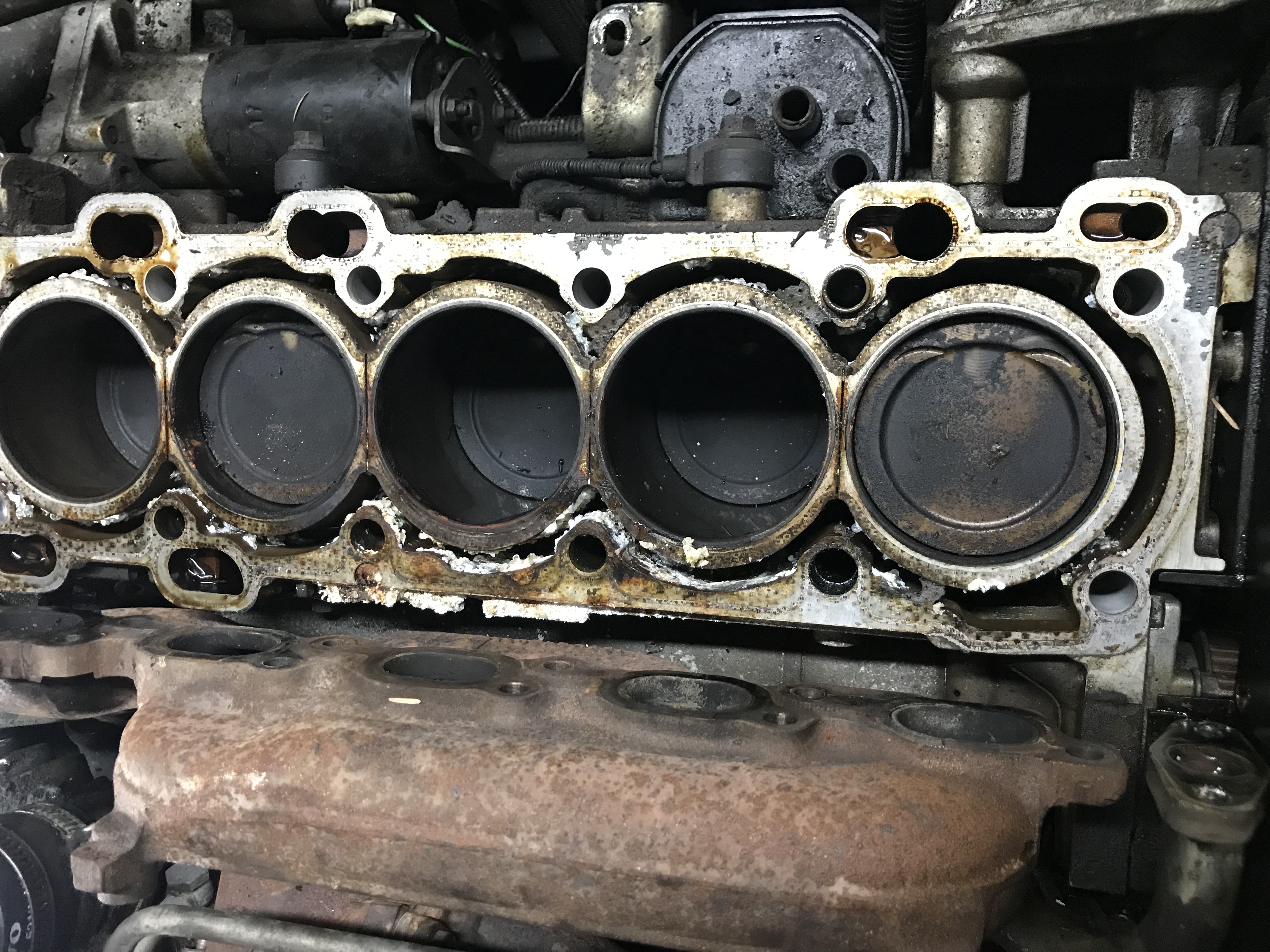

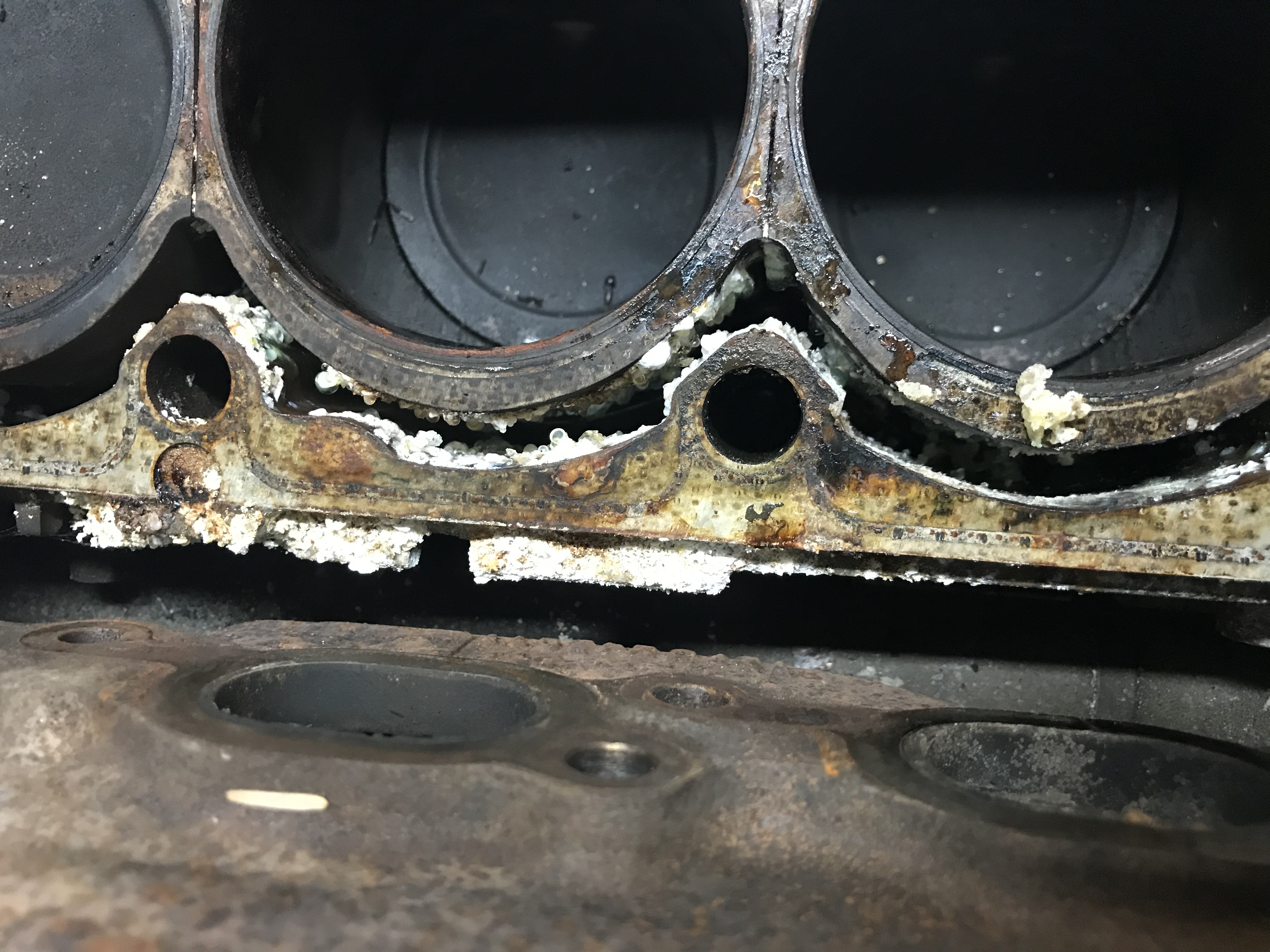

So we finally pulled the head off this car that’s been sitting for a while. Is the white crystally lookin stuff from the coolant when the HG gave up? Or what is it? What’s the best way to clean it up to prep for the new head?
Thanks you for your help.

So is it toast or cleanable/repairable?

My guess would be that the PO put some "head gasket fix in a bottle" in it. I've pulled the head on many, many Volvo's that I doubt had coolant changes that had NONE of that stuff.

It definitely was not taken care of. The plug wires were literally melting in my hands. The plugs hadn’t been changed in who knows, probably never yet the timing belt was done in nov 2014.rspi wrote: 08 Mar 2018, 09:13 My guess would be that the PO put some "head gasket fix in a bottle" in it. I've pulled the head on many, many Volvo's that I doubt had coolant changes that had NONE of that stuff.
Either way, Robert, is there a best way to clean this stuff up? I did the head on my v70 a few years ago and it didn’t look like this either, it was pretty well maintained. So this corrosion is new to me.

If the car was overheated until it shut down, all kinds of gunk in there, melted parts on it, I'd replace the engine, turbo and all.

I would go for another engine, too.

Hate to say it but agree with the other guys on replacing the whole engine. If that is a stop leak type product it can get everywhere like the radiator, water pump, heater core and turbo pipes to name but a few places. The only way to not do that is to pull the whole motor, strip it down and have the engine acid cleaned to get the crap out. Initially I thought it might have been some cheapskate using tap water from a very hard water area in the coolant instead of de-ionised water, but looking at it I don't think that is it.
