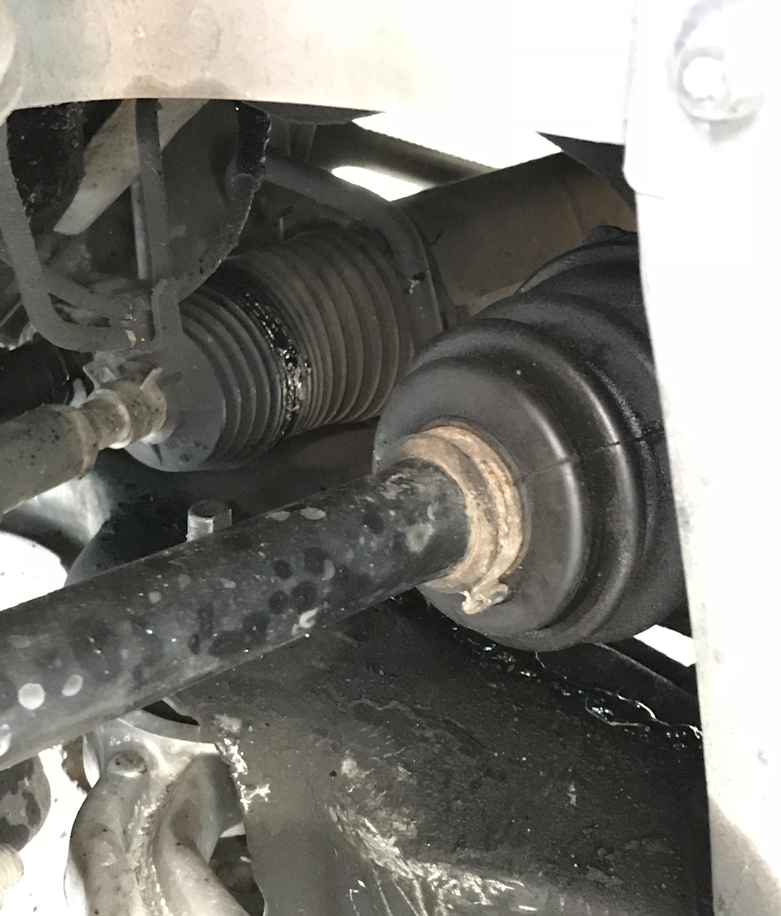

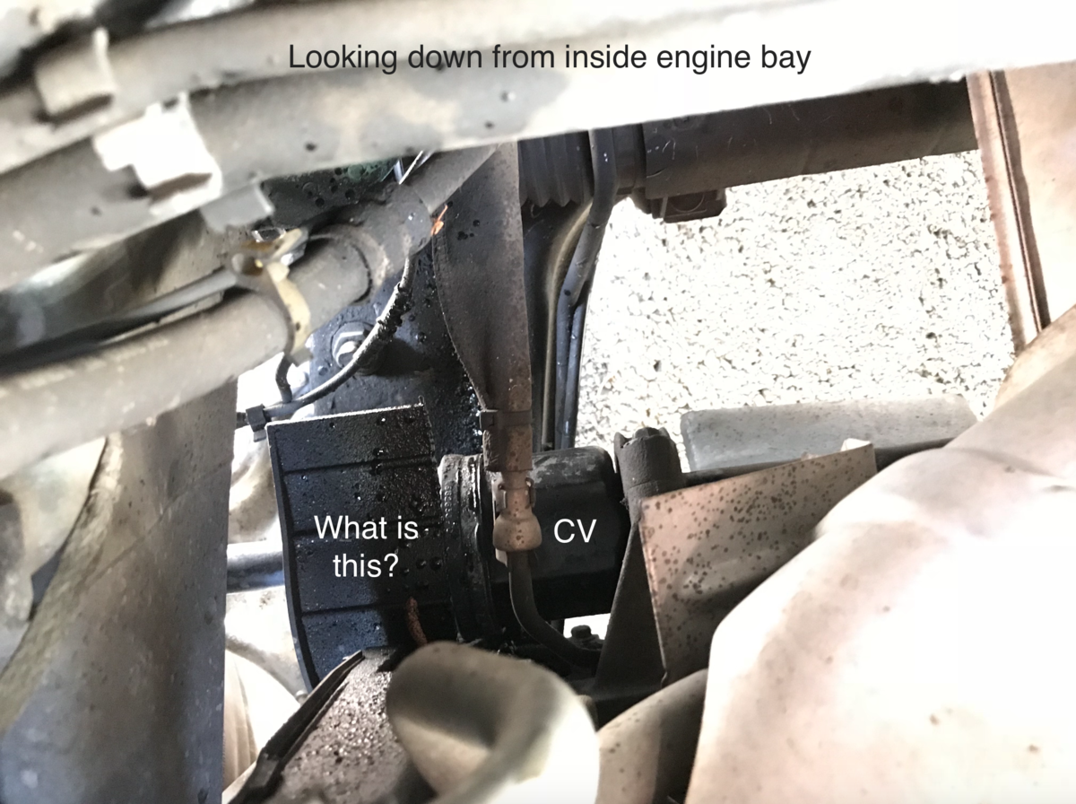

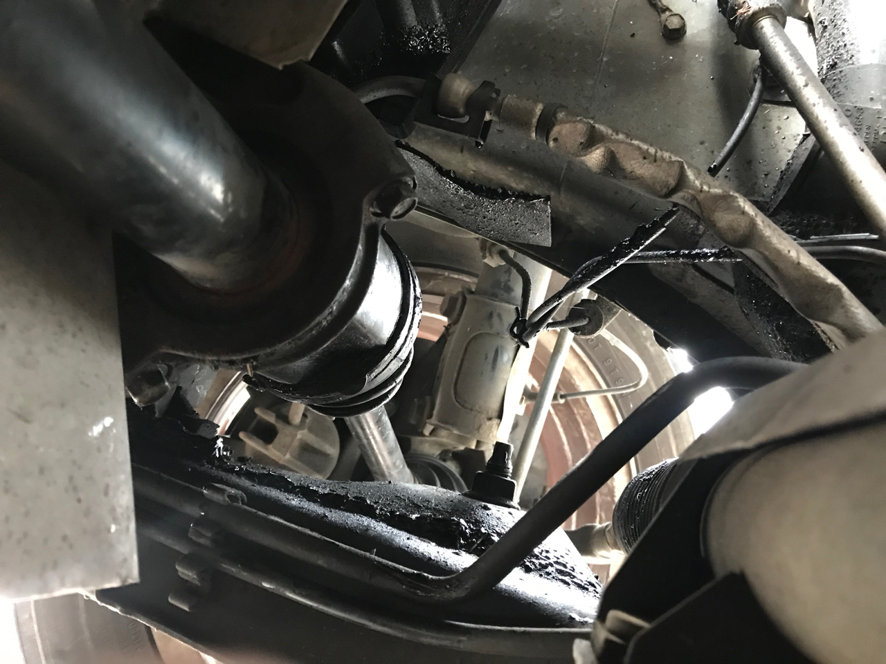

Was checking in on the front suspension/steering parts on my '02 S60 (base trim) and noticed wet fluid on the inner tie rod end boot and the splash guard behind the passenger wheel.
I’m assuming that’s not a grease-filled boot that’s split, but that it's engine oil dripping from above? But I can't quite figure out where from.
Here are a few pics, hoping someone might be able to help give me some ideas of how to track this down…
Looking behind passenger wheel:
Looking down into engine bay (also what is the black stepped kind of thing?):

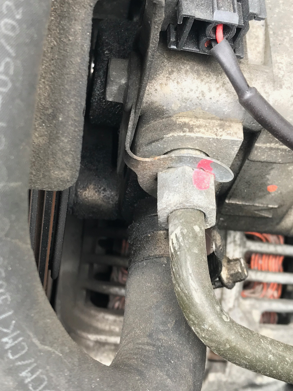

(Also, the spots: coolant? or perhaps window washer fluid? It’s possible I could have splashed either onto the fan sometime while refilling, and that's why it's all over the engine compartment… I will clean the spots and see if they come back — if they do come back, where should I start with tracking that down?)
And while we're in the bay, just out of curiosity, what are the two things at the top and underneath the hose? They kind of looks like they are supposed to have something connected into them, but maybe just some kind of special fasteners for the insulation…

Looks like split boot on the c.v or driveshaft.
There's a streak of oil on the top of sub/frame that lines up with the same streak on the steering arm boot.
Get your hands on that boot and see if you can feel a split.
If its oil, not grease , I'd pull the passenger wheel, fold back the wheel liner and look around the oil pump and look at the timing belt.

Reporting back: I didn’t have time to take the wheel off before it got dark, but I reached in to feel around the CV boot and the inner tie rod end boot. I couldn’t feel a crack.
I think it’s oil coming from above though, as there is oil on the TOP side of the lower timing belt guard (the black plastic thing I was asking about in the second photo). I pulled the top timing belt cover, there is a very thin layer of oil on the inside of the intake cam sprocket, but otherwise what I could see from up there looked ok, so I’m now beginning to suspect the front crank seal or oil pump gasket. :/

Those nuts are just securing hardware for the firewall padding

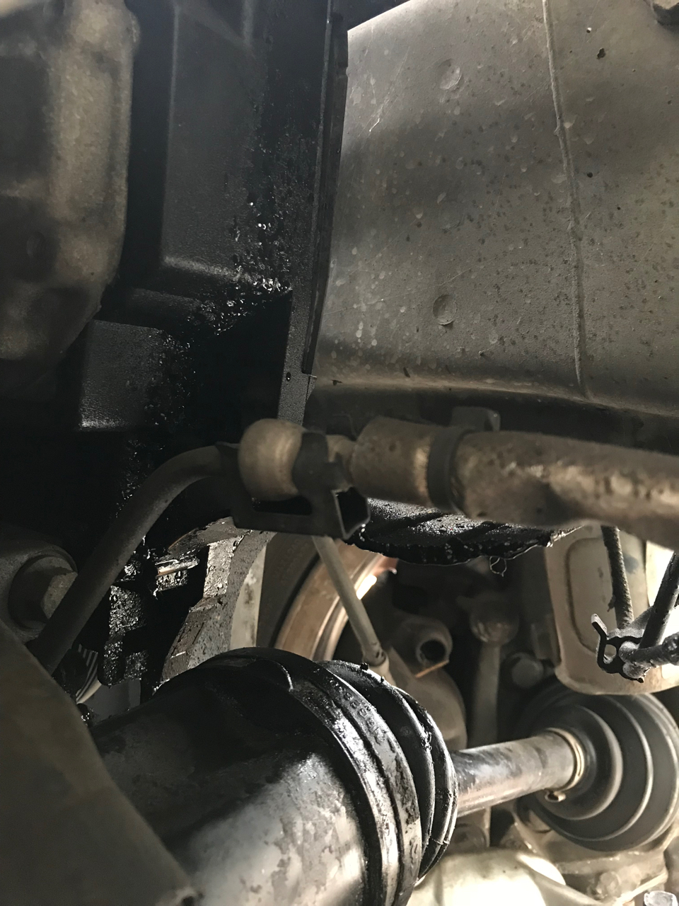

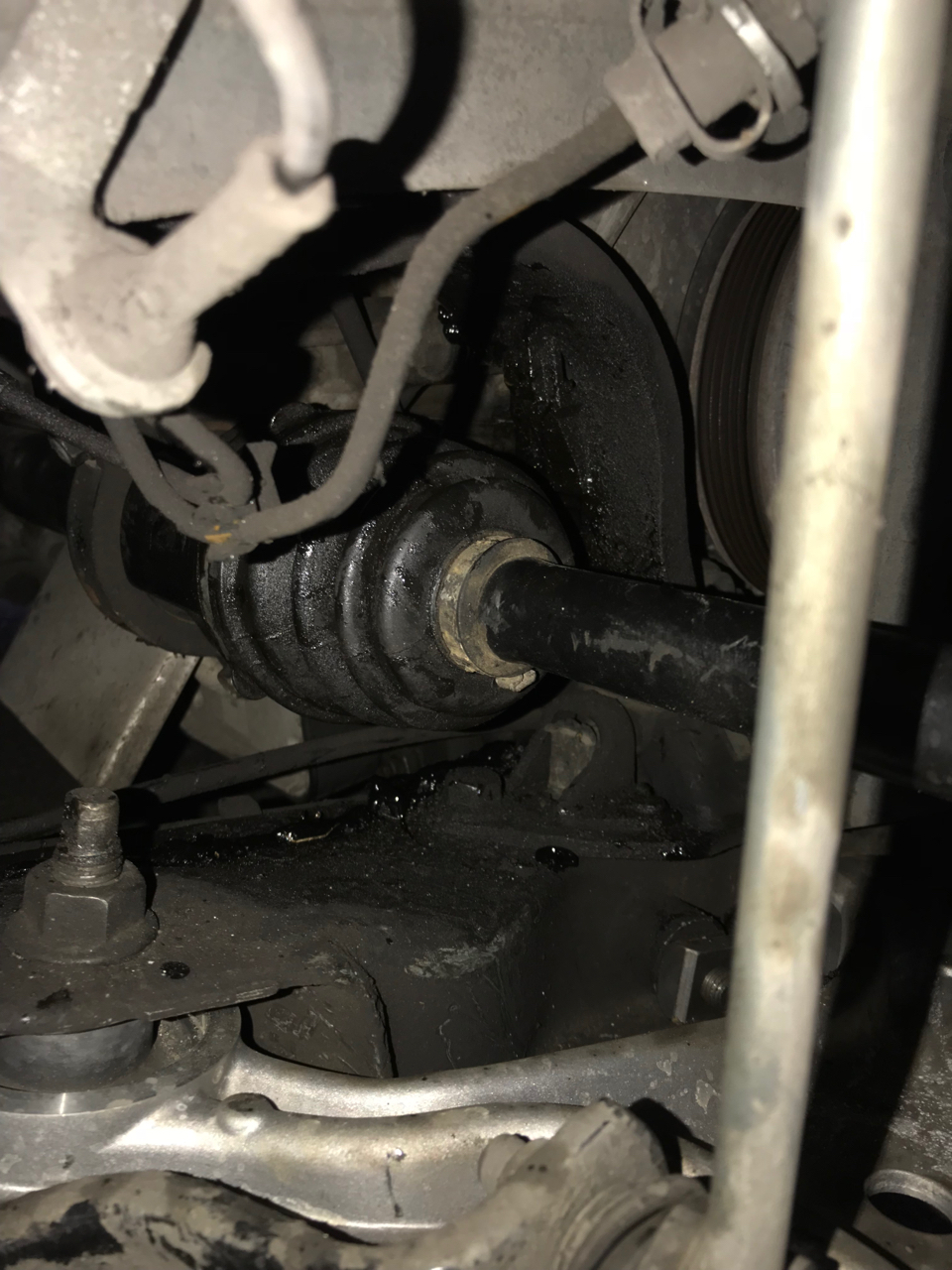

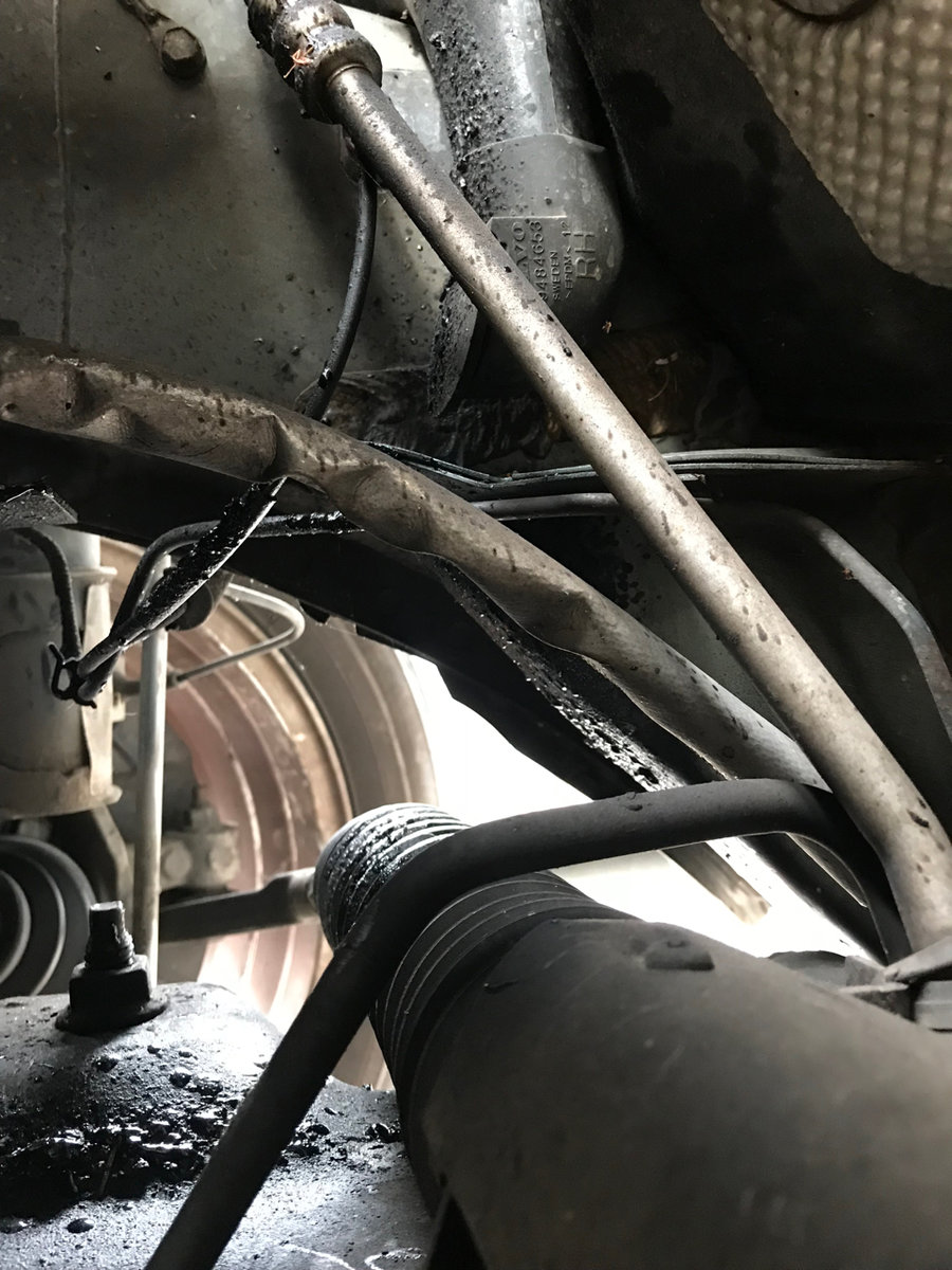

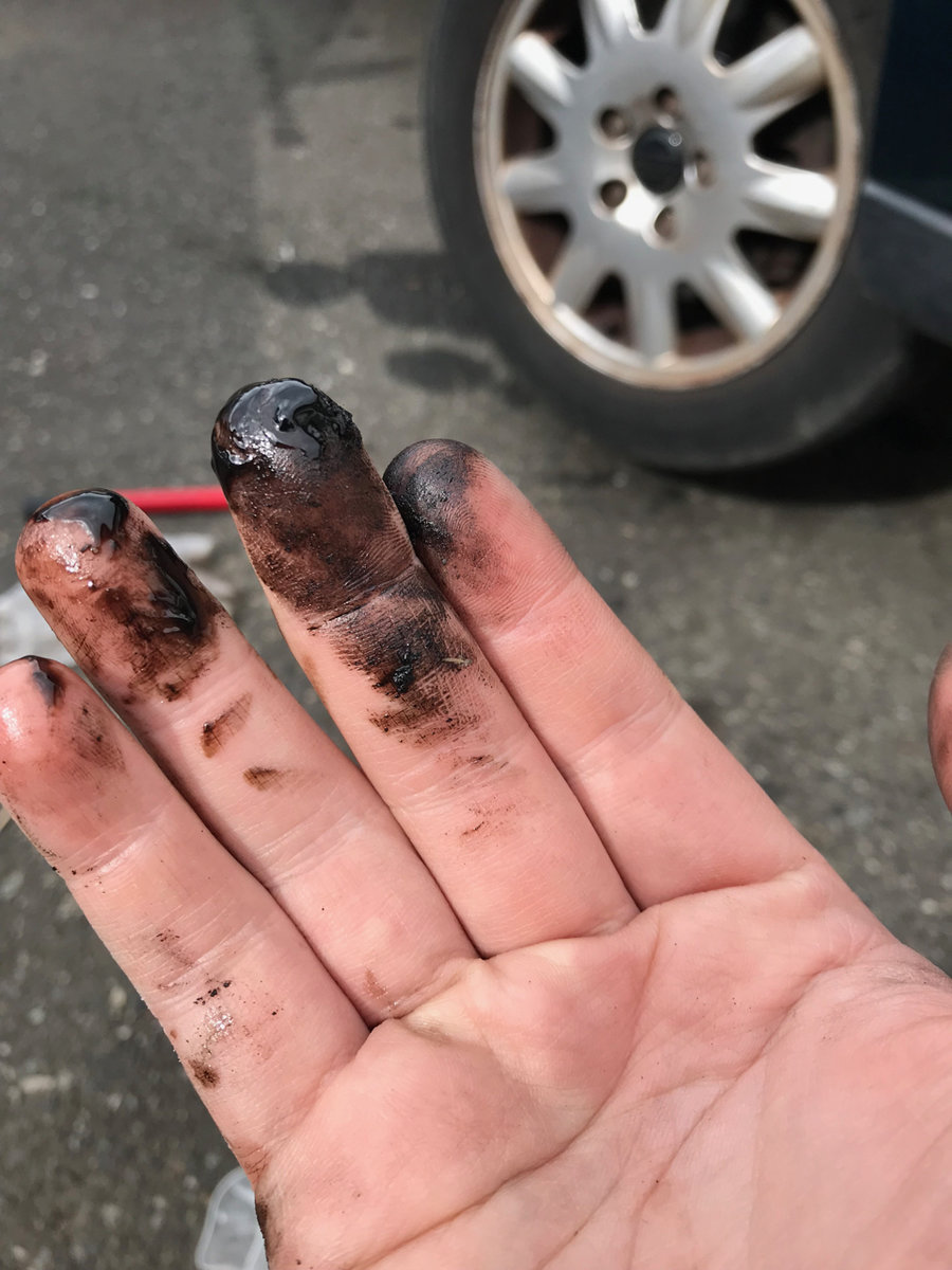

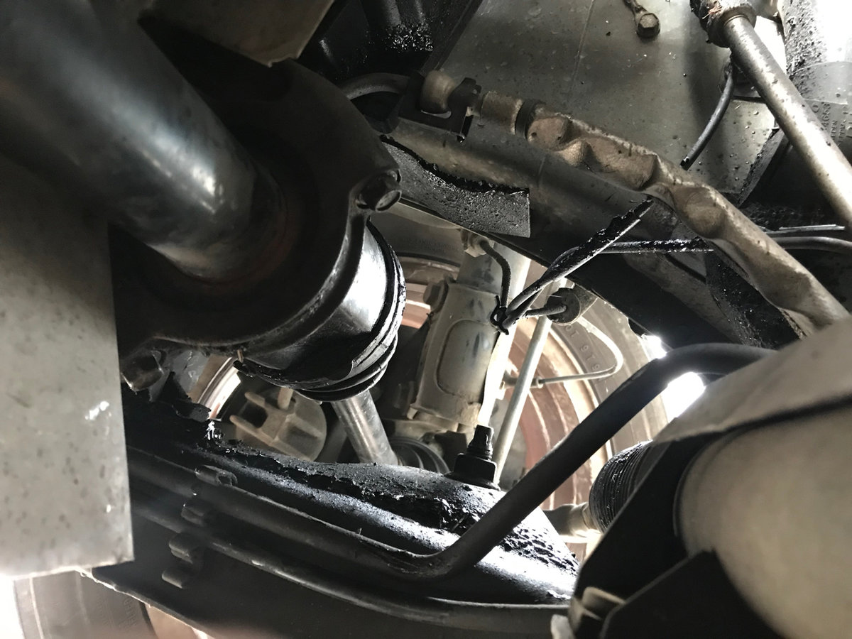

I don't know what color the CV grease normally is, so I don't know whether this is axle grease, or badly blackened/congealed engine oil:
As you can see, there are globs/droplets from the timing belt cover and lower belt guard, down to the CV boot, various lines, and down onto the subframe. I don't know whether to interpret as spray downward from the timing belt cover onto everything else, or upwards from the CV boot, collecting on the timing cover and dripping down onto the lower guard (it's getting onto the top of that lower guard one way or another), or something else entirely:
Looking in from behind the passenger wheel:
From around the firewall, looking towards the front and/or right of the car:
Bottom of the CV boot:
Timing belt cover over CV boot:
Looking out towards passenger wheel: Help me MVS, you're my only hope!

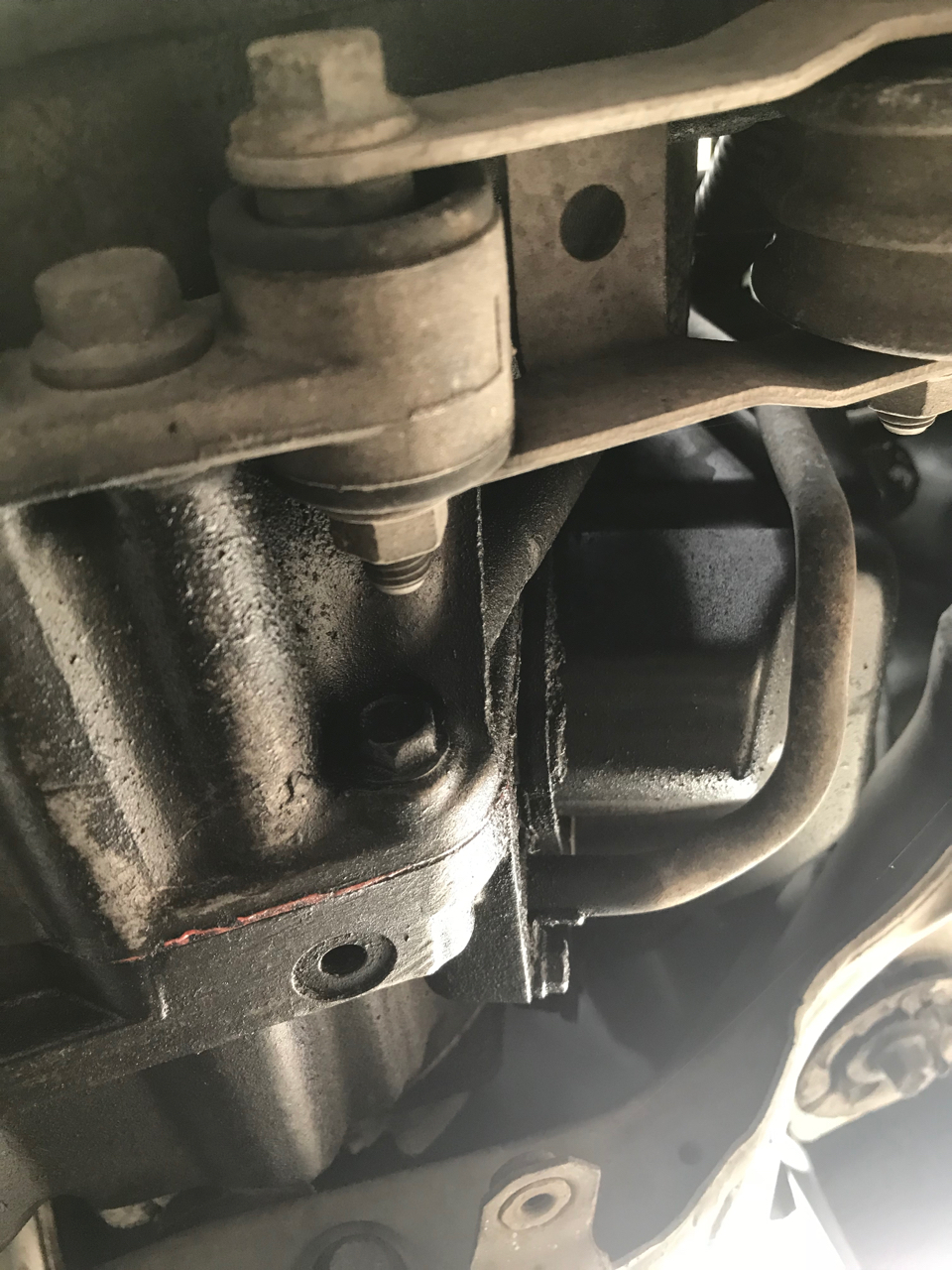

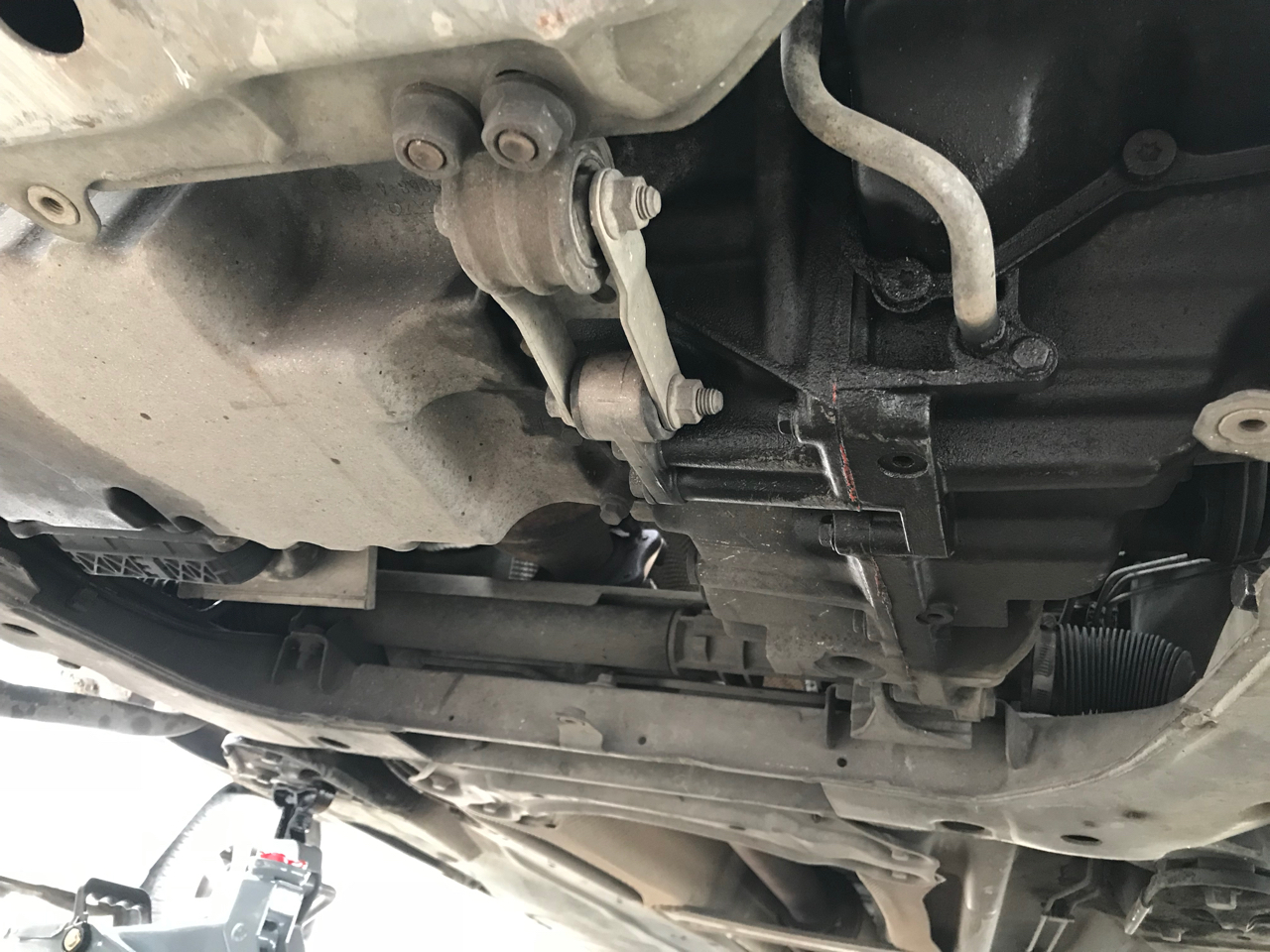

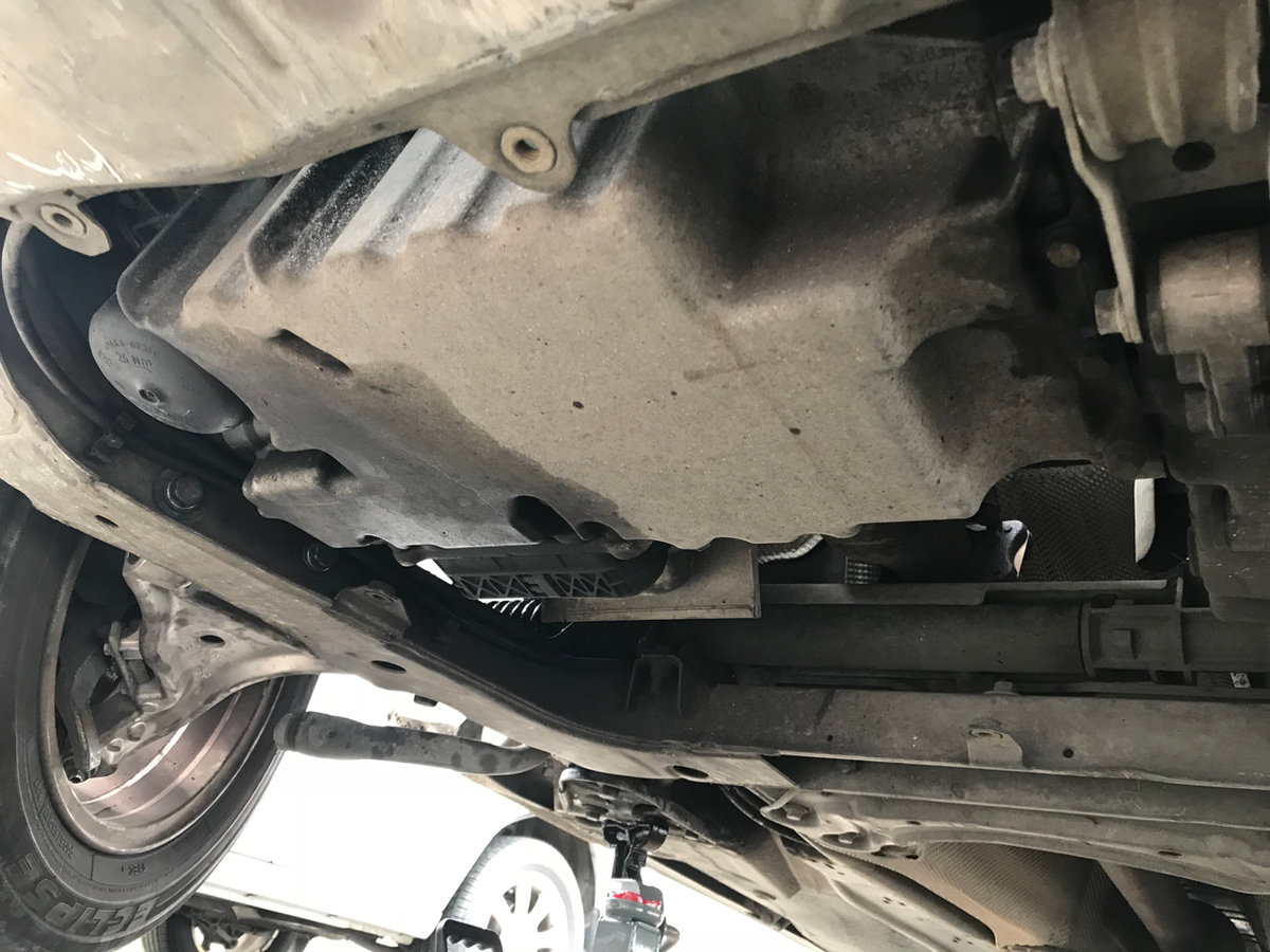

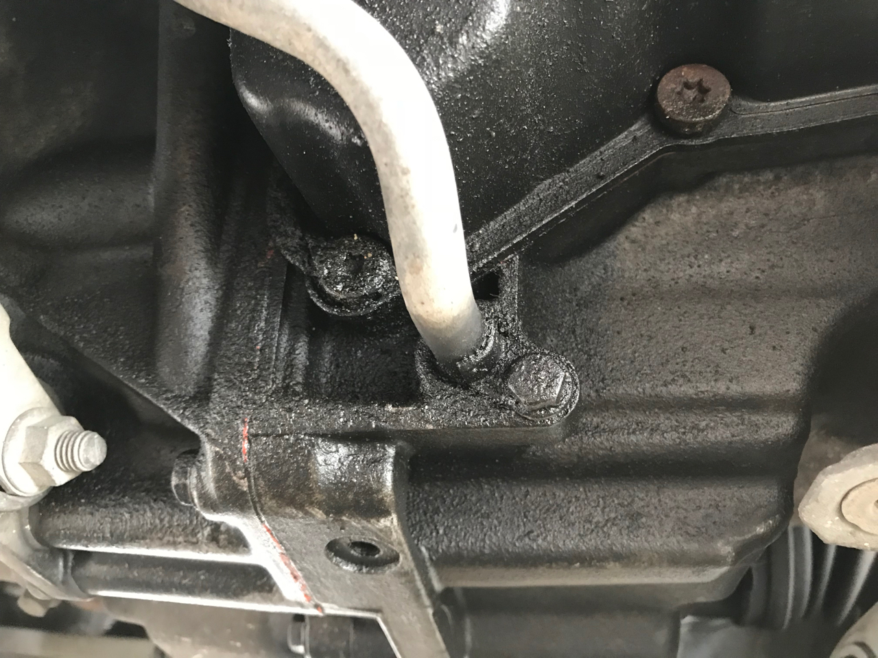

Ok, so in addition to the awful (and fresh-looking) grease or oil leak above (any thoughts?), the following all have some grime/fluid of their own going on underneath…
Transmission:
Power steering pump:
And oil pan:
The oil pan I don't think is an additional leak, the engine oil cooler and back of the block are totally clean: I think this is coming from the main/first leak in the timing area?
The power steering pump maybe needs a new seal — it's localized to the pump itself, there's no fluid on the drive belt.
The tranny is what I'm worried about the most, but I'm not sure what to make of it, it doesn't seem to be super concentrated in one area — could this be the pan gasket just seeping?
Transmission:
And oil pan:
