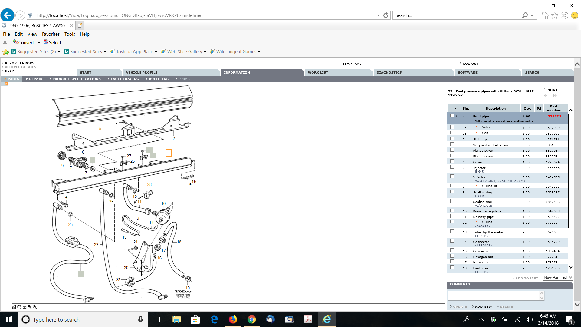

The part number you have appears to be wrong. I cannot find and reference to a Volvo part number 9179340 anywhere.
The view below is for a 1996-1997 960, click twice and observe the part number. Still, why do you need a new one?
