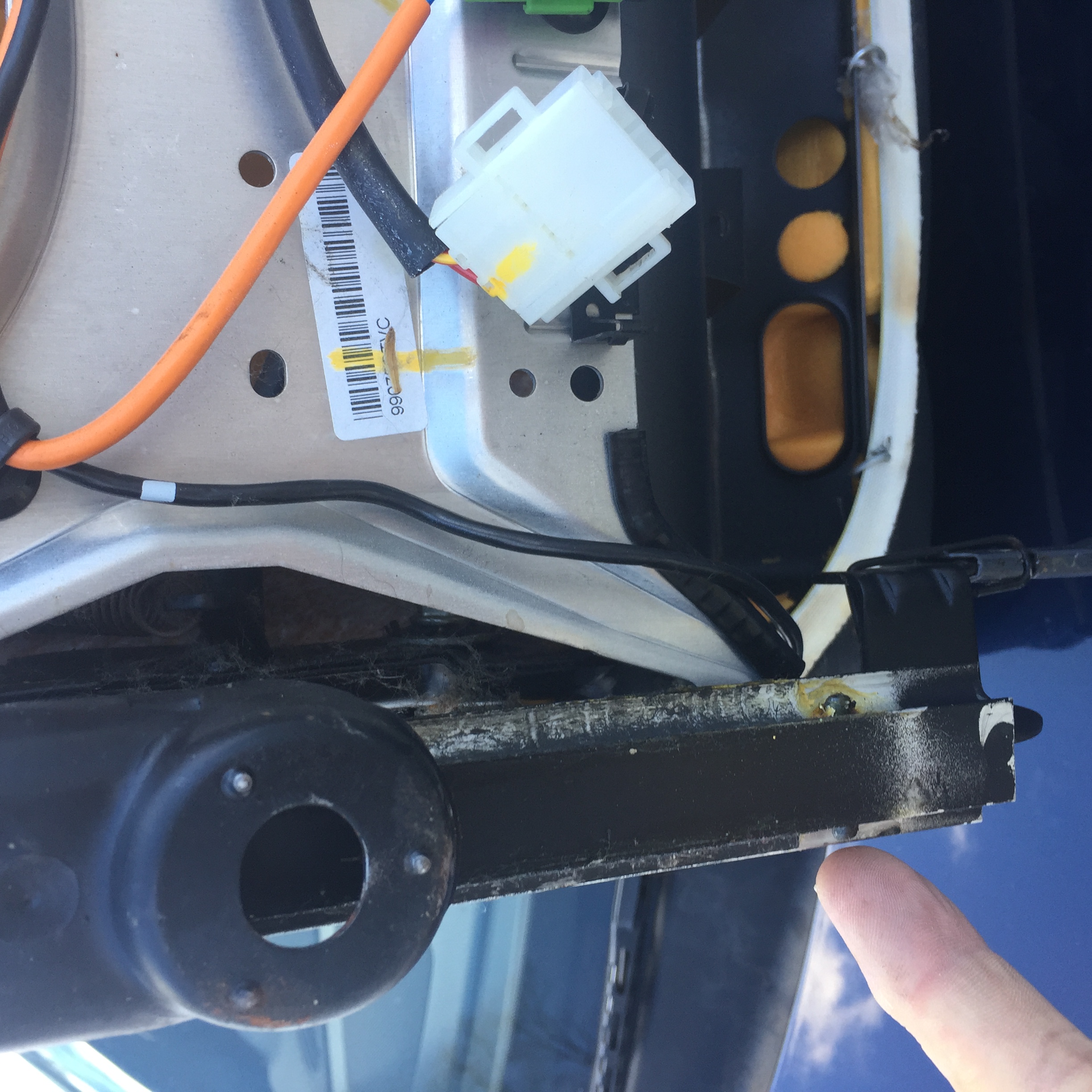

My driver seat bottom is toast and I stumbled into a good P80 passenger seat
I was planning to strip and swap leather this weekend but...
Then thought perhaps I could swap seats
Alas, the seat rails are handed ( chiral, if you want to impress a Greek date) so its a no go.
Until I realize the seat rails can be swapped. It looks like they just are retained with s roll pin
Note the Beetle convertible with the rare P80 hood seat option

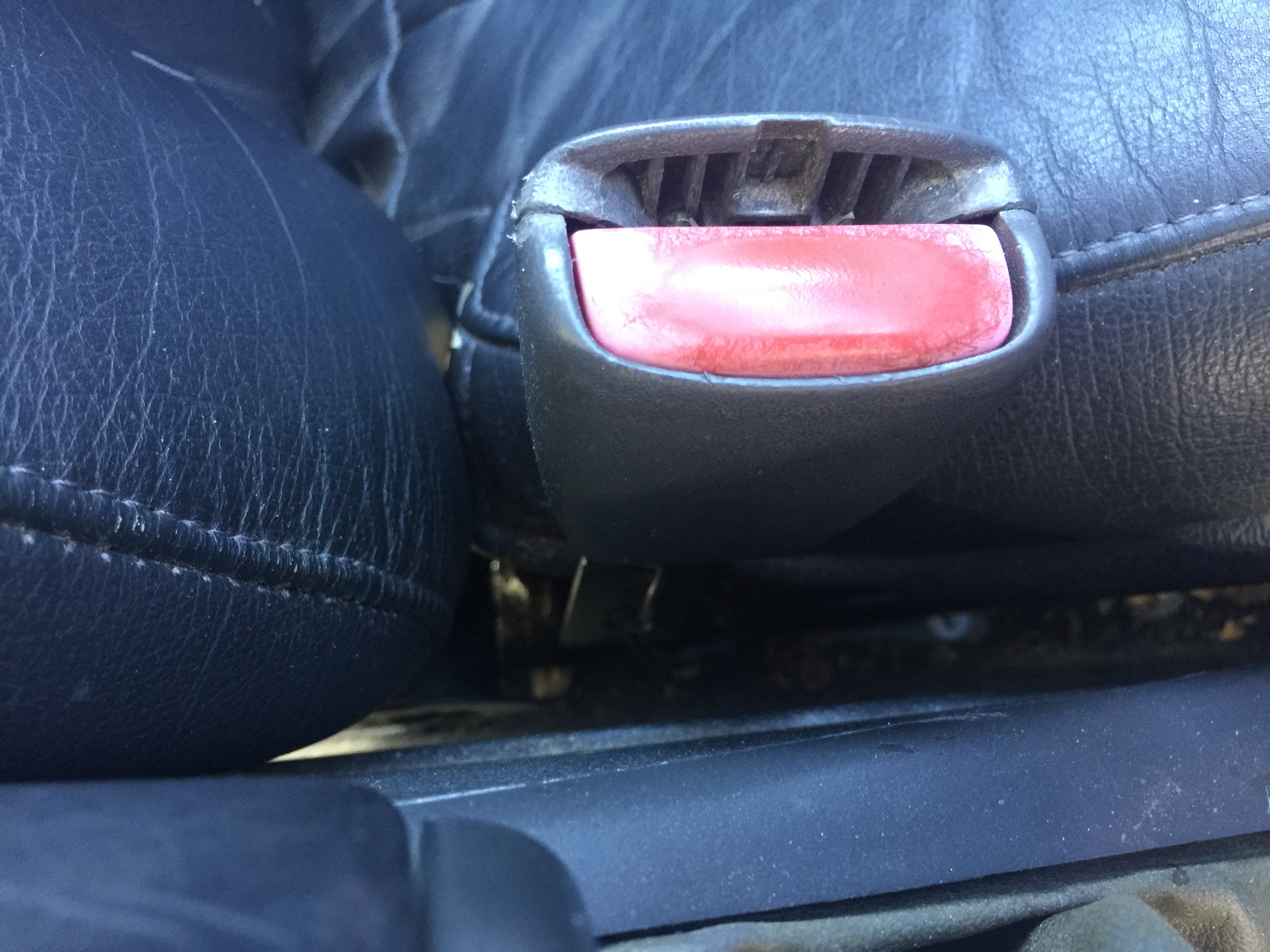

Hopefully seat belt latch and electronics can be swapped , I will lose power seat in driver side, whatever

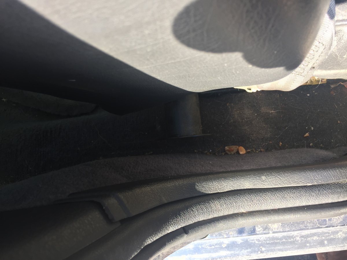

I might getting deja vu all over again. I think you run into a problem with the back seat bottom structural tube, which asymmetrically projects out on the outboard side of each seat. This the passenger side seat will hit the inner console

Also what about the SIPPS Bag? If the seat is on the wrong side won't the bag be on the wrong side of the seat? Juneabscate wrote: ↑17 Mar 2018, 09:44 5DFB9BA7-C304-465A-9C1C-8F5CEEA2038B.jpeg1C0800C1-3562-478E-B1CD-385EC853B030.jpegI might getting deja vu all over again. I think you run into a problem with the back seat bottom structural tube, which asymmetrically projects out on the outboard side of each seat. This the passenger side seat will hit the inner console

June wrote: ↑17 Mar 2018, 09:47Also what about the SIPPS Bag? If the seat is on the wrong side won't the bag be on the wrong side of the seat? Juneabscate wrote: ↑17 Mar 2018, 09:44 5DFB9BA7-C304-465A-9C1C-8F5CEEA2038B.jpeg1C0800C1-3562-478E-B1CD-385EC853B030.jpegI might getting deja vu all over again. I think you run into a problem with the back seat bottom structural tube, which asymmetrically projects out on the outboard side of each seat. This the passenger side seat will hit the inner console
Oh Shinola. Well, here’s this weeks Blooper material
