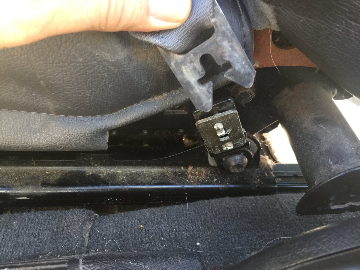

Documenting how to release the outboard side of the seat belt on a 1999+ P80 via picturehe f
The official name for this from Volvo NA. MVS division is the Showell Latch. Send $1 in bitcoin to Evan each time you use it.
P80 front seat belt quick release - The Showell Latch

I loved this when I found out about this a while ago from a specialist. Way easier than trying to remove that Torx screw below it!
