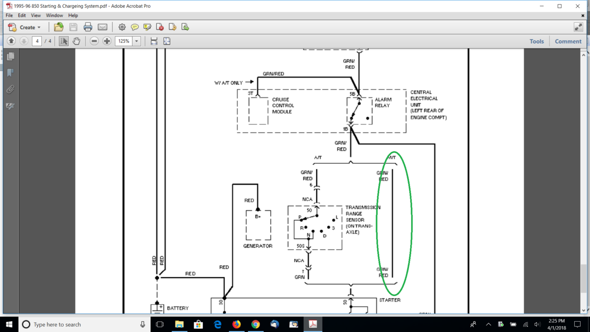

It a '96, is there not a jumper block under the fuse block that can be used to bypass the PnP? It the wiring harness used to bridge the starting circuit on manual transmissions that do not have a PnP. Good for confirming a PnP is the cause of a no crank.

On the PnP switch there is a Green/Red and a Green wire. Place a jumper across the two wires. If the car will crank with the jumper in place your problem is with the PnP switch. If it still will not crank, the problem is elsewhere.
Keep your foot on the brake as you turn the key, the jumper defeats a safety feature and will allow the engine to start with the transmission in gear. I don't recommend driving with the jumper in place. One might end up with higher insurance rates if one forgets.
