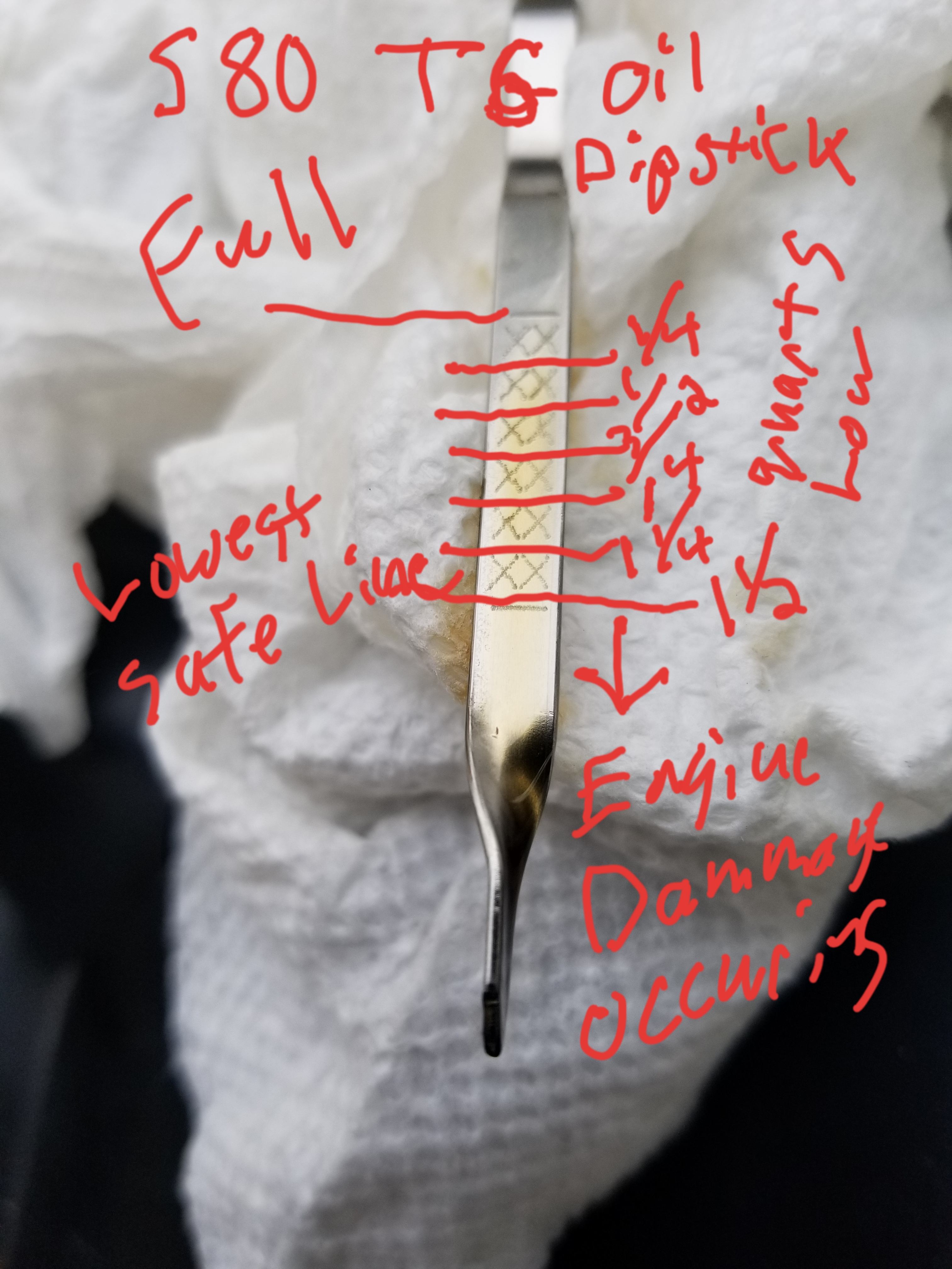

I might point out that if you are getting "low oil pressure" warning you must be running the engine like 6 quarts low! I am assuming you are not aware that if you run the engine with the oil level below the bottom safe line on the dipstick the rings and wrist pins are being destroyed.
If the oil pressure low warning and oil light are on than you are destroying the rest of your engine. So you must keep the level in the safe zone to protect your engine. This is my S80 T6 dipstick and I marked how much oil to add at each XX on the stick. 1/4 quart for each XX. June

My husband used to build mud trucks as his hobby, that included building big engines to run them. The rings and the pins that hold the pistons (wrist pins) to the rod are oiled by splashing. When the oil goes below the bottom line on the dipstick, the oil is too low to properly splash lubricate the cylinders and wrist pins. That will wear the rings and wrist pins quickly due to lack of oil for lubrication.t3yf5g wrote: 29 Apr 2018, 16:03 Oh I know what running with no oil does. You can ask my first truck when I was in high school... lol.
I don't let it run to the oil pressure warning before I fill it back up, I check up on it during fuel ups and add in as it needs. I have a 5 quart jug in the trunk (along with water since I have an issue with the upper radiator hose not seating well) I use up. Then a big absorbing pad and board on my garage floor. Oil leak is on my list but going to be a pain tracking it down. Tried looking once before but lost track around the turbos and heat shields.
I understand some companies (like VW) are fitting oil sprayers for this porpoise, but this does not apply for our engines. June
