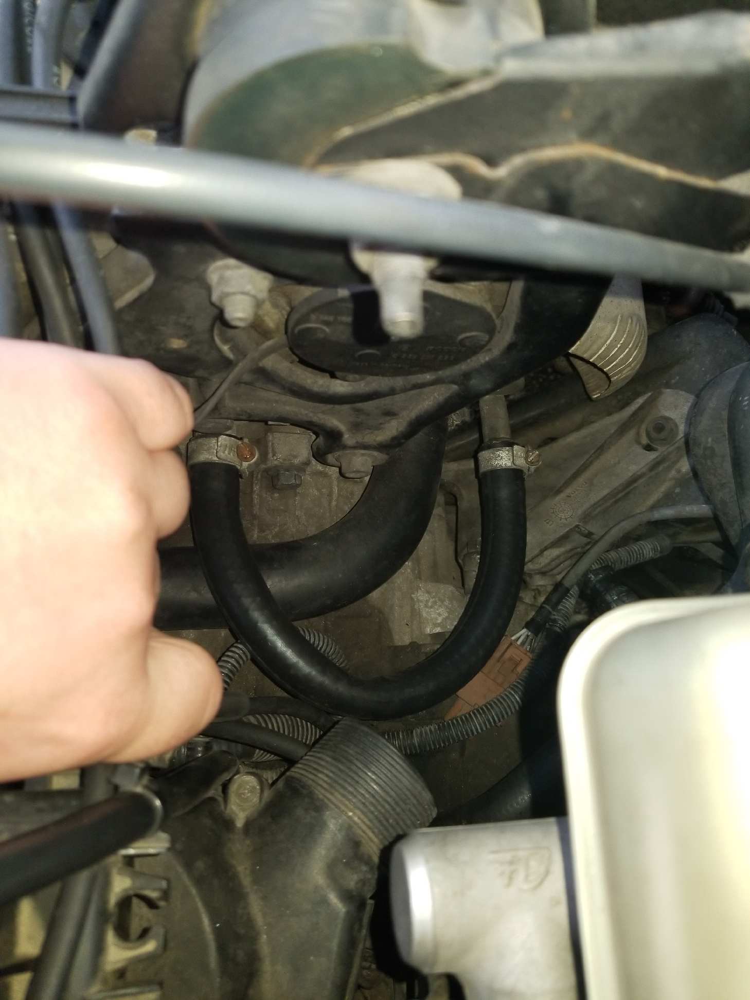

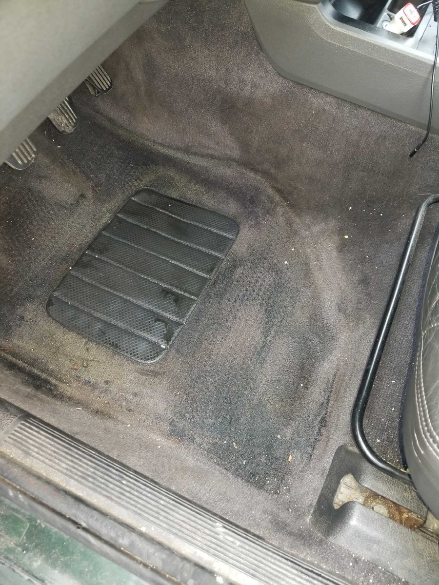

As it tends to happen, right at the end of my shift my car's heater core completely failed. when I say failed, I mean dumped half of the radiator fluid onto my floor boards. :lol:
So I just thought I'd post this quickie emergency fix for anyone else that this happens to in the future.
You will need:
11" of 5/8" ID Heater Hose & a bottle of premixed antifreeze
a 6" flat blade screwdriver
How to Do It:

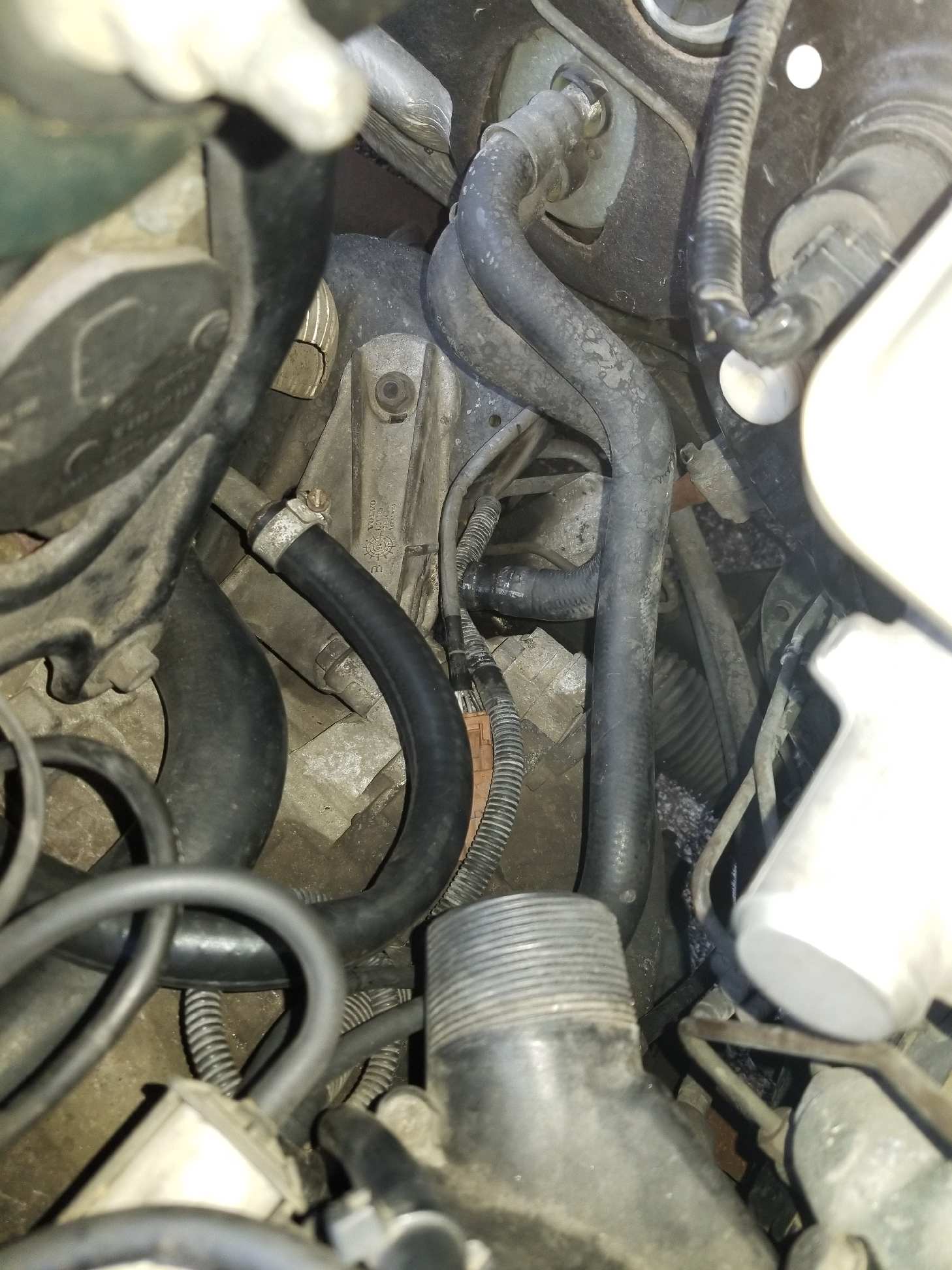

pull off the feed and return hoses from the block to the heater core by loosening the clamps with the screwdriver
remove the old clams off the old hoses
push the heater hoses out of the way
Pop the temp hose in its place with the clamps on the new hose
tighten down the clamps very tightly
Fill the radiator reservoir
start the car,
let it get up to temp with the cap off feeding fluid into it and it starts to gulp it down.
replace the reservoir cap and get it wherever it needs to go.
Technically, you could drive your car like this indefinitely. But, you wouldn't have any heat in the winter.
Luckily for me, I have a brand new heater core sitting in my storage bin and brand new heater hoses that I just didn't have time to do when I replaced all of my other radiator hoses back in January.
So now at least I know how I get to spend my day off tomorrow! :lol:

i had this happen two days before i had to drive to an interview. pittsburgh to detroit in october with no heat.
don't forget to pull all your carpets and squeeze the coolant out of the padding underneath. it won't just dry out. i pulled the rear carpet a year after the core popped and it was soggy with coolant.

j-dawg wrote: 26 Apr 2018, 01:13 i had this happen two days before i had to drive to an interview. pittsburgh to detroit in october with no heat.
That's funny that you say that, because I have to drive about 400 miles on Monday morning to teach a class! I'll be headed up to the local car cleaning place that has a rent a carpet vacuum after I replace the heater core.
