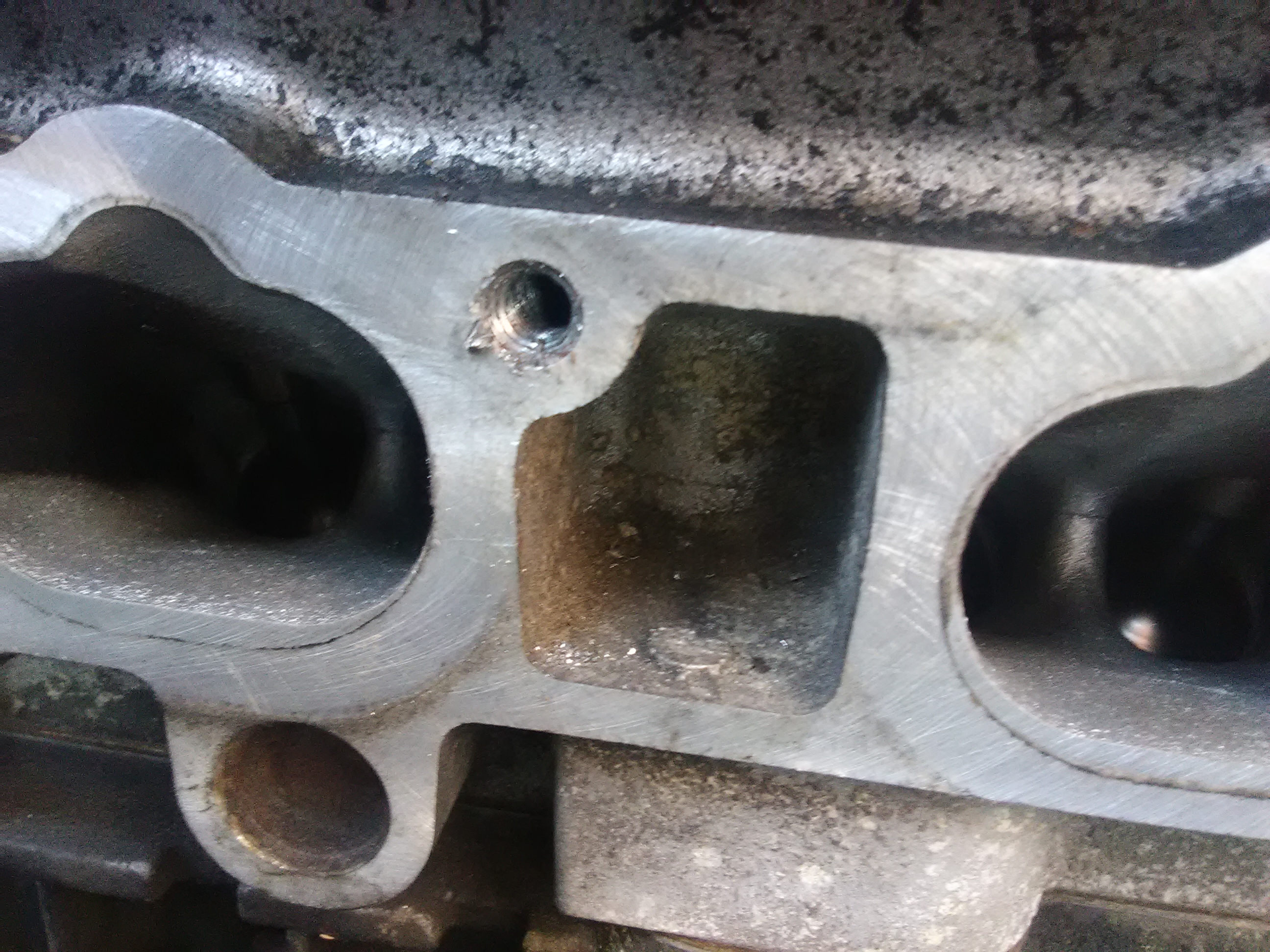

98 v70 non turbo. So here's the story. Just replaced my starter, figured while I had the fan out of the way I would take another crack at my high idle problem, I suspected a leak at the manifold so I intended to retorque the bolts... Naturally I got hasty and set my torque wrench too high. Snapped a bolt in half. Off comes the manifold and I did get the bolt out with a harbor frieght extractor kit, but not before trying to move it with a screwdriver, slipping, and doing a fair bit of damage to the surface on the head around where the bolt goes in. I'm gonna hit it with a bit of sand paper to remove anything sticking up, but do I need to worry about any indentions around there? Also I was considering some rtv to help the gasket seal. Is that an ok thing to do or am I wasting time?

Hello there and do not worry. Just make it smooth and even with fine sand paper and you are good to go. This is nothing. Use regular gasket from Volvo or Victor R.
One more thing - do not ever put RTV on the intake or exhaust. It`s very bad idea. Intake could suck some pieces.

+1, just smooth it out. It's minor enough and not too close to the intake port so it should not be a problem. Don't use any RTV.
