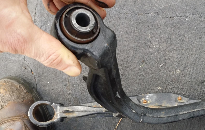

How control arm broke:

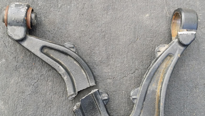

How control arm twisted.

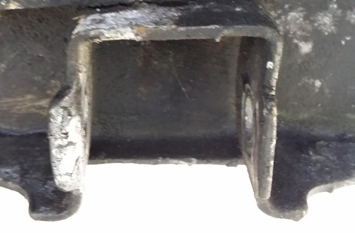

Rear mount To me this looks like it bent rearward.

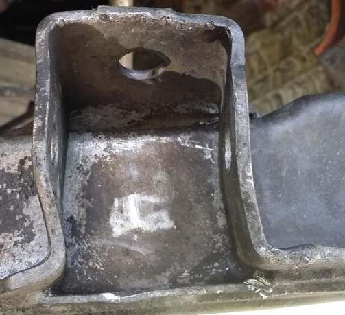

Front Mount This looks less damaged.

Good lord... must have been quite an impact.
I'd try to bend the mounting brackets with a hammer. That could work. I believe this is safe as this is steel, not aluminum (old engineers' saying: what bends doesn't break). Then take the car for a drive and see if it feels safe.

As to the car, the rearmost bracket looks the worst. The sides of the 'pocket should be perpendicular to each other. The bottom left of the bracket needs to be bent down so it looks more like the front of it. Then the top looks like it needs to get flattened as the top should be flat.
With a hit that hard, I would be looking also at the sub-frame mounts to check they are not damaged.
From the picture of the rear mount on the sub-frame, check the welds for cracks. If none, you may have dodged a bullet.
Naturally, when straightening the control arm brackets, check the ends of the control arm will fit snug with maybe a little persuasion to fit home.

Since those brackets keep the control arm in place, you can't see if there are tiny cracks in it that would slowly weaken it. I would ask a specialist in body damage, maybe he could fit new brackets and weld them securely. He can also talk about the subframe and check the other components, steering rack, end links, wheels, etc.
