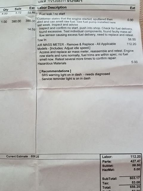

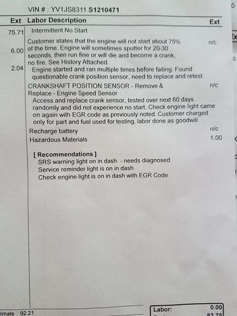

For starters I have spent about 1500 so far on this trash car in the past 2 years trying to figure out this problem. I've taken it to the same place several times now even leaving it there for months at a time hoping they could figure out what the issue is. So far I get it back from them and the issue remains. The car doesn't start most of the time and if it does, it will idle roughly and die after a few seconds or it will idle very roughly for longer and eventually even out and idle smoothly. After driving it and parking it, It will start again just fine but if I let it sit for more than a day it usually wont start again. I've had it towed down to the shop and then while its there they cannot recreate the problems I am having. At this point I want to drive this car off a cliff. I do not have the money to spend more on this car than it is worth, I need to know the exact issue and fix that. I cannot just blindly replace parts hoping it will fix the issue like this shop I am working with seems to have been doing.

These reciepts are not in order, the middle is the first time I took it in, and the top photo is the most recent where all they did was replace the crankshaft position sensor which has not helped anything
