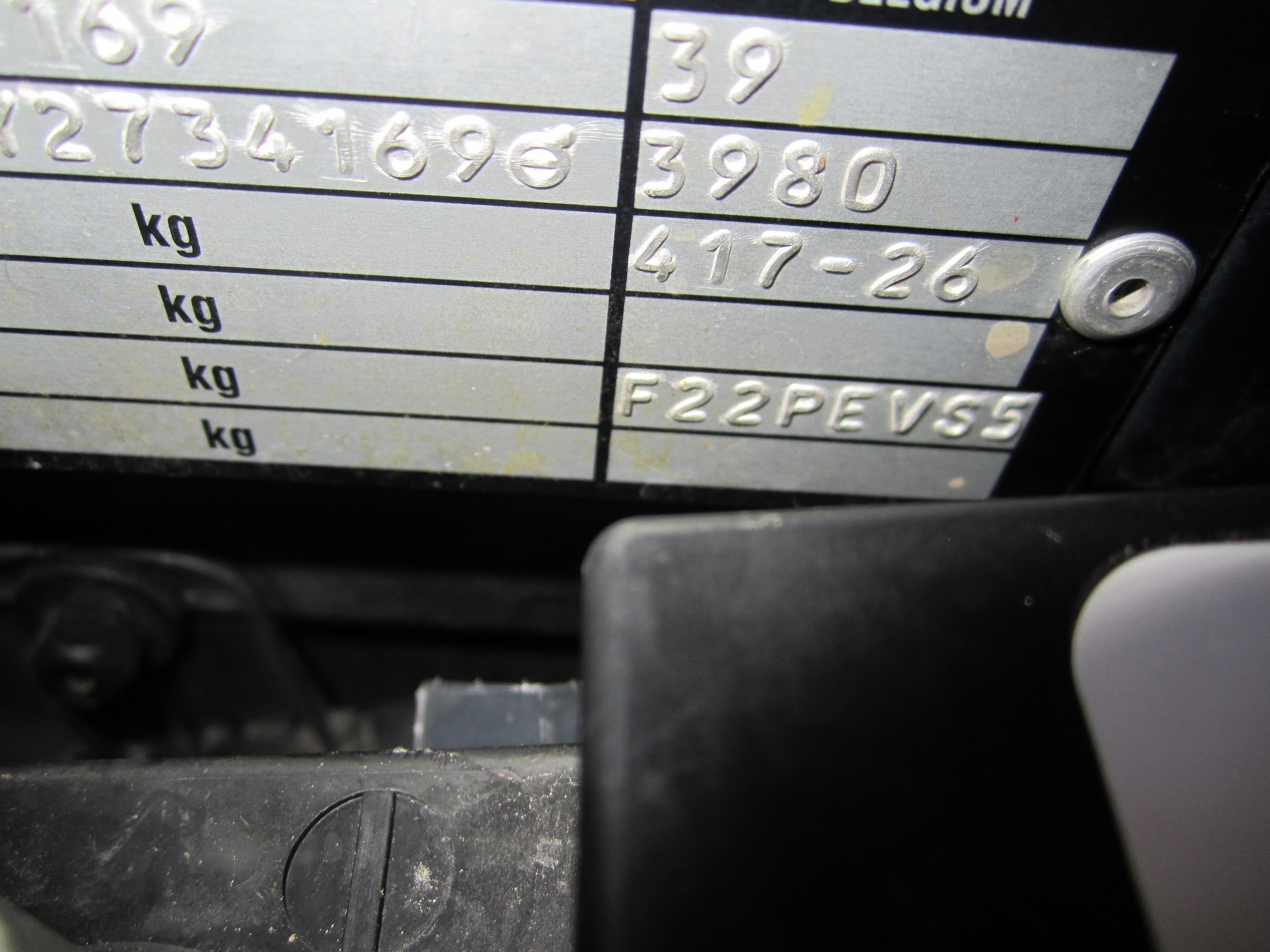

If you are looking for front struts they are not Nivomats. Those are only fitted to the rear to self level when a load is put in the cargo area. Fronts use normal type struts, but as the V70XC sits higher, not sure if it uses a regular struts.
You need to know the code from the chassis plate by the battery on the LH inner fender. It is the first 2 digits of the 8 digit number on the lower right of the plate.
If you check the picture above it is the first digits of the lowest strip of numbers to ID the front shocks. In this case it is: F2
From that code a dealer or anyone with Vida can ID the strut part number for you and then you can see if any of the built up units have that strut included for your application.

If you click on the product details it lists the cars it fits which includes all the AWD versions EXCEPT the V70XC. It fits the 'R' and AWD which sit lower. Don't know what they mean it does not fit cars with self leveling as the 'R' has Nivomats, but not sure on the AWD. I know the S70 AWD I saw in the PnP last weekend had standard rear shocks.
If you check your product plate as suggest earlier I can find you a part number for the correct struts if that helps. I think though it is unlikely you will get a quick strut for a V70XC as there are no longer enough of them around.
