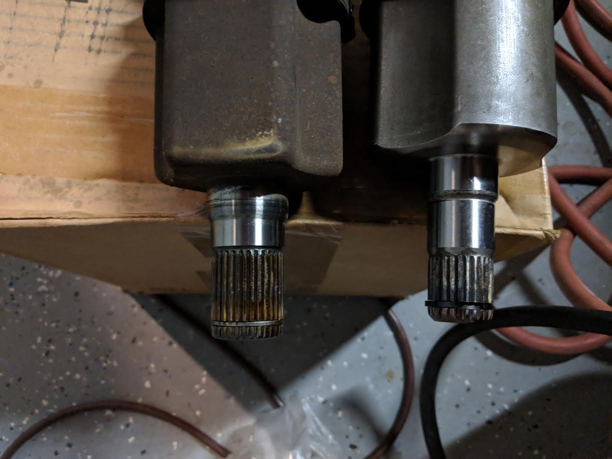

The boot on the driver's axle of my 2008 S80 3.2 with the sport package split and slung all of the grease out. The car had some vibration under acceleration so I decided to go ahead and replace it instead of doing a new boot. I ordered the first part from Napa and the axle I received had smaller spline shafts on each end. Took it back and they said they didn't have any other part numbers for it. Decided to order a Cardone model from RockAuto and received it today. Same problem, smaller input shafts.
Is there a special axle for the sport package that is a little bit thicker?

The V8 and T6 have the same part numbers. The 3.2 is different. Something tells me if you order a T6 or V8 axle it will be what you need

I looked at a picture of the part, and sure enough, the T6 or V8 axle is the one I have. Odd that my 3.2 would use that transmission. Is that part of the sport pack option?

Just to follow up and put the information in the archives, the V8 axle was a perfect fit. Maybe when the buyer added the sport package it triggered the upgraded axles? Who knows!
