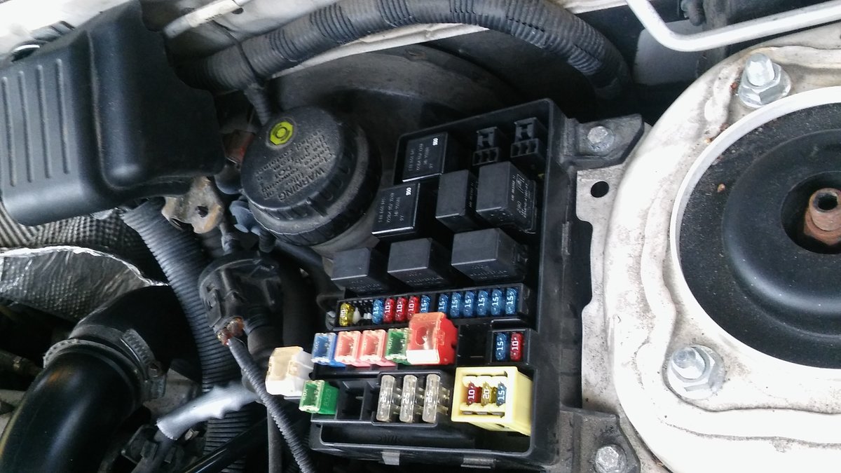

It will not start, we did hook it up and try to jump it last night, and still just err err err, fuel pump is making the hum, he thought he would change the filter just to be sure, and he was talking about replacing those coils, so I will let him know your suggestion on that. Already changed three small parts and it was a pretty penny. Not looking to keep guessing. Do you know where the fuel pump relay is on the fuse box, the book does not mention it at all.

A video with sound of the car trying to start might help the people on the forum.
The cover of the fuse box should have a diagram to where fuses are located. Did you see that?
