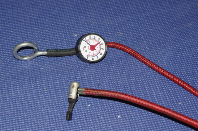

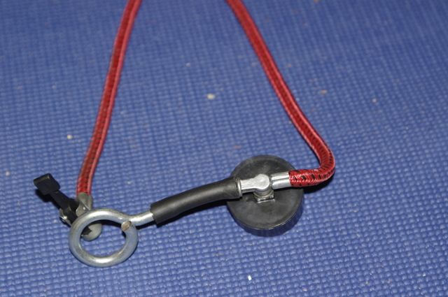

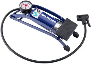

Before you even think about buying a new fuel filter establish once and for all whether you have the correct fuel pressure or not.
Buy a cheap foot pump at Walmart, I'm sure they sell those. See pic below:
Unscrew the manometer and hose and discard the rest. -Then do like in the pic below using a piece of fuel line and a suitable bolt.
The idea is to block off the coupling that normally would be attached to the footpump's hydraulic cylinder.
Now you can test the fuel pressure by hooking it up to the valve on the fuel rail. It should measure 44 psi or thereabouts.
If the pressure is reasonably within spec. - don't worry about a fuel problem . . . ever.
