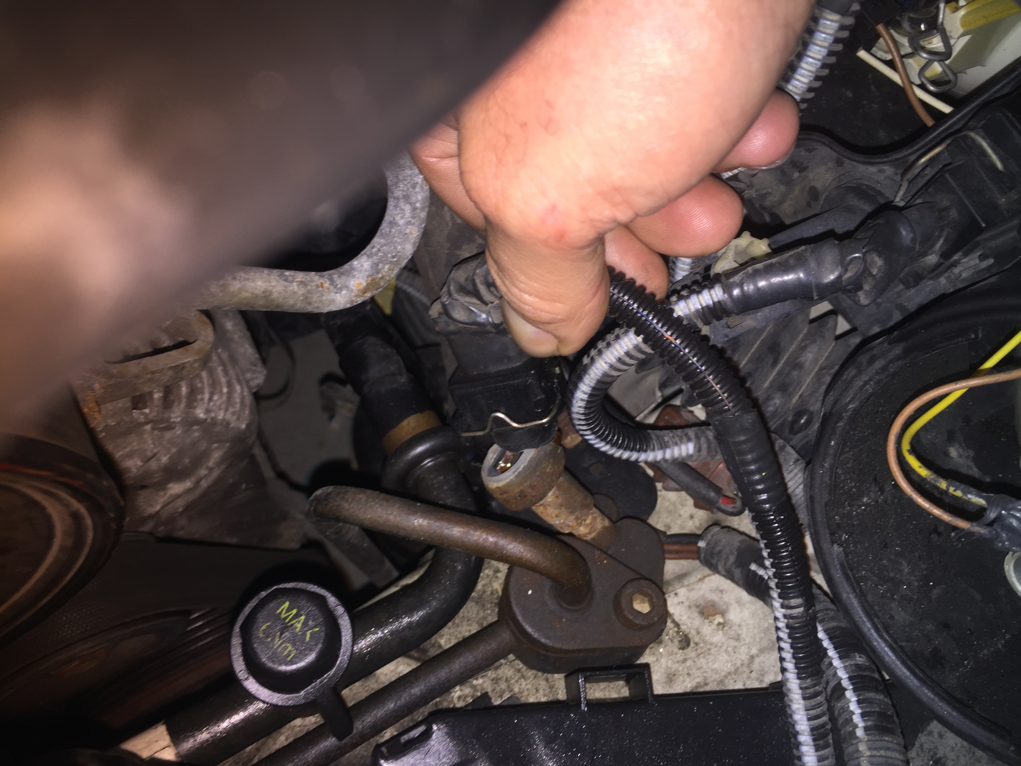

pb49415
- Posts: 52
- Joined: 30 Apr 2018, 11:23
- Year and Model: 1998 S70
- Location: Fruitport, MI
I think I found a little problem.......the wire connection to the high pressure port was completely severed from the sensor. When I reached down to disconnect it. Must have been broken before I got the car a few years ago. I’ve never used the AC. A least the car was essentially a trade for a dirt bike, so it didn’t cost anything out of pocket. Not looking forward to forking out the $$$, but it’s necessary.
. From my understanding, the sensor unscrews from the Schrader valve, correct?
- Posts: 36153
- Been thanked: 4068 times
I put some info in the other thread. It’s a resistance measuring plug, not an on off so jumping it won’t help. It needs to send good info back to the ECU to convince the ECU to turn on the AC
Use the high pressure switch part number to search
30767231, 8628563
But it should be near the top of the Forum
30767231, 8628563
