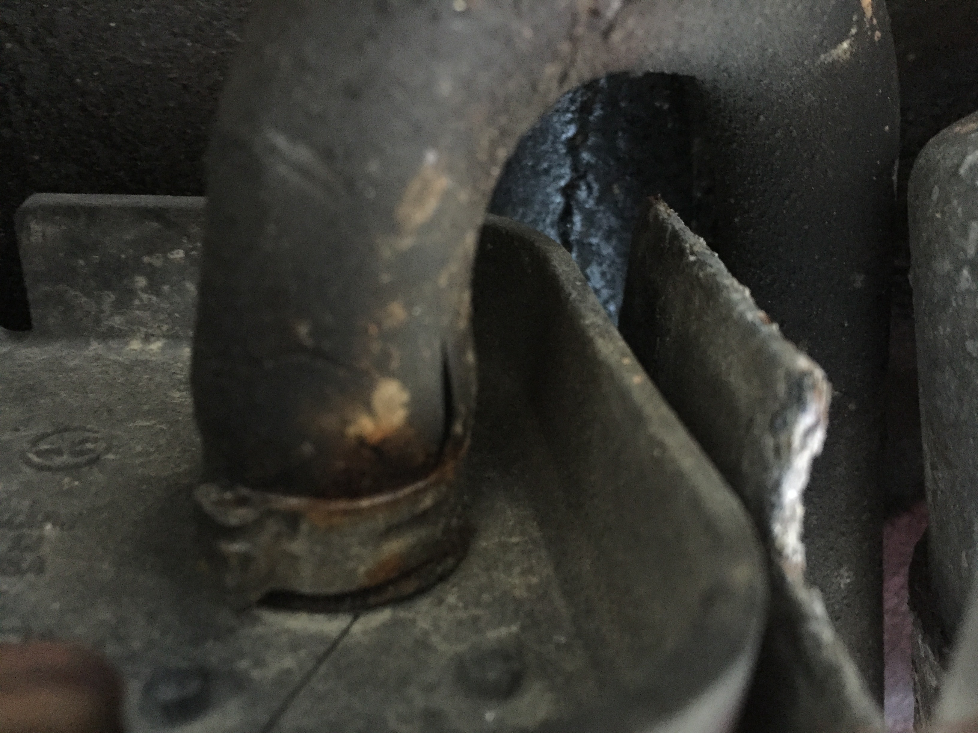

UPDATE: so I found a crack on the J hose. Let's not talk about how much of a pain in the azz it was to remove those factory cramp hose clamps in one and half foot of clearance...
But anyways, would a small rip by the clamp cause it to throw a gross evap leak code? I have yet to get the J hose from ipd because no parts store has it around me.

A large leak on the Evap system is anything larger than 1 mm.
That split will cause P0455, yes.
That factory clamp makes it likely that the hose is original from 1998!

+1 on agreeing that is probably the source of your leak. I was fooled on one of my cars as it was split only on the top side out of sight. Once replaced it was ok. It has to be replaced anyway before you can be sure that is the only issue.
Dealers are expensive, but if you are in a hurry, most should be able to get it next day. I used to be able to get stuff from FCP in 2 days to Western Canada, so try them also.
