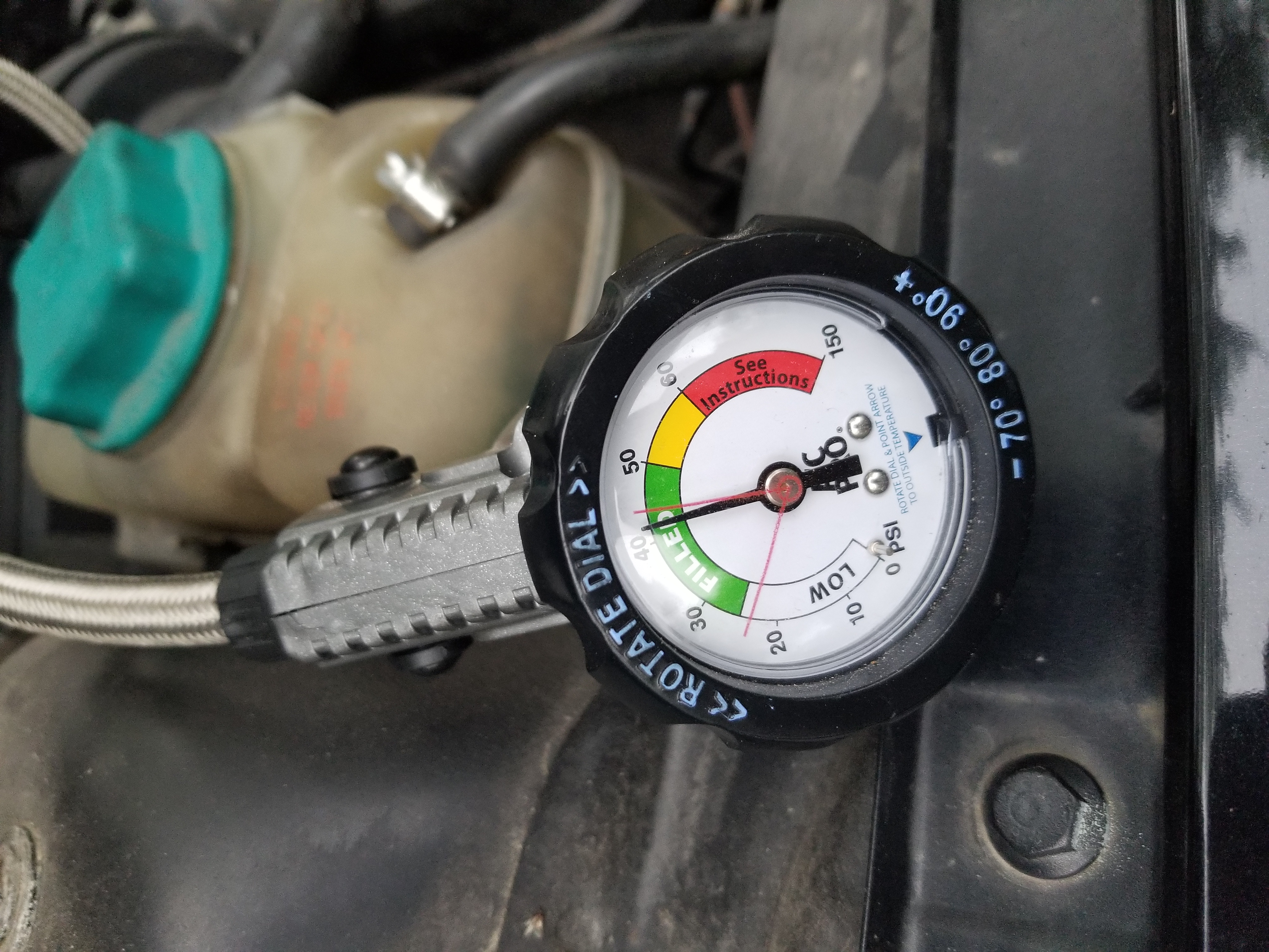

Issue: On warm days (over 75) my AC will start blowing cold and then start blowing warm air. On days under ~75 it will blow cold on all settings and seems to work great.
Last fall I recharged the system because the air was not blowing cold and the AC compressor would cycle almost constantly at idle and would make a very distinct 'click' sound when coming on and off. After I recharged the compressor cycles VERY slowly at Idle perhaps as long as 60seconds but the distinct 'click' sound is less pronounced.
I have tried to find information about what the low pressure numbers for the S60 should be but haven't been able to find anything. The information I have found is usually a single number for lowside, my lowside bounces between two numbers as the compressor cycles.
Information.
-AC Compressor gap is .3mm (checked with feeler gauge)

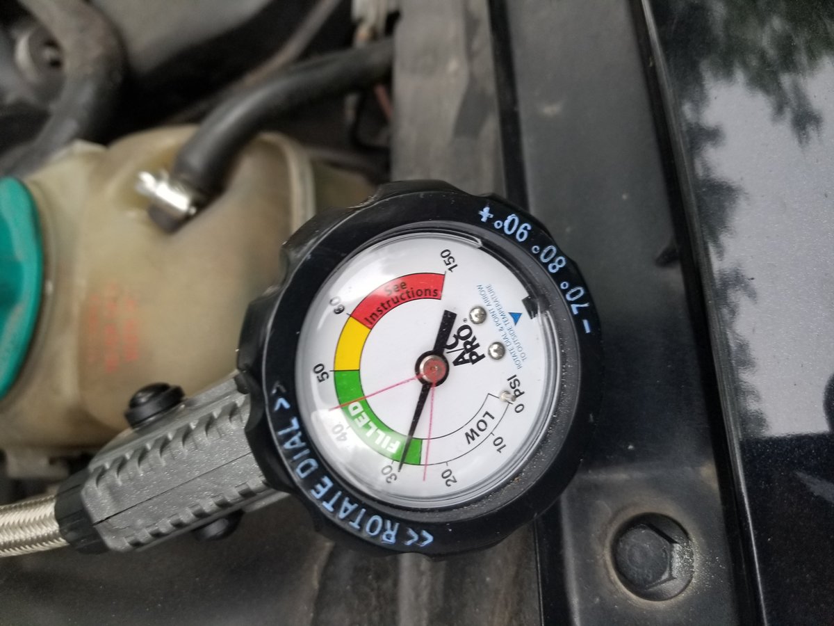

-Lowside pressure when idling bounces between ~29psi and ~40psi
Do I need to add more refrigerant? My lowside pressure is right between the 'fill lines' on the gauge but I do not know if those are universal or apply to Volvo.

Do you mean, it blows cold, then warm, then cold again and so on? Does this correspond with the clutch plate spinning and stopping?
Same with the needle, does it bounce related to the clutch engaging/disengaging?

oragex wrote: 02 Jul 2018, 10:56 Do you mean, it blows cold, then warm, then cold again and so on? Does this correspond with the clutch plate spinning and stopping?
If it is hot out, it will blow cold for ~3-minutes and then blow ambient/warm. The only way to get it to blow cold again is to turn it off for awhile and then it will blow cold for ~1minute before warming up.
The needle does bounce between high(40psi) and low(29psi) as the clutch cycles on and off. Perhaps I just need a recharge? I do not know what ranges are required for the s60.

That really sounds like the typical clutch issue, assuming the gap is fine, may meant the clutch is worn out - still check the small wire to the compressor just in case is not secured properly. The clutch magnet is influenced by the temperature of the compressor, as the clutch gets worn (or gap gets too large) it loses strength and disengages when the compressor warms up while it's running, causing the air to go warm.
As for the pressure I'd say is fine, 30 psi with the clutch spinning is your low pressure value and is just about right (when it stops the psi goes up, it's normal)
