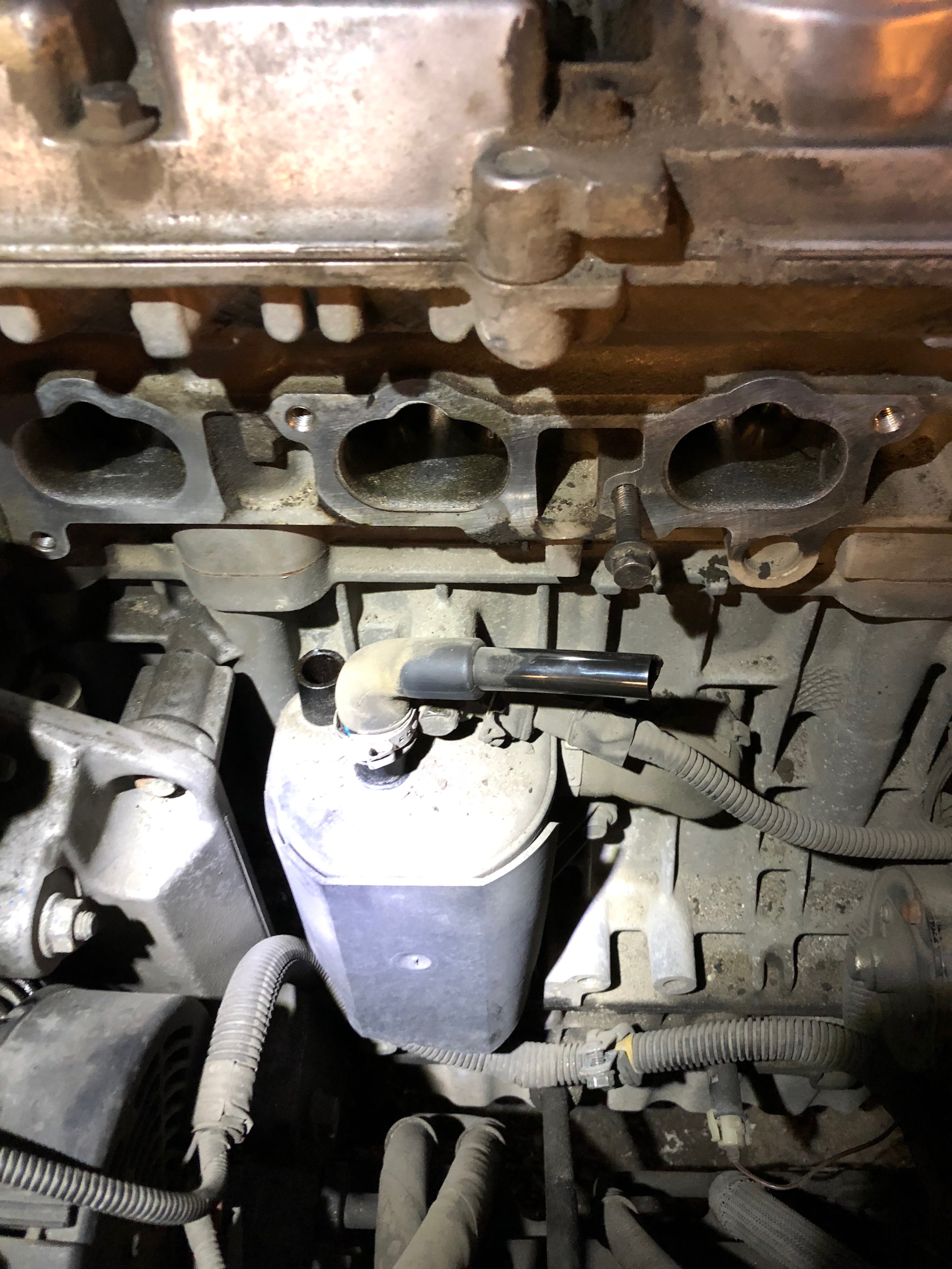

Did you clean the ports? You also need to take the PTC off an make sure it's clear, both through the top and the port on the side for the smaller hose from the intake manifold.
Here's how the hoses go - the broken hard plastic line is to PTC/intake. The empty port is to the top of the engine through the gaps in the intake manifold:

That is how I fixed it. I cleaned the ports but maybe not deep enough? I didn't use a ziptie (as robert diy recommends), nor did i blow air into them.
