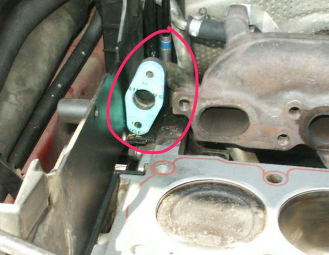

So after a full head gasket job on volvo 850, the last bolt I put in, I managed to strip the lower bolt hole of the coolant pipe on the back of the head next to the exhaust. It just spins and spins! I think I cross threaded it and mashed the threads.
Is there any possible bolt replacement that has slightly larger thread than the M7 x 1 that goes into the coolant pipe hole?
has anyone done this and found a fix that doesn't require complete tear down and a helicoil or similar? What a mess!

As you can kill your engine with a coolant leak I would fix it right. How much space do you have to get a tap in there?
As MDK suggests using an American equivalent may be an option. You need to see what the biggest bolt you can get into coolant pipe is or better yet enlarge the coolant pipe hole before installing it - then pick your bolt size. Make sure what ever size you pick - the bolt head can be seated all the way down without interfering with the pipe. You may have to switch to an allen or torx head here.
Visualize and dry fit the scenario before electing any approach. Right now is the time to think everything through.
Measure the depth of the current hole and the length of the current bolt. If the replacement bolt is too long it will strip out the head threads(this could have been your original issue).
Just measure the depth and take your time. The tap should go in straight without much issue. Due to limited space it may take a little longer. Clean out the hole with some carb cleaner or equivalent.

There is a pathetic amount of space to work with but if I can put a bolt in I can tap it I would think. Hopefully the coolant pipe itself can support and 8mm or 5/16th boltSuperHerman wrote: 05 Jul 2018, 17:44 As you can kill your engine with a coolant leak I would fix it right. How much space do you have to get a tap in there?
