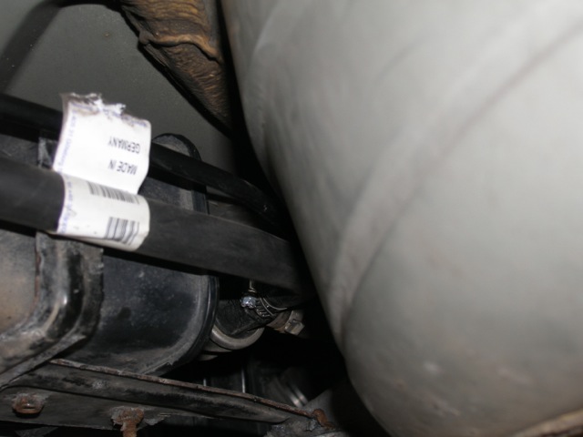

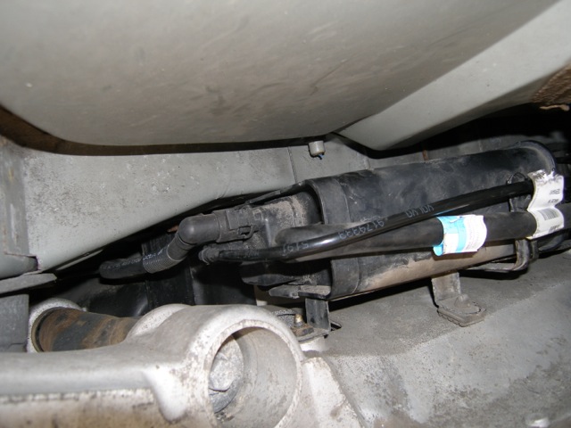

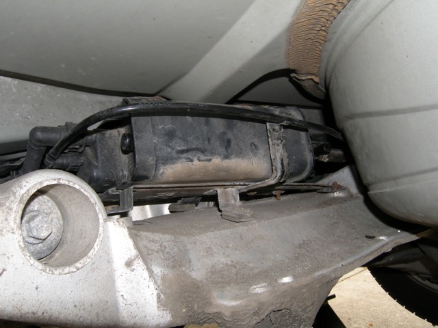

To abscate: All 4 pictures I have have been sent. The downward bulge to the right in these pictures is the spare tire well.
