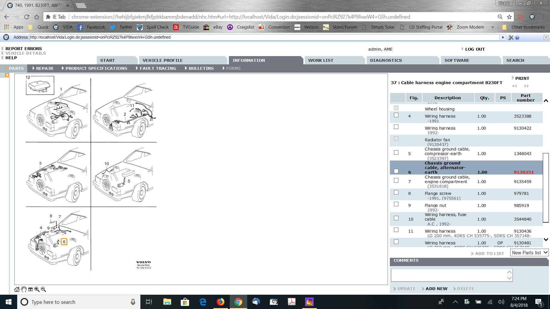

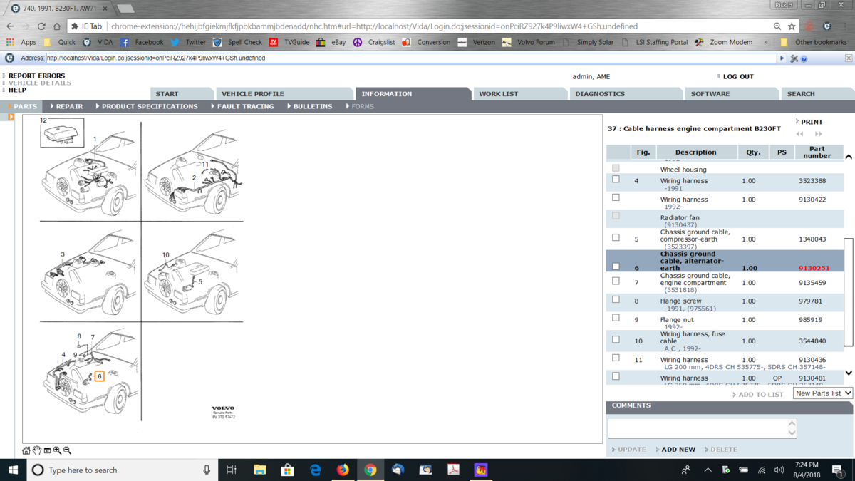

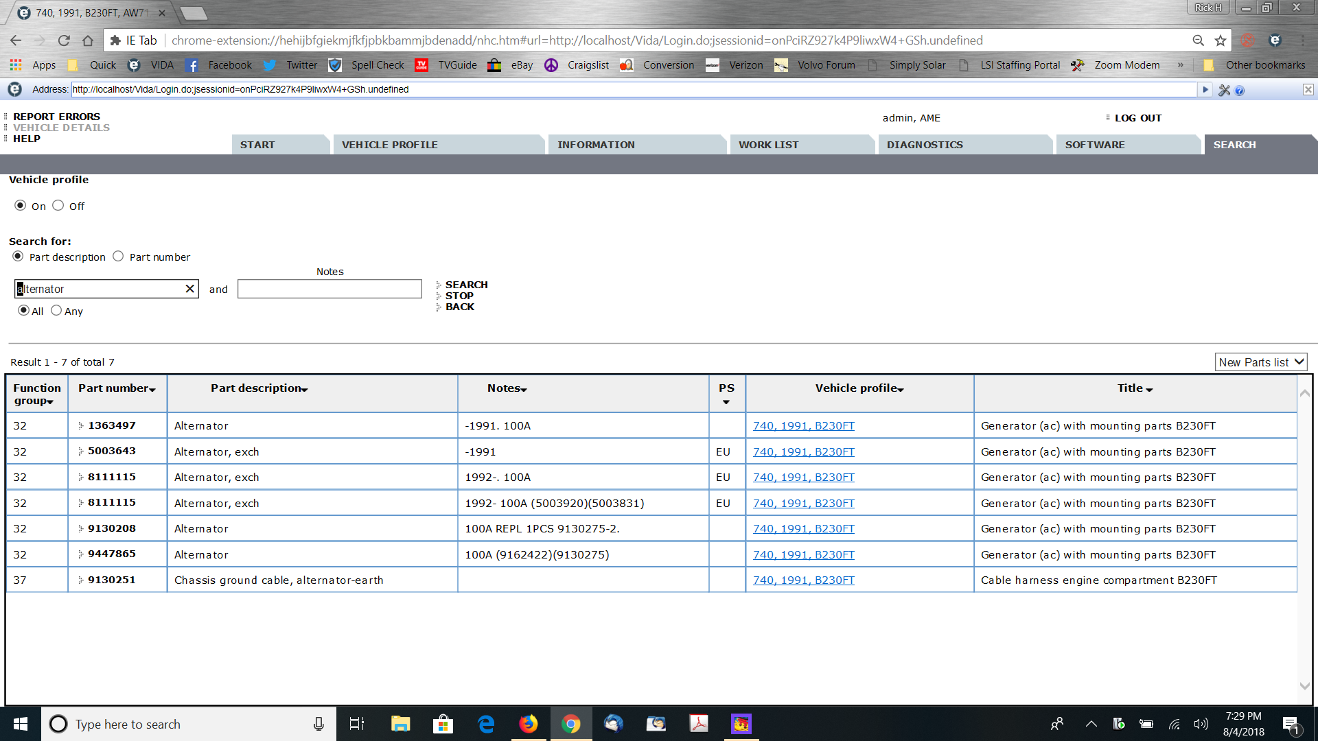

There is a short ground wire from alternator to the engine or the alternator bracket. That alternator mounts with rubber bushings and the arm that holds it tight to belt is also rubber mounted. Since it is rubber mounted it will not make a circuit to charge without the red wire to battery cable @ starter and the ground wire both connected.

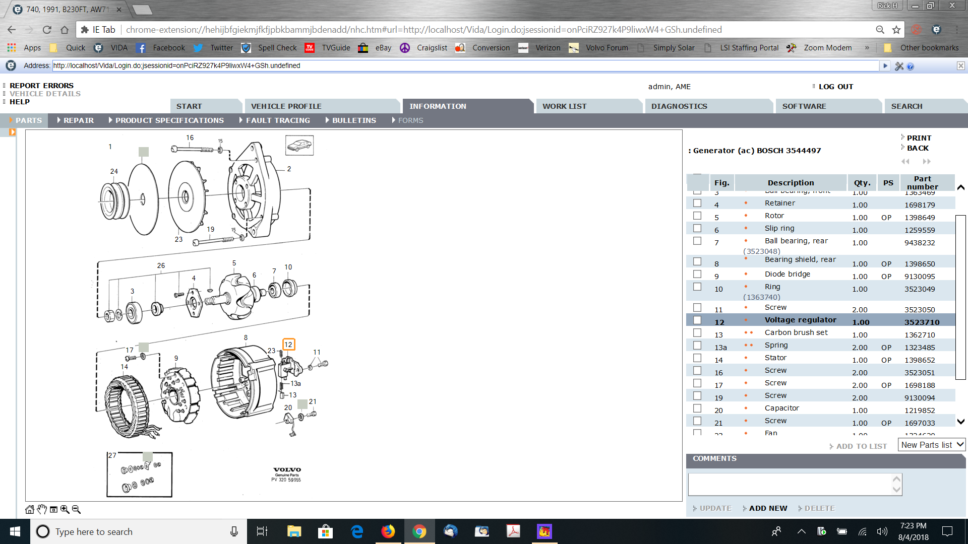

The voltage regulator is built onto the back of alternator. You should have the warring lights with the battery lamp lit when key is first turned on. The alternator and its voltage regulator need the light circuit working in order to charge properly. The wire for voltage regulator is a skinny red/white stripe wire (unless the harness has been repaired) and should be slid onto a blade terminal on back of alternator. If there are two blade terminals it should be on the one with "B+/61" stamped next to it, not the one marked "W" if that alternator even has the W terminal.
