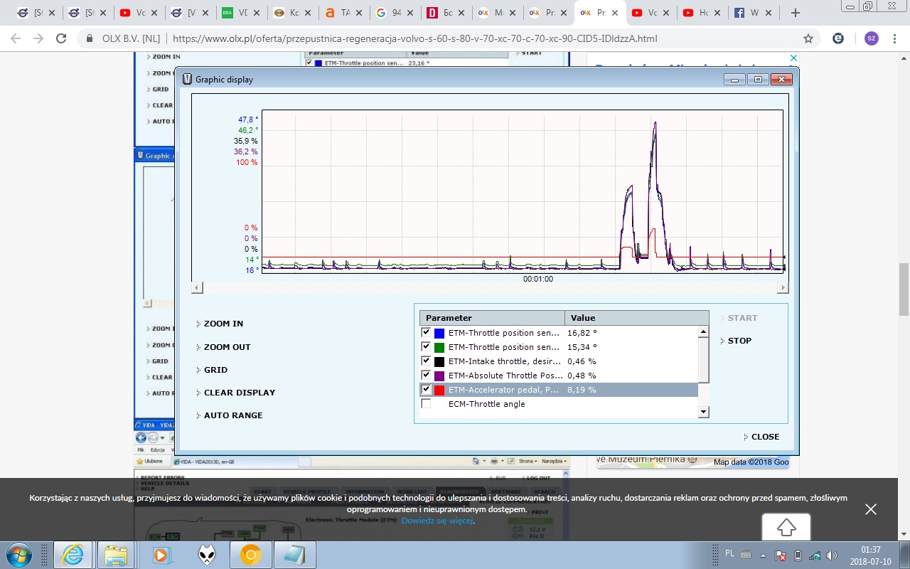

I have strange problem with my throttle (Megneri Mirelli). From couple days I have error code - ECM-9150.
I have VIDA but cant do a ETM test because i have old software.
I make a test and i thing my results are OK. The car dont have typical throttle problem symptoms.
Firstly i wanted to change by myself TPS - posision sensor but i'm not 100% sure is that a problem.
I dont know what can i do with it.

9441158 Relay, try to replace it.

Msa001 wrote: 11 Jul 2018, 15:17 9441158 Relay, try to replace it.
You think airpump relay in CEM relays box?

Ecu relay gives voltage to etm and other components. Some have cured etm problems like you have replacing this relay. The relay is cheap.

Msa001 wrote: 12 Jul 2018, 14:34 Ecu relay gives voltage to etm and other components. Some have cured etm problems like you have replacing this relay. The relay is cheap.
I changed relay but nfortunatelly didnt work. The error still return after 3 driving cycles. I have no idea what i have to do. I dont want to change ETM or the sensor till i have sure is that problem.
The car drive ok.
