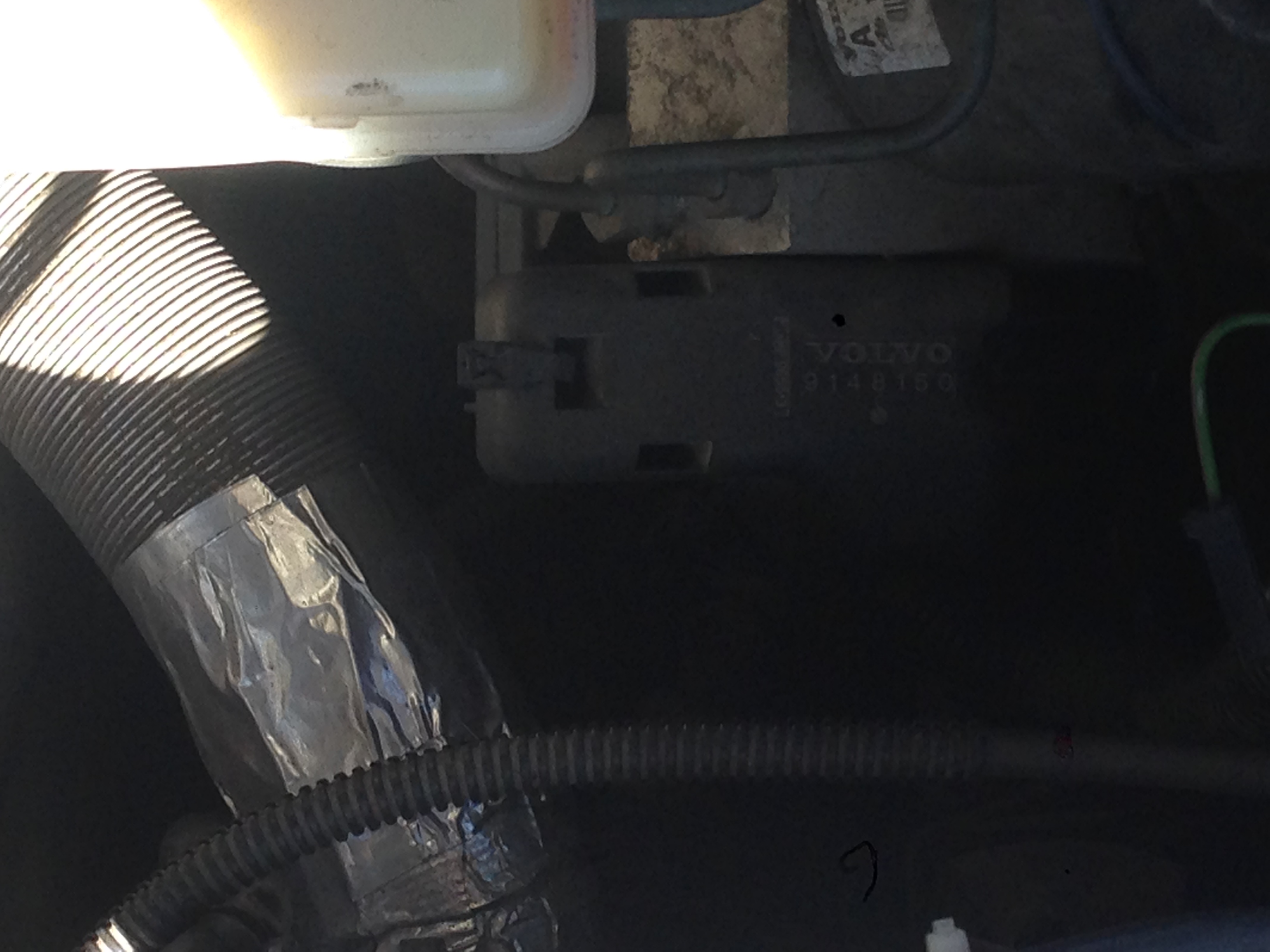

I've been reading around looking for a visual of "Crank sensor / engine speed sensor" and am getting a lot of results that look like something else entirely, the plug I played with plugged right into the engine block, on top of the transmission housing. Two prongs, reversible..
now that I'm reading that the speedometer is connected to ABS (which was also left unplugged, and I also plugged back in at the same time- for sake of keeping gunk from flying into it) .. I realize I don't know what that blue plug is, and I just took it and flipped it around for no reason? (What was I thinking?!)
I'll post up a picture later tonight of the plug, its really easily visible / accessible, I hope it has something to do with timing and is the culprit of all this nonsense.. if only all repairs were as easy as unplugging and replugging it back in..

The crank sensor is mounted right on top of the transmission bell housing, with a white connector that is usually mounted to bracket just above.

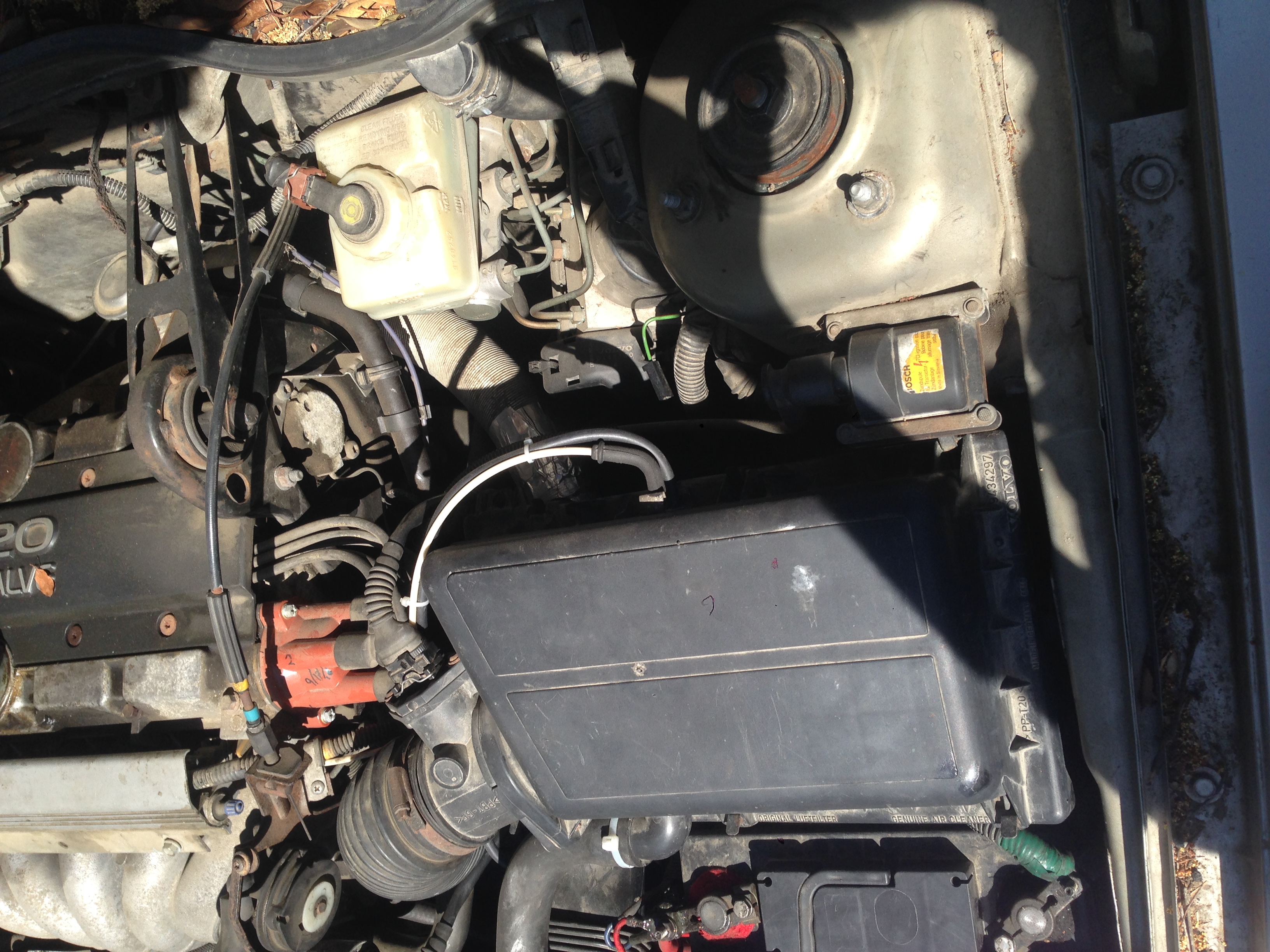

That’s not for the crank sensor. The crank sensor has a smaller, more narrow two-terminal connector, nearby the distributor cap.
Hmm... can you see where the wires go?
Edit- It’s kind of hard to see... is it damaged? It could possibly be the crank sensor connector, but it’s usually situated on the front side of the engine.

it doesn't feel damaged, and it is a 'two-terminal connector' if by that you mean it has two live prongs that corrospond to a socket of two holes
(It may be damaged now that I've reversed it, although, the fact that it's so easily reversible makes me think it's arbitrary which way its connected.. or maybe its that some part securing its entry one-way has broken off.. it does come off and on suspiciously easy compared to the rest of the plastic socket plugs I've found on my volvo)
