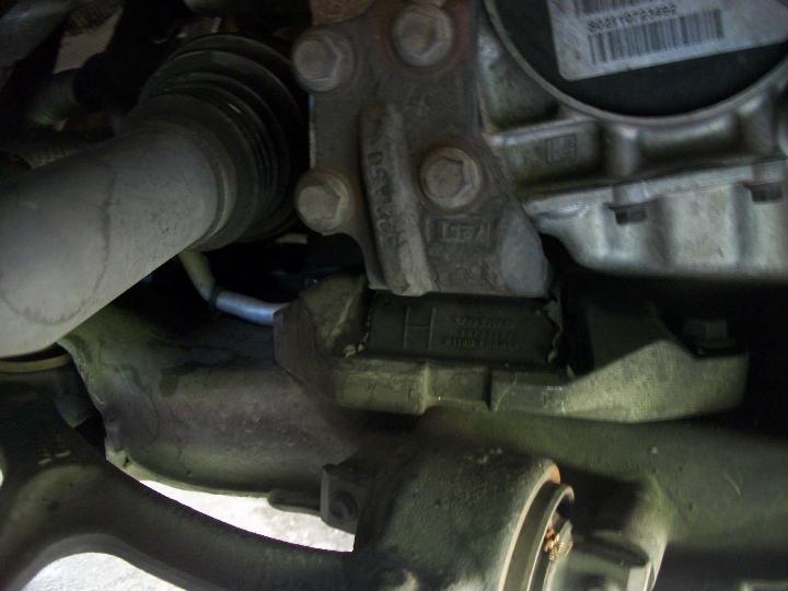

Here is the mount (08 xc90 3.2 right lower). You can see the head of the forward frame bolt right under the engine. The head of the rear frame bolt is barely visible on the left. Of course, the four engine bolts are clearly visible.
I was able to get a socket+extension+torque wrench on the rear frame bolt with minor interference at the inner CV boot (visible in the photo). Indeed, there is not much room to swing it but I believe I can get at least one ratchet click.
My bigger issue is the forward frame bolt on the right of the photo. The engine will need to come up about two inches for me to get the torque wrench and socket in there. If I leave the axle attached at both ends, that will elongate it about 1.5 inches further from its already-elongated state with the hub hanging down (tire off).
I'd like to avoid undoing the axle but will do it if I have to. If I remember right from when I did the LCAs, I'll need a new axle bolt.

It's different than the S60. Can you undo the 4 bolts on the engine side, then lift the engine some 1-2 inches ? Survey the power steering line that's passing right behind, maybe protect if with a piece of wood from getting crushed. (there may be other pipes in the area as well)

Yes, I am pretty sure I can undo the 4 engine bolts (as well as the two torque bars on the right side) and lift the engine. My main question is whether that is going to elongate the CV axle so much that the joints fall apart.

That,s the long one, right? With the bearing carrier. The joint near the bearing can elongate without problems. But safer to jack the wheel hub under the ball joint, this way the axle will have plenty of movement available.
