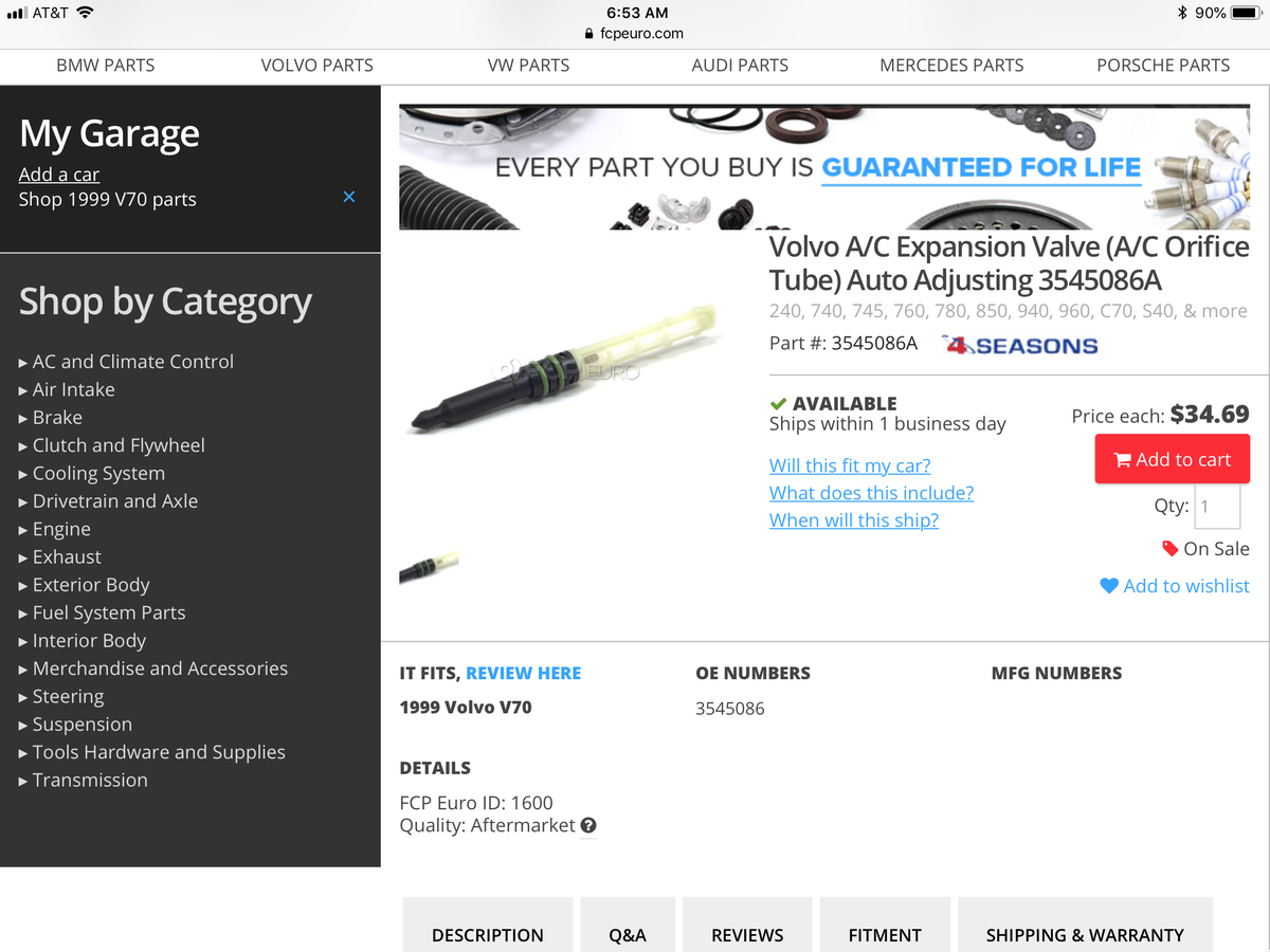

Also, there is an adjustable orfice valve at FCP that I will ask them about and post here.
1999 AC job. Rein over nissens, adjustable orfice valve

Feedback on the Variable Orfice Valve, or VOV from FCP
Variable orifice valve's look the same as fixed orifice tubes, but are able to change output depending on different operating conditions. A fixed orifice tube is really a compromise between highway performance, stop and go, and idle performance. This is because at idle, the condenser has less air flow across its surface. This causes head pressures to increase, but also causes vaporized refrigerant leaving the condenser to enter the orifice tube.
This is because at low speed and idle conditions, the refrigerant is moving through the condenser very rapidly sending high temperature vapor and liquid to the orifice tube. Subcooled liquid entering the orifice tube is ideal for flooding the evaporator core of a cycling clutch orifice tube system. Vapor entering the orifice tube will reduce the effectiveness of the refrigerant.
With a VOV at idle, a bimetal control spring blocks off one of two ports, reducing the flow of refrigerant and allowing more heat to be removed in the condenser. As speeds increase, the valve opens back up allowing maximum flow through the system again. This improves performance over a fixed orifice tube at low speeds and idle, while still providing a high level of performance at highway speeds.

Don't bother with the variable orifice. Mike stuck one in a 2003 Ford and it failed in less than a year. The ac blew colder with the fixed original. I wanted it to blow colder and apparently Ford makes five or six color coded orifices. The 2003 had a orange one originally, than the variable orifice, than he put a green one in which made the difference in hot traffic. I believe by changing to green the orifice had a smaller opening causing the air to feel colder, but the compressor cycled more which made no difference to a V8. June

I would love to try this but the orfice valve sits inthe hard lines so replacing it is a real b******
