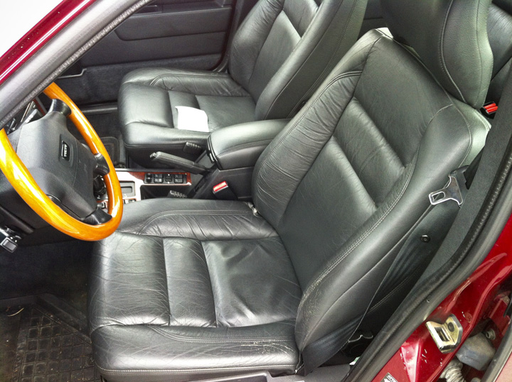

this is basicaly the standard seats which im not to fond of. I know a lot of guys are going to swear at me for this.

- Posts: 36148
No swearing at people here.
There might be some seat options in the Performance Fora or Maybe even Swede speed?
We do like the stock seats over here.
