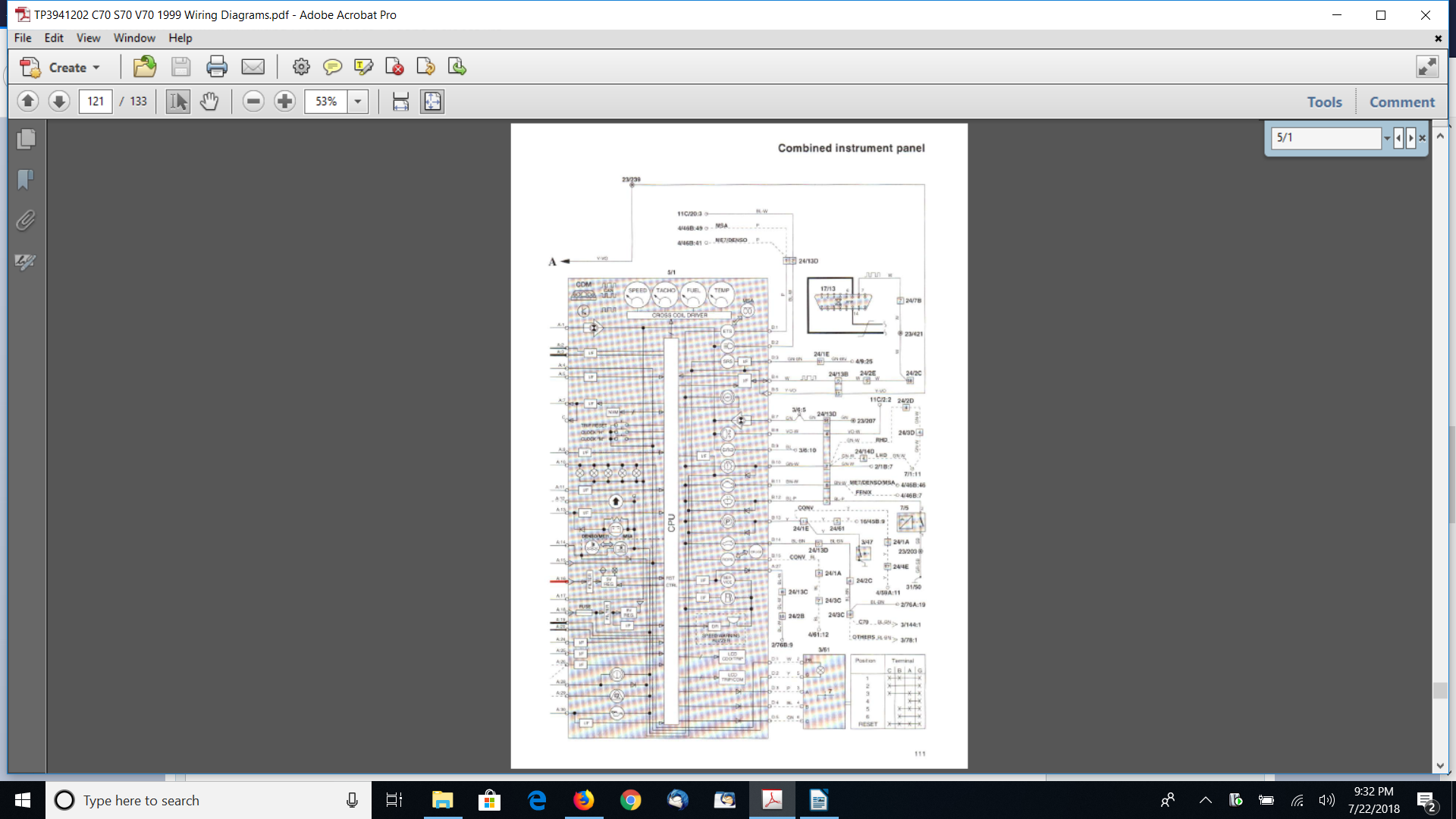

Hum .. from what I can gather the odometer records are stored in the CDM/DIM.
Could it be that his CDM/DIM has lost it's sanity and the ABS module is fine.
I do know there is a signal in the CDM that is 12 cycles per revolution of the wheel and can be used for accessories. There is also a CPU in the CDM. it seems to be a rational assumption the the CDM CPU uses the 12 cycles per revolution to calculate the distance. If the 12 cycles per revolution where off, the speedometer should be off also. If the speedometer is correct, that would indicates the data from the ABS is good and the defect lies in the distance calculations.
The CDM CPU also turns the indicator lights on and off, if it had mental problems it could very well turn on the ABS and Brake lights when there is no problem with the ABS or Brakes.
I might just lose the bet, good thing I did not wager.

Interesting. I am going to pull the ABS unit and send to Midwest first to see if that resolves the problem. No harm in spending the $80 even if the unit is OK (it likely won't be for much longer).
If this does not fix it i'll look into CDM/DIM. The speedo is generally correct but it jumps while accelerating. Not nearly as concerning as the odometer issue - not many 20 year old Volvos with less than 100k so I'd like to keep it that way!
I'll report back - thanks for the help!
EDIT - it does not appear the CEM was implemented yet in 1999.
Pat
