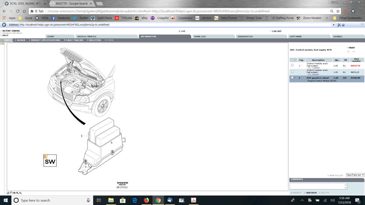

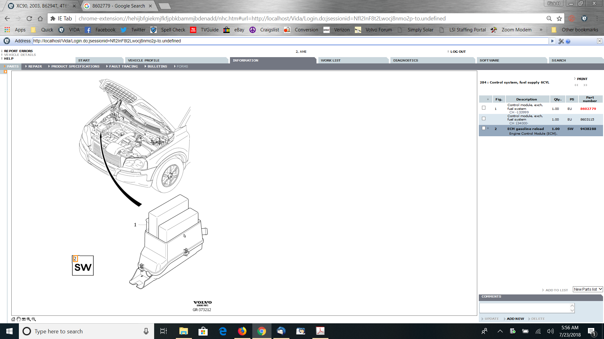

Post by SuperHerman »
Are you sure that your car has a FPR? From what I am seeing it does not - but hey, I have been wrong many times.
Can you provide more symptoms of your problem - maybe you have a bad fuel pump or filter?

The XC series uses a pressure sensor on the fuel rail and electronics to regulate fuel pump duty cycle , NOTO a vacuum controlled FPR like P80 cars

On the 2003 XC90 the fuel pump and fuel pressure is regulated by the ECM. However if the fuel delivery system cannot deliver enough pressure for one reason or another, all the regulation in the world will not bring it up.
