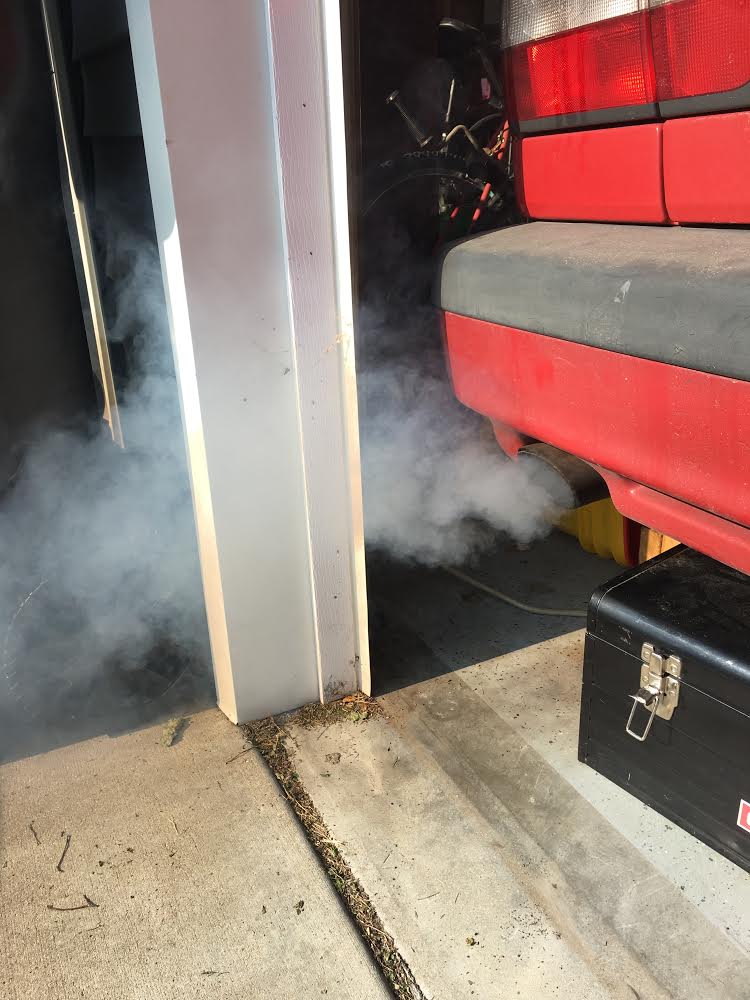

The coolant system held pressure. I oiled the cylinders and it fired right up. However, the exhaust was still smoky and smelled like fuel. I'd say I am back to the status the car was at in January. I checked that the injectors were mechanically working again. They were. So now I am thinking that it could be the injector electronics or ignition electronics. There definitely seems to be unburned fuel in the exhaust.

How far have you driven it? After being parked that long and the problems you found I would expect it to smoke badly for the first 20 miles or so.
Did you ever isolate the problem with the oil and coolant mixing? If you never definitively found it I would put a breach in the oil cooler in the radiator at the top of most likely suspects list.
