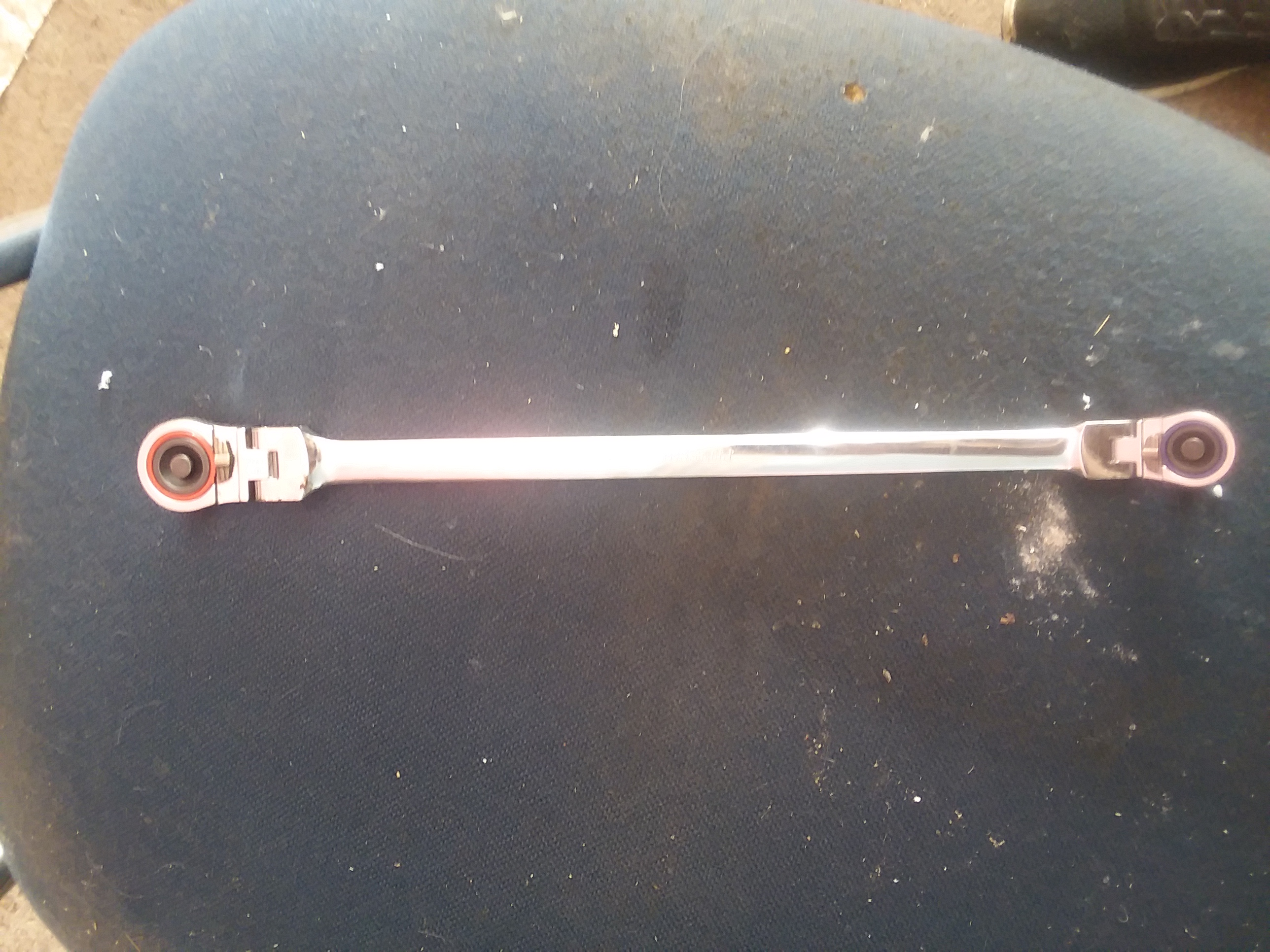

An offset box end wrench is good for control arm bolts.dlundblad wrote: 22 Aug 2018, 03:49 This post makes me wonder if I should hoard a spare turbo just in case.
How'd you like that skinny ratchet anyways? I actually bought one for the S60's control arms since space is so limited, but I needed leverage. Thankfully on the most stubborn bolt I was able to use a 3/8 breaker bar after raising the engine a bit and just kick it loose. Not sure if that ratchet could have taken the abuse or not, but I've removed lug nuts with it issue free as well.

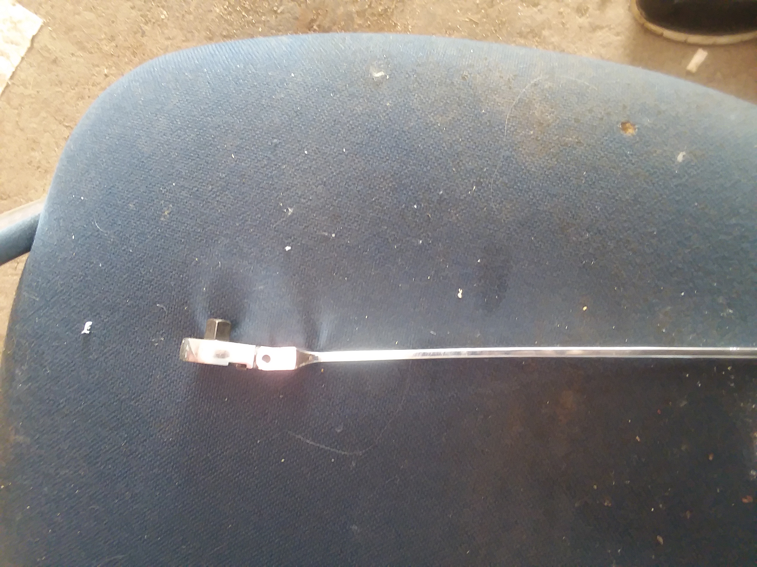

I tried them, but no luck. These were very rusted I guess.jonesg wrote: 22 Aug 2018, 04:04An offset box end wrench is good for control arm bolts.dlundblad wrote: 22 Aug 2018, 03:49 This post makes me wonder if I should hoard a spare turbo just in case.
