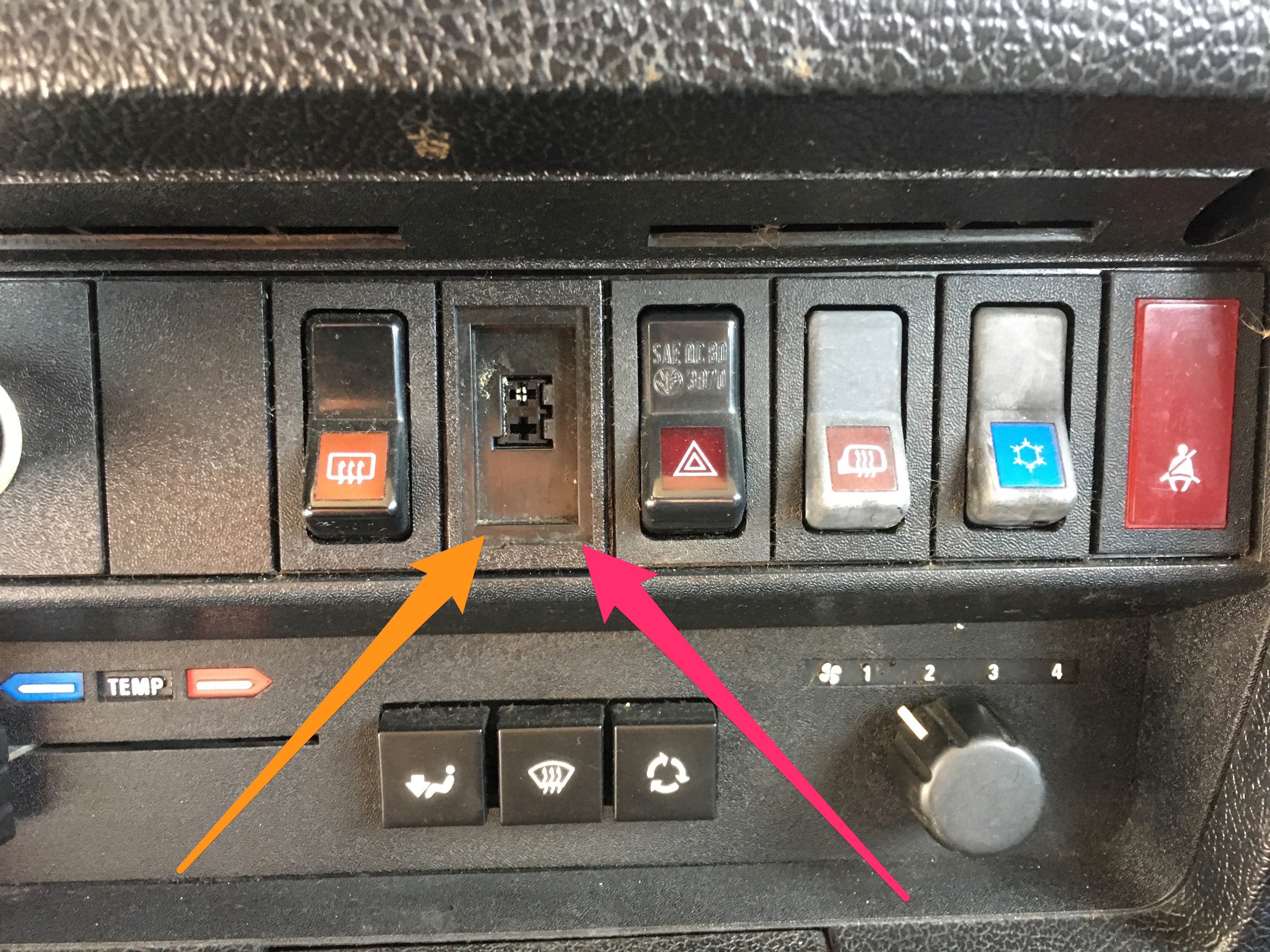

Greetings! Trying to locate what this switch is - aftermarket or OEM? The Google revealed no results and hoping you might be able to. Many thanks.

It is the SRS (airbag) diagnostic access port. You insert a wire lead and ground the wire to access flash codes for the faults. There was a black plastic cover inserted that has "SRS" embossed on it.

Terrific. Thank you so much.
