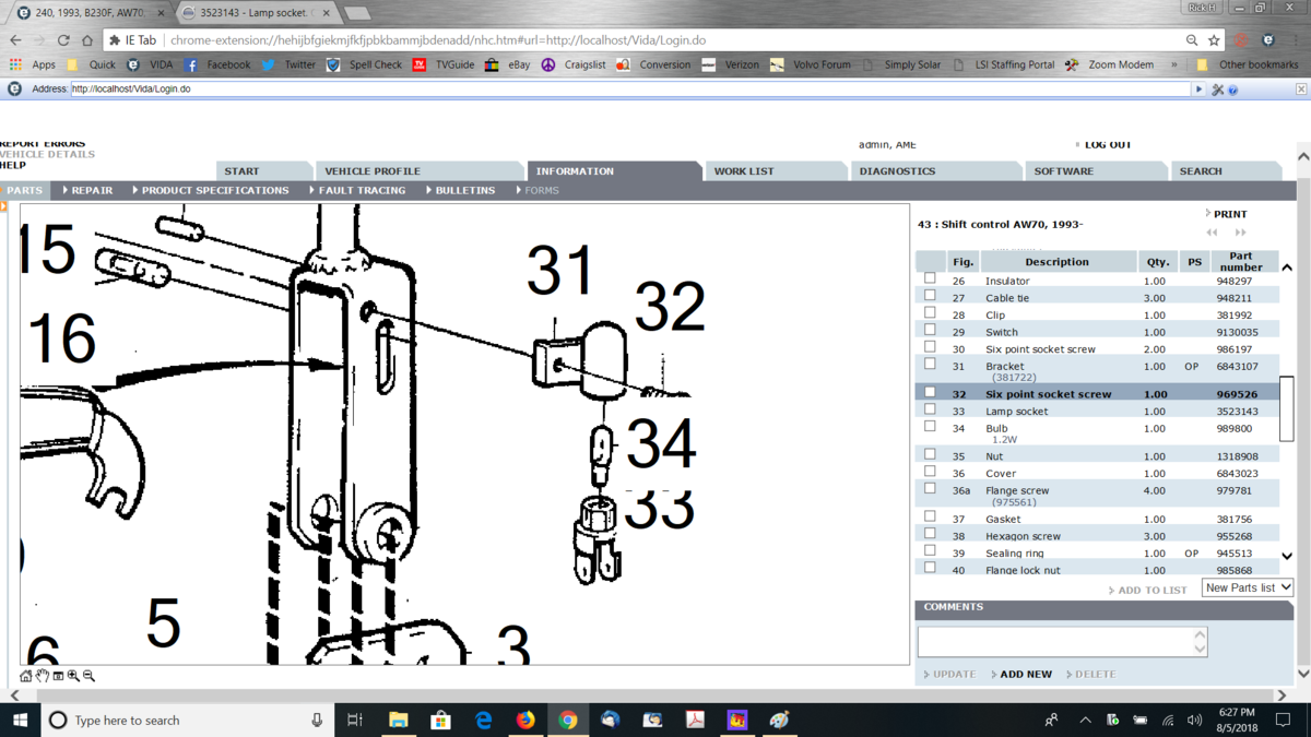

It looks like you got everything there.
- GR-54853_48.jpg (6.27 KiB) Viewed 2025 times

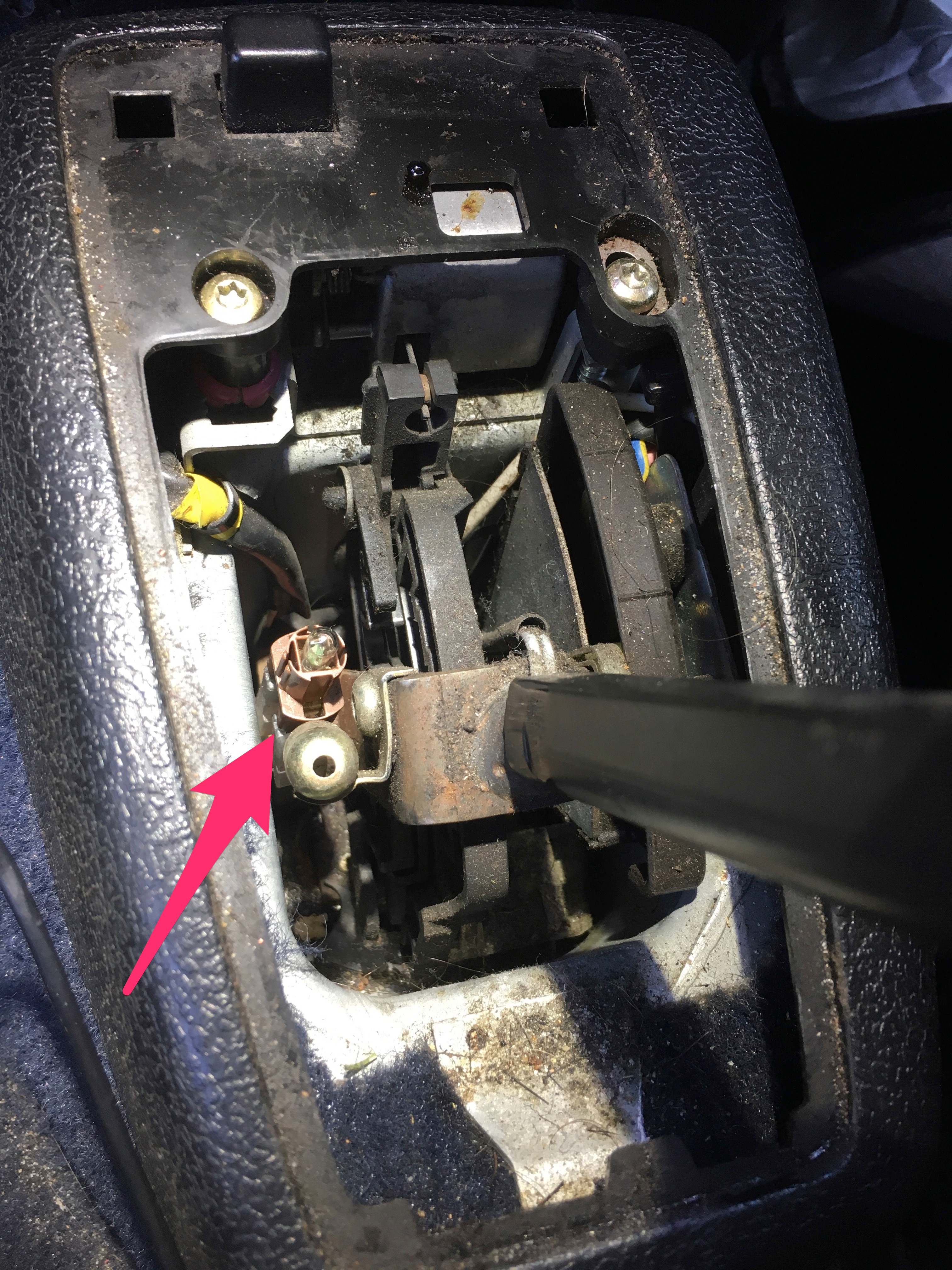

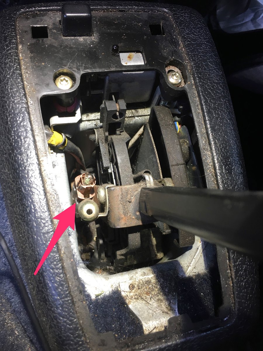

Thank you - Looking at the Bentley's image, I'm supposed to have a 'retaining screw'. As it is now, its just free floating. In your image, it looks like maybe that is the top piece? is where the screw goes? And the bulb goes in the top piece?

In the shifter assembly diagram, the only screw related to the light is the Six Point Socket Screw that hold the top cap in place. I can see it in your picture. Push the light in the top piece and you should be done.

Aaaah - bingo! Thank you - that's the image I needed.
