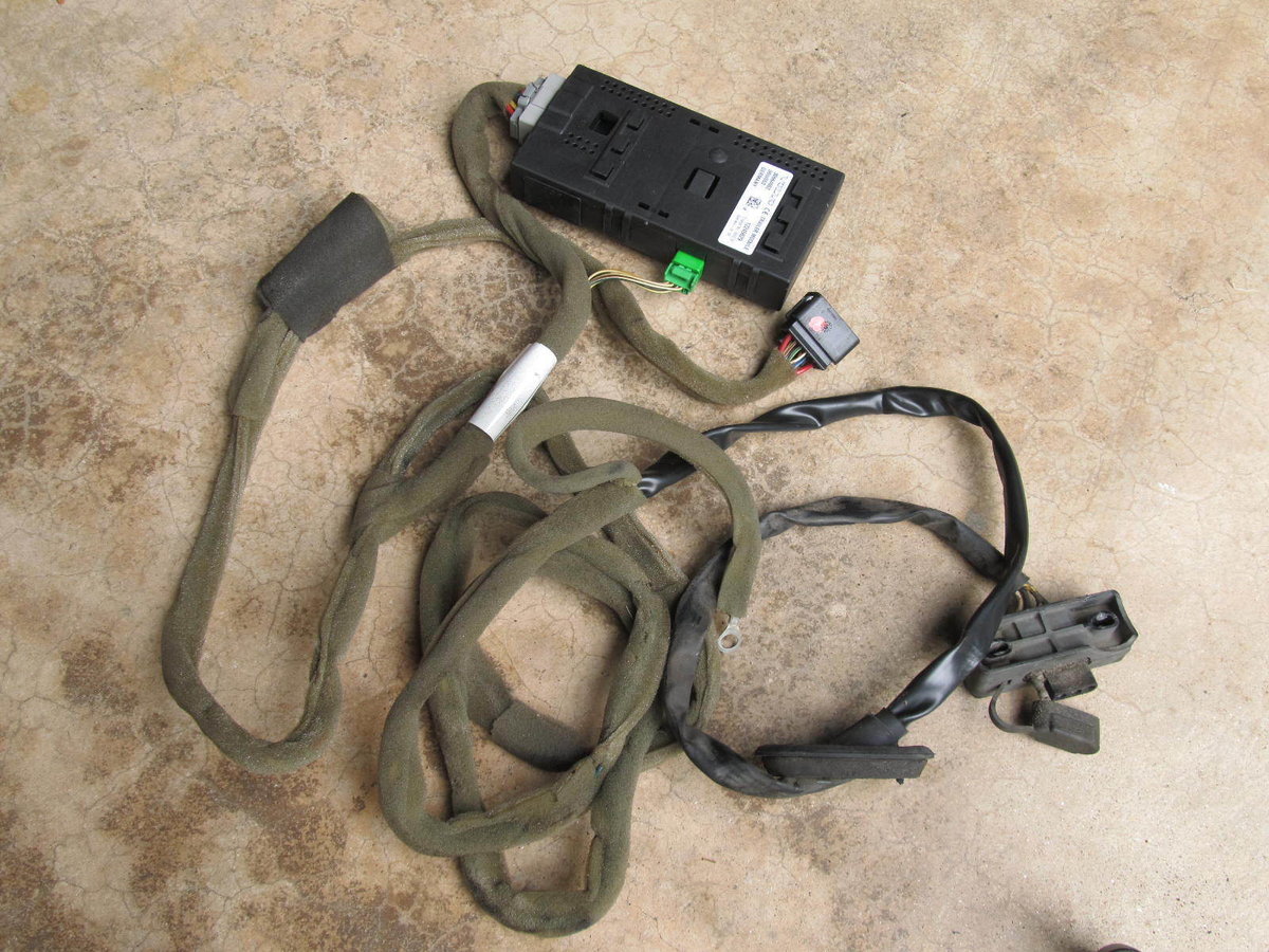

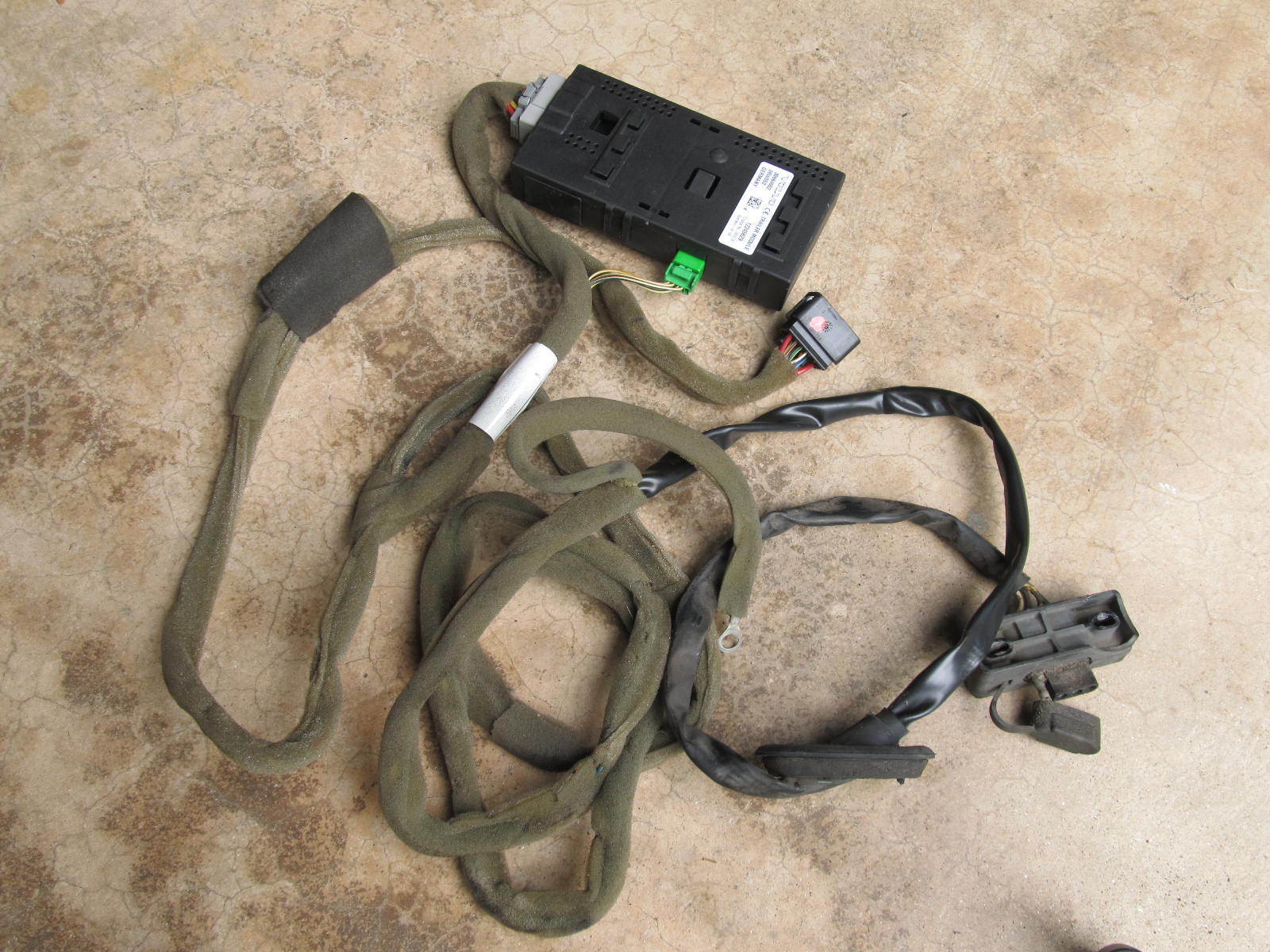

This is the P2 trailer wiring harness and module. It plugs into a receptacle located on the rear cargo area fuse box.
Actually, now that I think about this a bit more... This harness is for 2005+ V70. I rummaged around in my parts bin and found a 4 wire trailer harness for earlier P2s someone improvised using a 3rd party lighting module. They tapped into the wiring of the "red" connector shown in the OP's photo. So presumably the red connector is for a trailer harness.

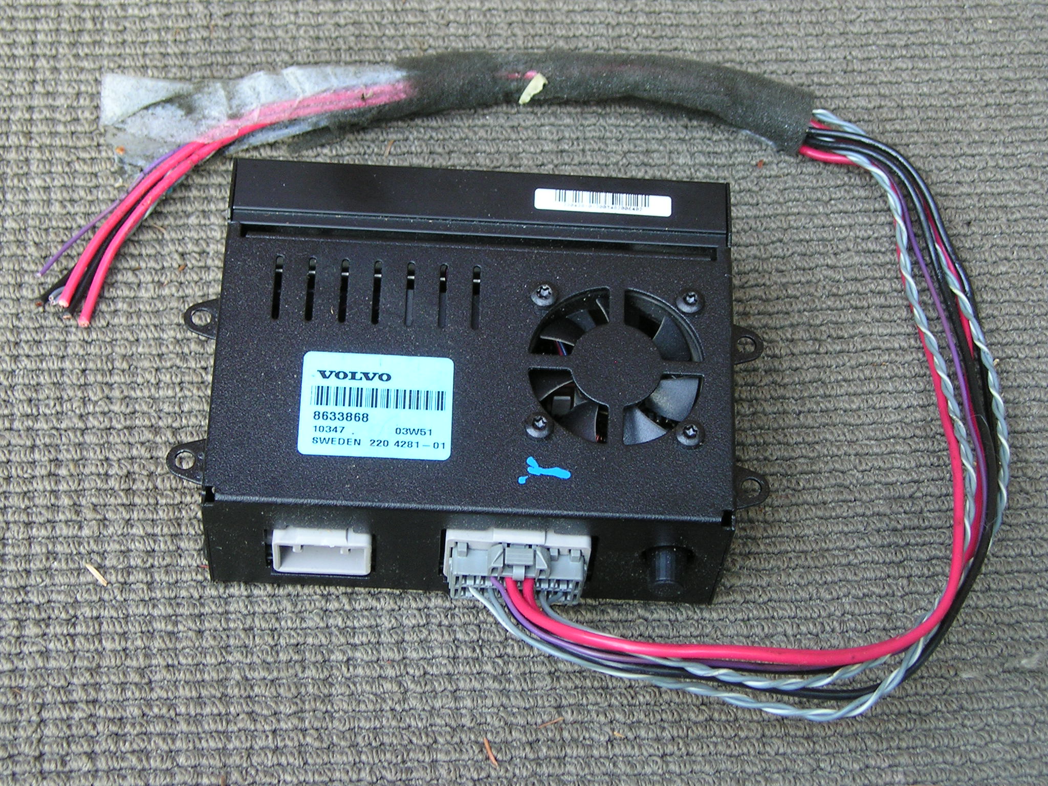

This is the P2 sub-woofer harness (well part of it anyway) and sub-woofer amp. It is my understanding that very few P2s are pre-wired for the sub woofer.
