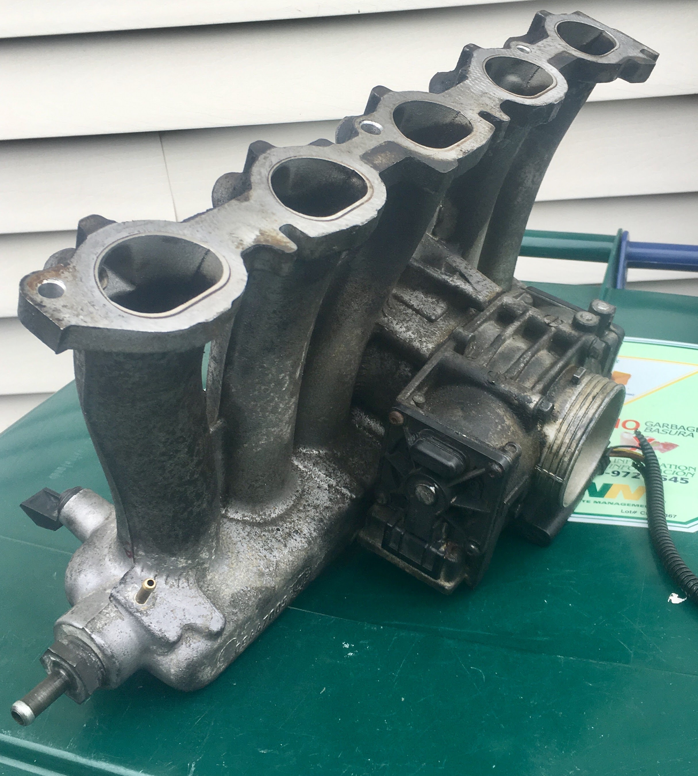

That's the newer-style, more compact throttle body. In '01-'02 the 2.4T had a larger throttle body that is likely more difficult to maneuver. You can see one here attached to the intake manifold of my '01 V70 2.4T:cn90 wrote: 15 Aug 2018, 19:19 Cleaning the Throttle Body in the 2.5T engine is, in fact, VERY SIMPLE.
No need to remove Intake Manifold etc. etc.
All you need is to read this DIY I wrote a while back.
And it is FREE (other than the cost of the Brake Cleaner etc.).
DIY: 2005 XC90 2.5T Throttle Body Cleaning
viewtopic.php?t=78629
I had to remove the fan shroud to get mine out.
