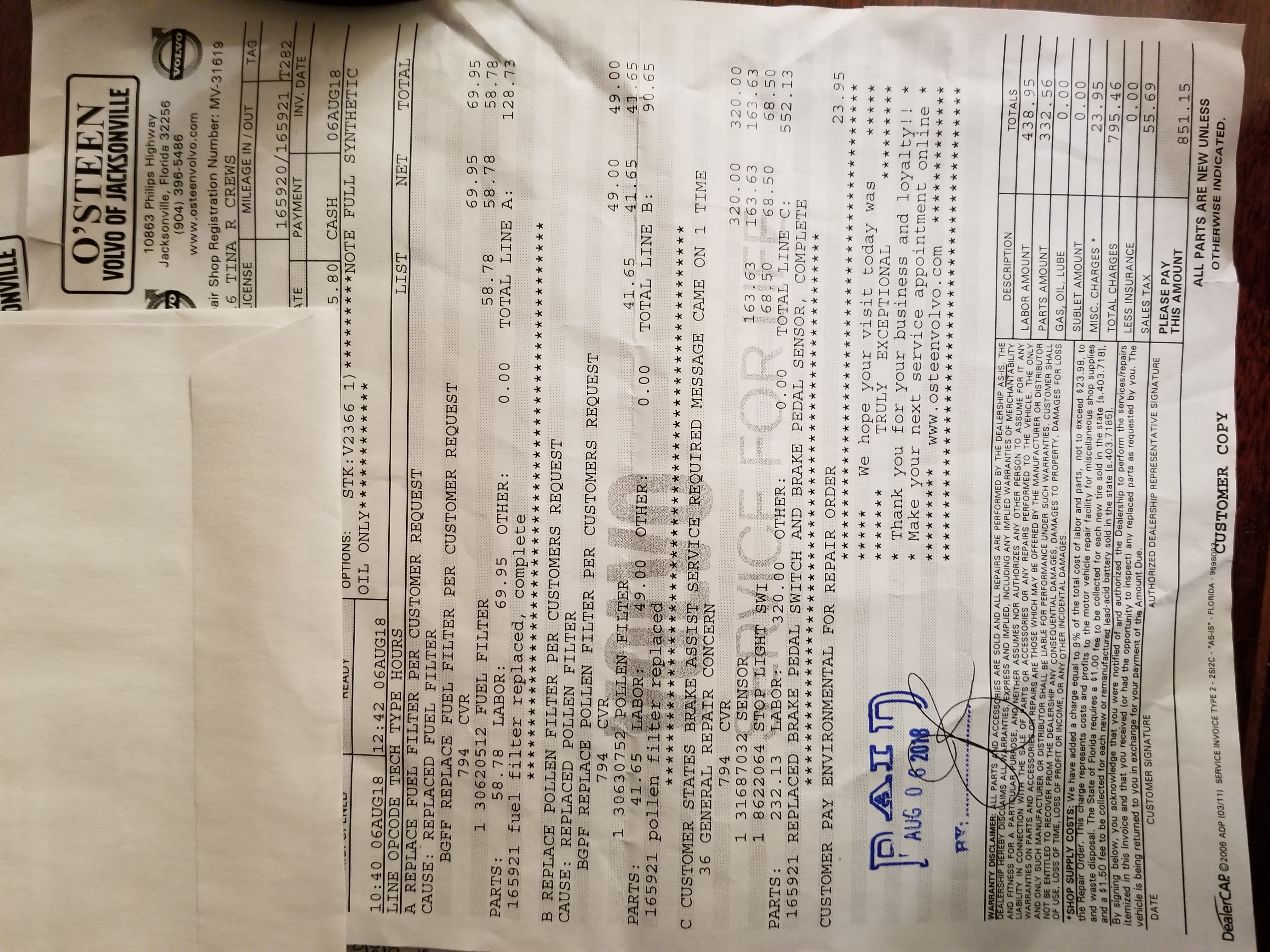

My 2004 S80 T6 which Is a cousin to your car had the same brake assist message. It only came on once then never came back but Volvo was able to pull the code and repair my car. It ended up being a brake pedal Switch And a sensor or switch under The hood on the Brake booster. I'll find my repair ticket from Volvo and add a copy later. June

Here is my ticket, notice it was just a couple weeks ago. It's line C and cost me $552.13 for the repair. I figure the part numbers will help you identify what they replaced. June

I thank you again for the information. I replaced the switch and sensor, as you did, and NO WARNING now. Very much appreciate your information. You save me a lot of headache and work.
