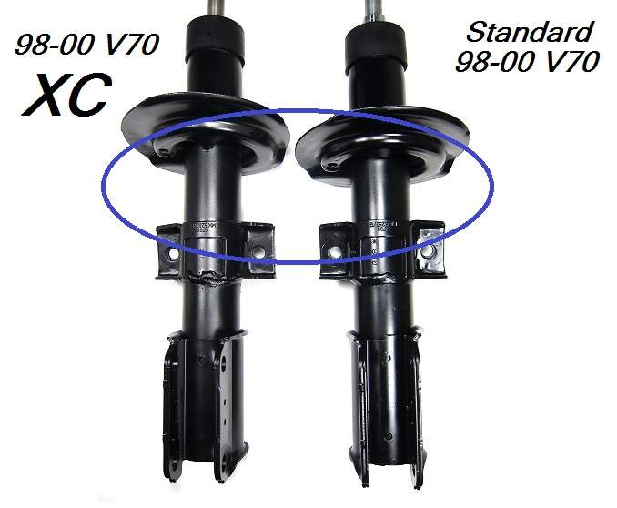

The P80 front ride height is strictly determined by two things:
(1) the spring stiffness
(2) the location of the spring perch on the strut, how far it is placed from the strut to knuckle fastener holes.
Nothing else comes into play, for example the stiffness of the strut is irrelevant. All that matters is where that perch sites and how compressible that spring is under the weight of the car.
So you could measure the distance from the spring perch to the strut to knuckle top hole, and compare it with the distance on your old struts. If it's the same then the issue is the springs, if the new ones measure longer (seems likely from the thread) then they are XC strut assemblies.

BTW for $50, I would keep them just for the complete set of "Volvo branded top side hardware." Maybe you can sell the struts for $20 bucks each in the for sale forum, but if not you still have a great deal on the hardware.
I searched for pics on a whim and actually found this (http://store.voluparts.com/98-00-volvo- ... nt-struts/), makes it clear as a bell:
early-v70-xc70-strut-comparison

Erik: thanks for the pic. Clearly shows the perch height differences. Good suggestion on the hardware.

The perch height difference in Erik's pics is pretty distinctive. When I pull the XC struts I'll place them next to the correctly spec'd units they replaced, just to put a tape measure on the difference. I'm wondering if the XC springs are the same as other P80's, and it's just the strut perch that's pushing up the height—or if the XC springs are actually stiffer.
Though I don't relish disassembling 4 strut-spring assemblies and putting 2 back together, might it still be possible to use the XC struts with the 850 springs if the 850 springs are softer? Thoughts?

Spring lengths are usually the same, it is just the stiffness that will make a difference to how the car rides. The higher spring perch will always be higher.
If you can see a part number on the strut then we might be able to confirm what you have.
