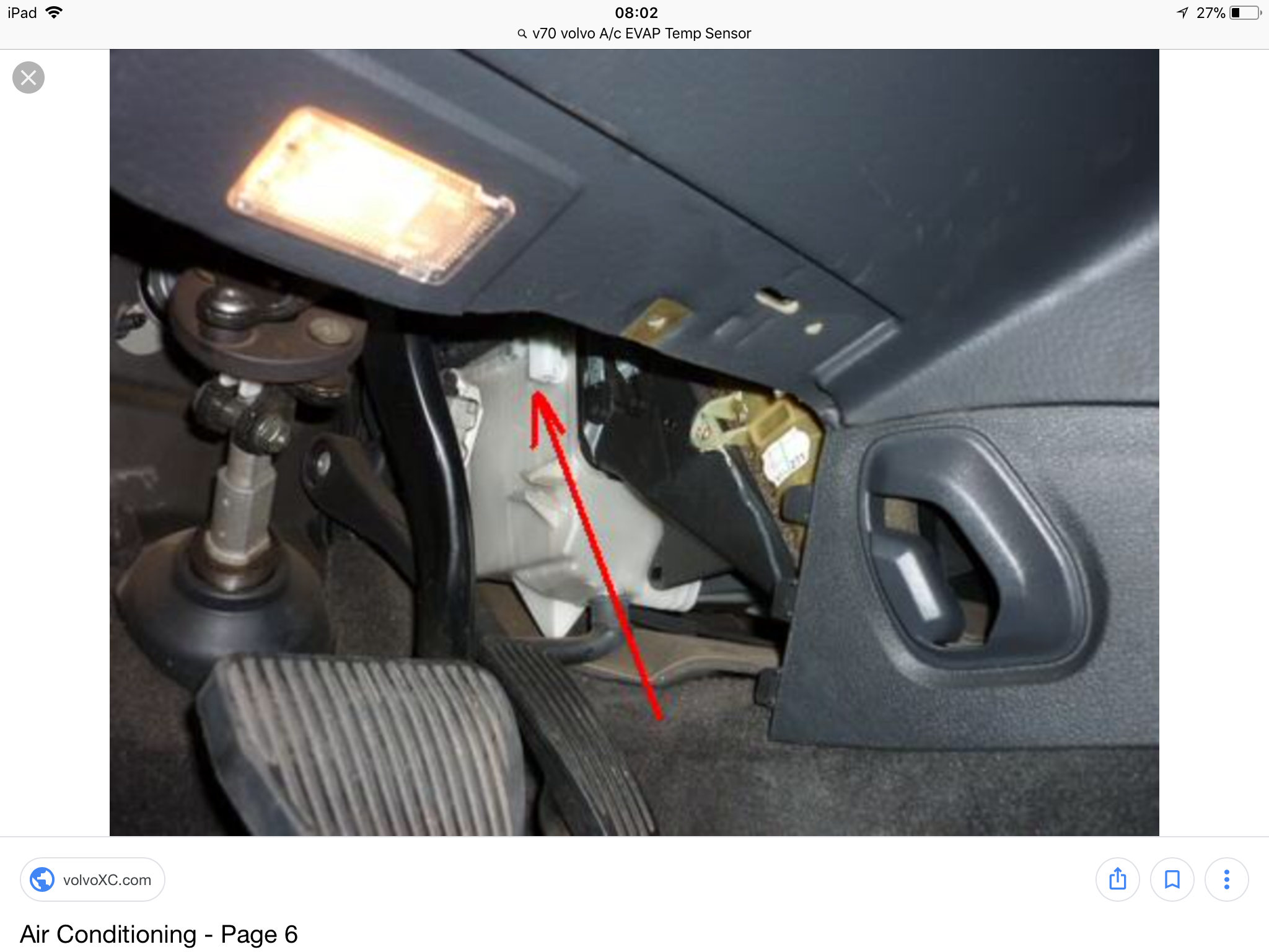

There is a A/C EVAP Temp Sensor located on driver side up underneath the center console above the accelerator, refer to pictures.
Take the wires of first than turn the probe about a 1/4 turn to get it out of the console.

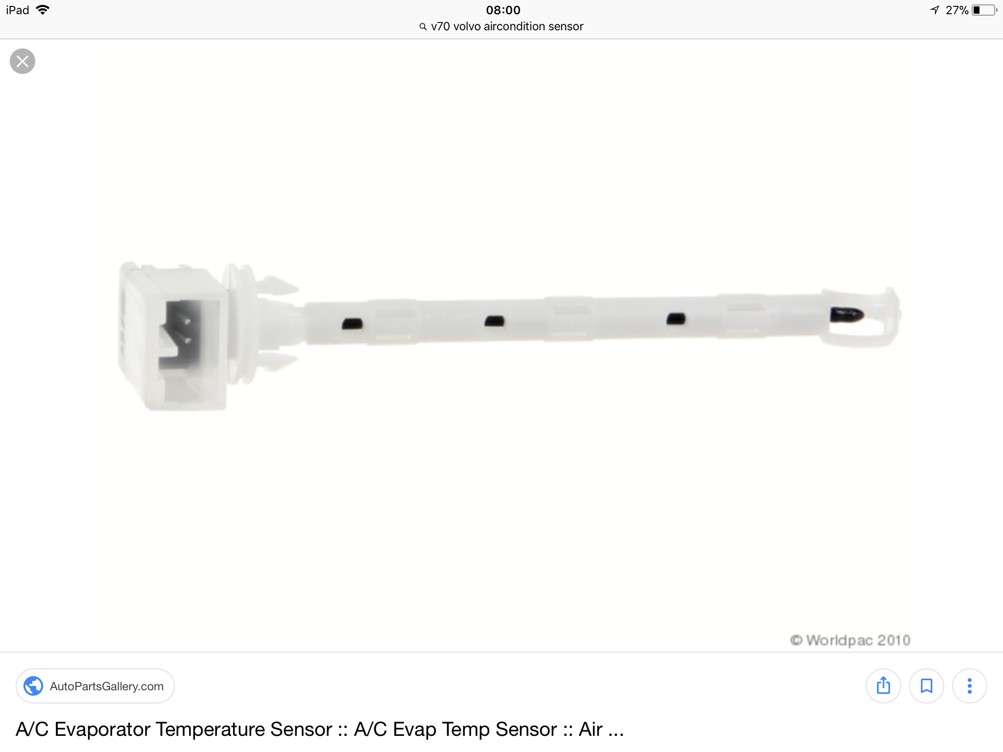

This part is 35$ on amazon and it took 5 minutes to change. (I went to the a wreck yard and found a similar model and got the part for 2$ and it is still working great after a year)

When this happens, the a/c lines inside the engine bay will also freeze up literally covered with ice despite the engine bay temperature. This because when the sensor fails the compressor clutch runs without any pause so it cools down the refrigerant way too much.
If pulling a sensor from the jukyard try to find the ones with a black tip - the blue tip were the early ones that are more fragile.
While there, on our LHD cars it's as mentioned a 2min job just pull the sensor and unplug it (pull it first, don't try to unplug it when it's sitting in there). On UK, Australian and other RHD cars, it's a dash out job!! Yep. Unless like someone did, one just cuts the wires, drill a new hole and place the replacement sensor into that new hole and wires it.
