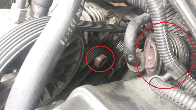

This V70 owner had quite a surprise. He mentioned the alternator clutch pulley was chirping now for a while, he was actually driving to the garage to have it replaced, when, 500m away from the garage, this happened. The pulley broke loose, jumped from there, while the serpentine belt wrapped around the now exposed alternator shaft. I mean, what are the odds the belt would stay there like this?
Worth mentioning that this is a D5 diesel engine (sold elsewhere in the world) which is notorious for bending valves when the serpentine belt fails in one way or another.
What are the odds?

- aa.jpg (61.68 KiB) Viewed 1123 times

Odds are very good. It happens all the times to all sorts of cars. Not unheard of with Volvos, a number of posts can be found where it took out the top end. A friend is working on a 2008 BMW which had a similar issue, the belt literally got sucked into the engine by the rotation. Motor is shot.

The chance of the engine getting shot is about 99%. But that..SuperHerman wrote: 01 Sep 2018, 10:30 Odds are very good. It happens all the times to all sorts of cars. Not unheard of with Volvos, a number of posts can be found where it took out the top end. A friend is working on a 2008 BMW which had a similar issue, the belt literally got sucked into the engine by the rotation. Motor is shot.

BMW 6 cylinders and others with timing chains have serpentine belts get into timing case. I've seen it on BMW more than others and there doesn't seem to be any difference in crank pulley or belt drive to make them look more vulnerable.
The bad part is EPDM rubber lasts so long that it outlives the fiber in belt and makes any visual inspection impossible. It is very much like a tire that gets belt separation and gets squirmy tread or a bubble in tread when the tread has lots of life left.
