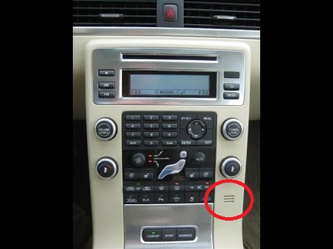

Also blow some air here or put the vacuum on it, it's the cabin temp sensor and may get covered with dust & stuff - don't touch it physically

drewmeister2
- Posts: 26
- Joined: 05 Jul 2018, 14:47
- Year and Model: 2009 S80
- Location: Virginia
Yes, I've done that too, and it didn't help.
